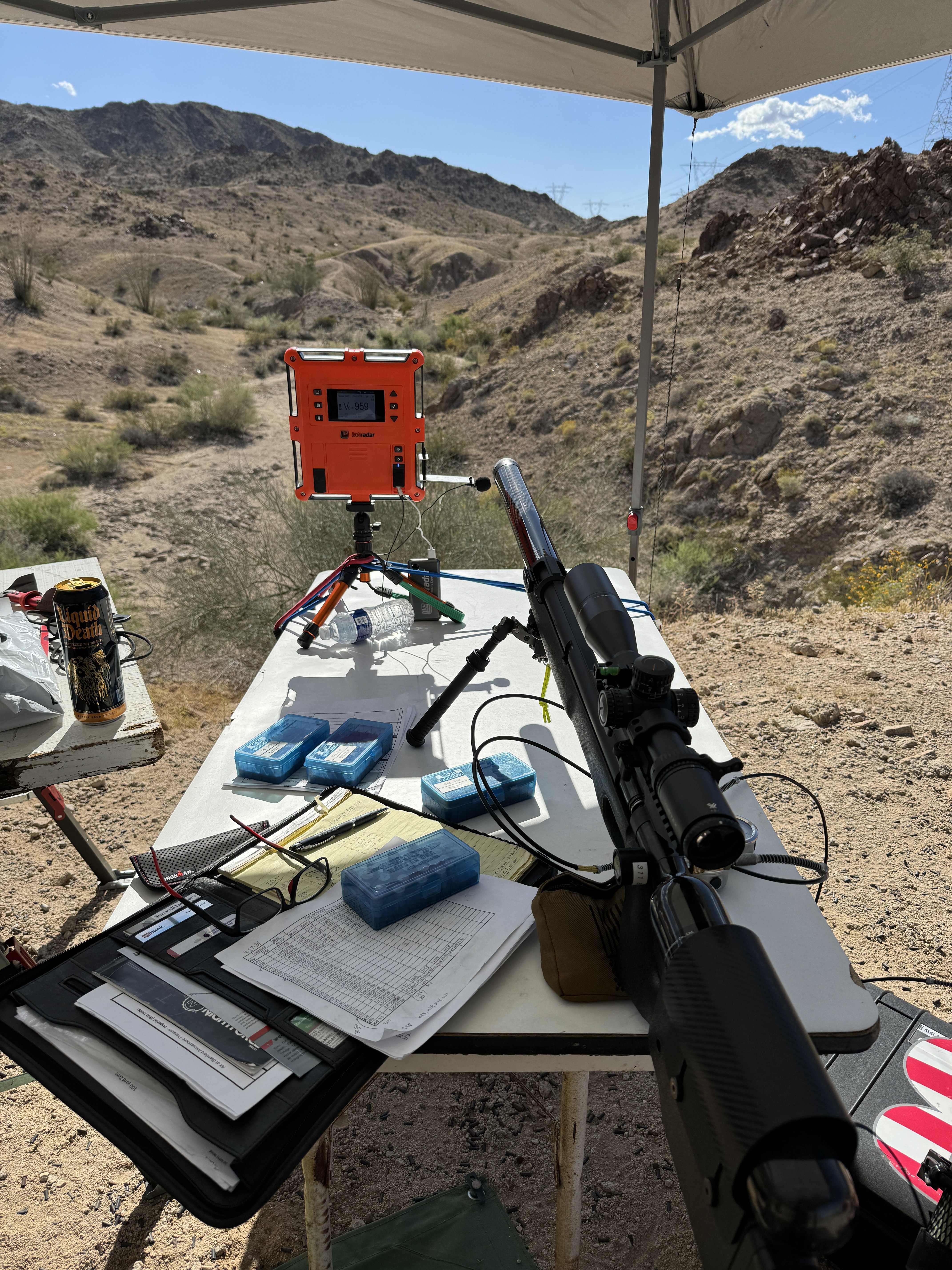

Food for thought regarding the .510. I'm Shooting Mr. HP 385gr micro HP slugs and my Texan .510 will consistently put lead on 8" steel at 400 yards. My personal goal has been to get 10 out of 10 on steel, but my best to date is 8 out of 10. It is important to note that I'm talking about a tethered rifle, and I'll mention that my buddy Albert has gotten ten out of ten on 8" steel with his FX Impact M3/.357. Albert beats me every time we shoot out to 400, my only revenge is on the 600 where he cannot touch steel.
