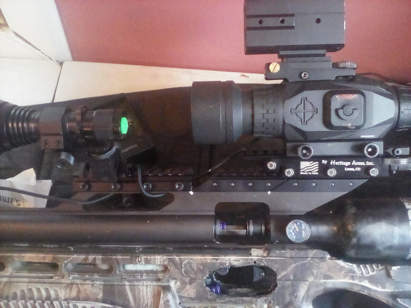

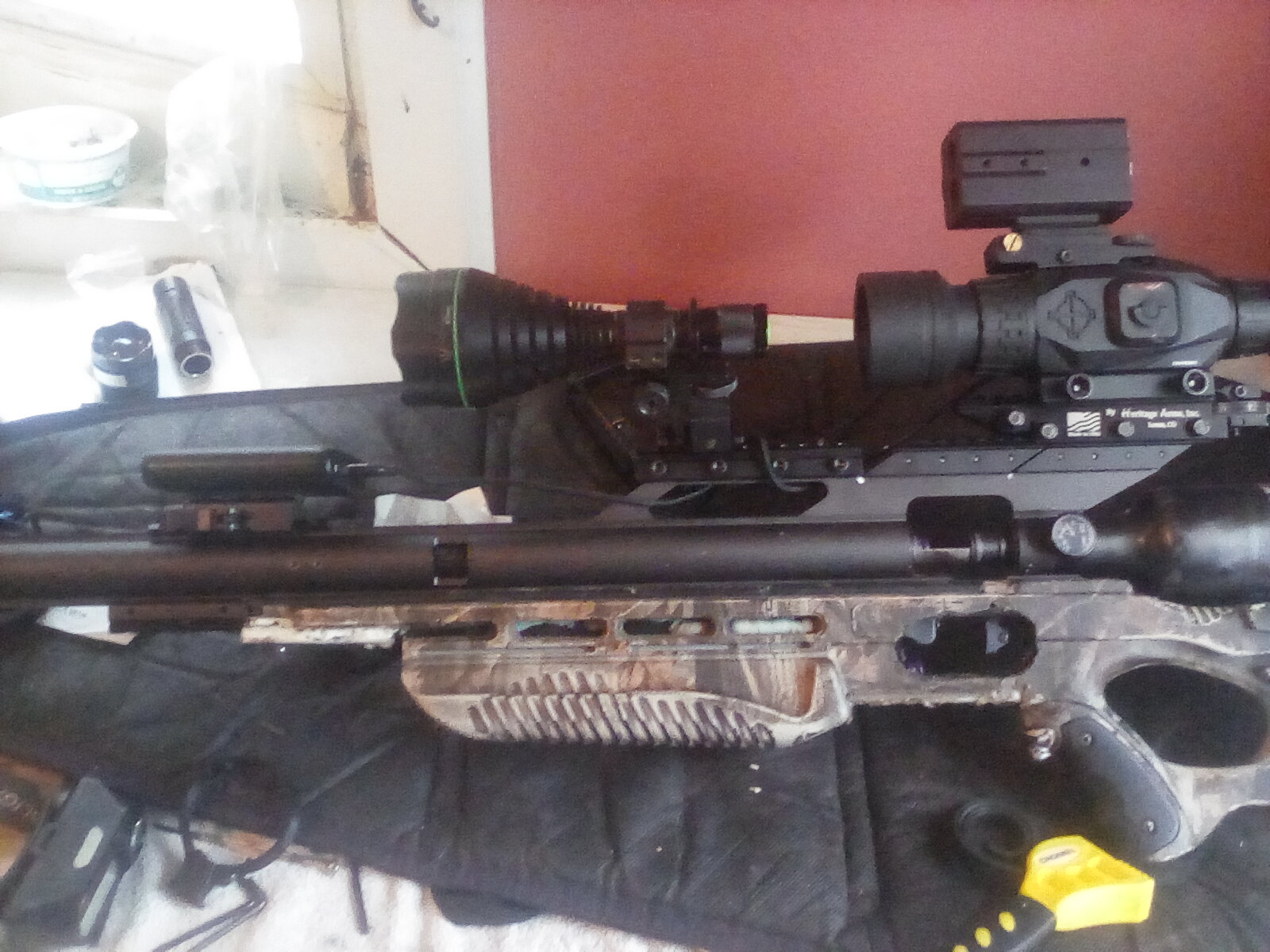

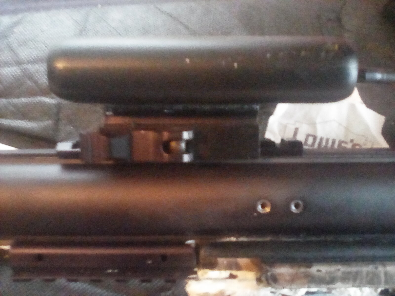

I bought something very similar to this on Amazon. It fits onto the Dovetail rail and your Picatinny fits right over it. Haven't had a single issue with them yet on my .457 Texan

Those adapter s are what I wanted to use on my Texan 50 with cold shot adjustable base. I tried them and they slid from recoil on 50. eagle vision makes that same adapter better built too. Those cheap adapter s are good for accessories and cheap. With my 50 only the Airforce Adapter s hold up with recoil. Regular dovetail or 11mm rings mounted to rail with scope would not hold either. Lower power Texans are probably more forgiving. The 50 isn't it eats up cheap scope rings and mounting accessories.
Ok this is what I'm looking for. I did find the eaglevision adapters, they look like exactly what I wanted but I wasn't sure if they ship to US. Did you try them? Did they work? I also have the .510. My scope isn't much of an issue but I desperately want to mount a sling, and given the texan sling Mounts are unavailable currently my only solution is to mount picatinny. I'll use the texan adapter if I have to but I like the eaglevision much better for the low profile and grabber screws instead of the spring loaded cheap ones

also is that a maddog stock? because I like it
