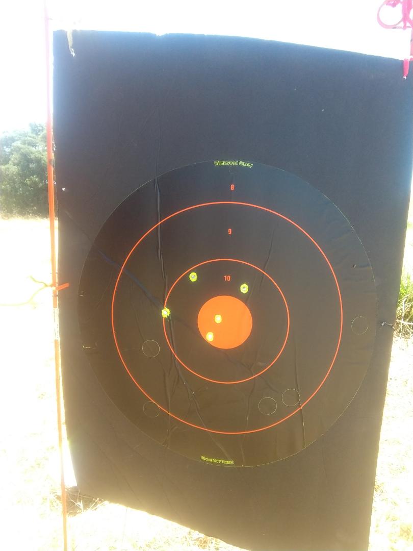

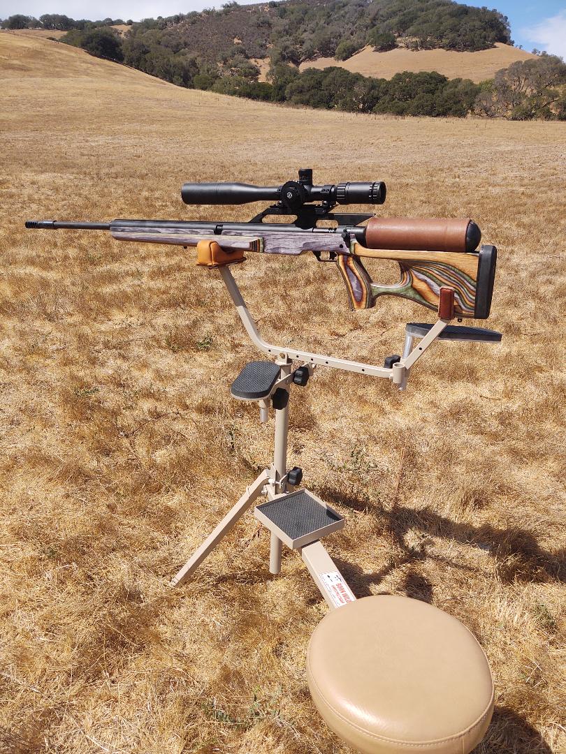

I shoot 95% time at my home range of 125 yards. usually get pretty average groups of 1-3 moa at 125 yards. I have shot out to 300 with decent results. My Texan just really came together..I made a custom stock, full.1inch carbon sleeve on barrel running to the brushings and finally got the balls to fix my barrel....3 hrs of hand lapping with a lead lap. I have the cold shot Moab mil adjustable base so i.can shoot some lead.to the moon😀. Last year on crutches from surgery. Cut in long range target shooting. This year should be much better... Barrel actually kinda consistent now. Ill.post some videos soon of Possum at 100 and skunk at 160... Its hard to hit little critters past 150😁
I’m glad ya got it squared away. Maybe there is some hope for mine.

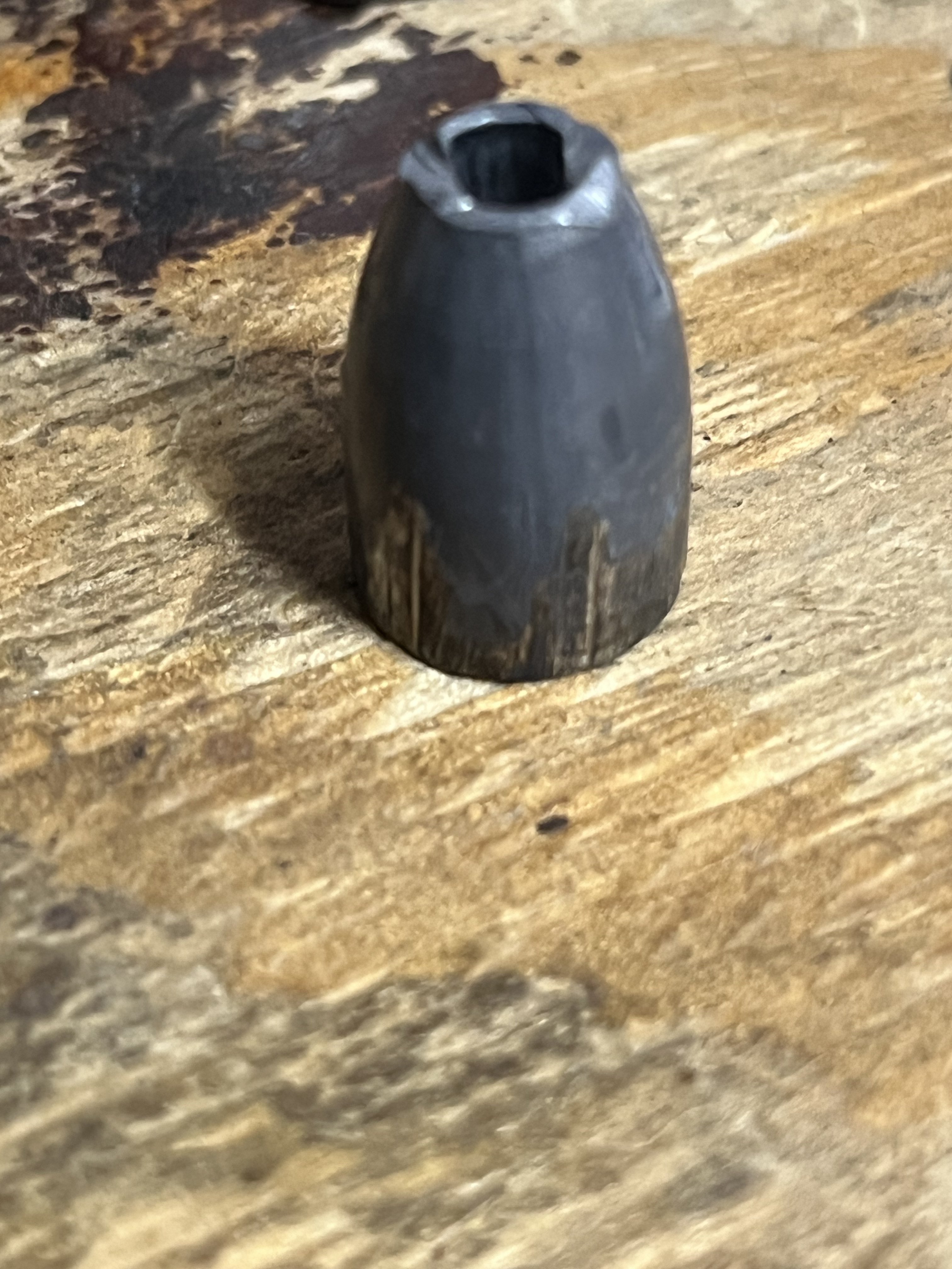

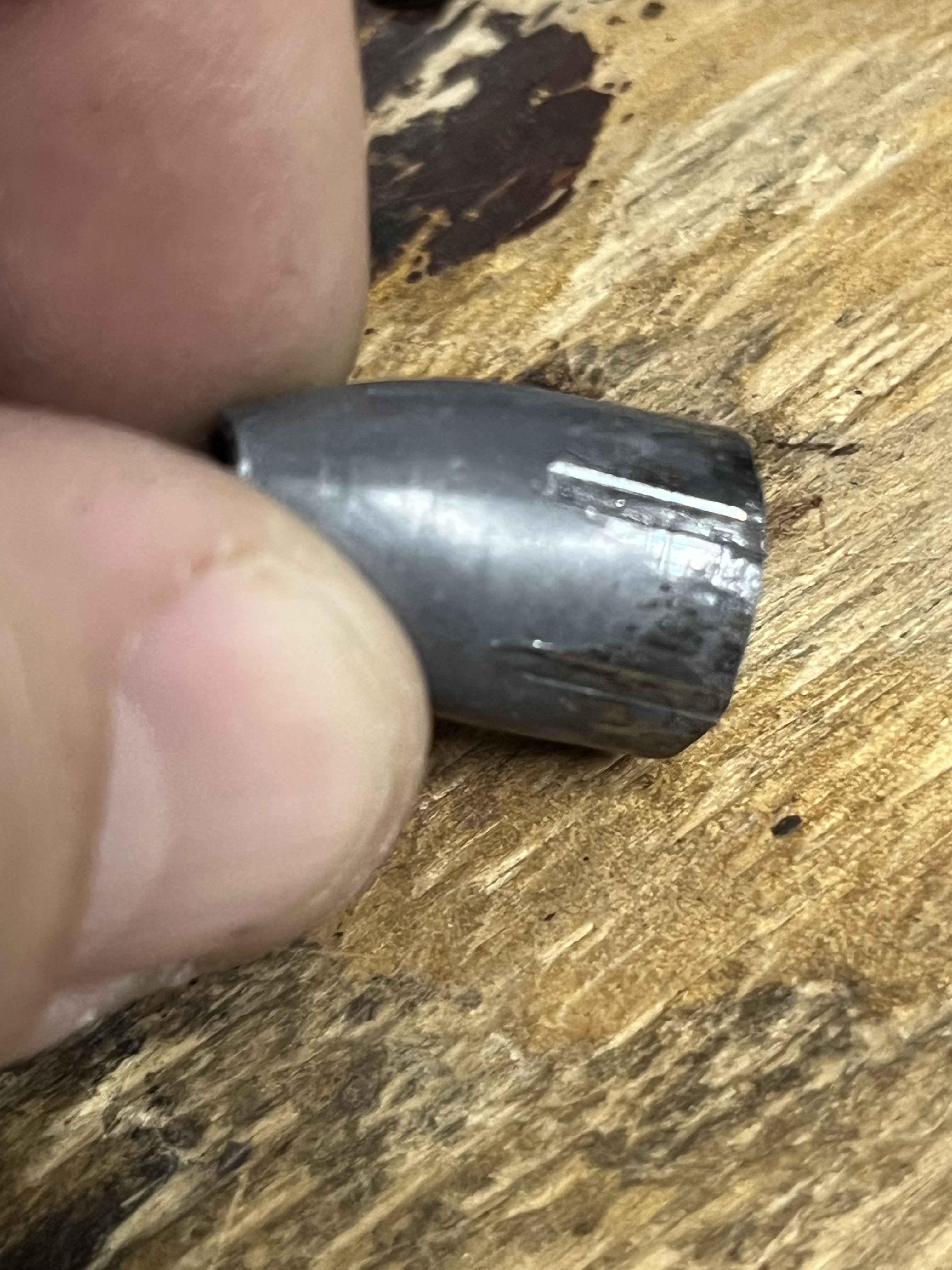

I attached a picture that I have attached countless times to other posts about the woes of barrel fouling. This is what happens when you shoot a Texan out-of-the-box with no lube. I'm embarrassed that I didn't notice it sooner, but I was a newbie and just didn't know. If I can save others the agony by sharing this, great. Talk about accuracy issues? I couldn't hit a target at 25 yards. Needless to say, it was quite a project to restore my barrel and it's a miracle that it shoots as good as it does now after the cleaning it took to unclog it. And the results from all of that range time, casting, bullet sizing, etc. is on the target. the targets are 200 yards and 300 yards respectively. The turkey was at 215 yards.

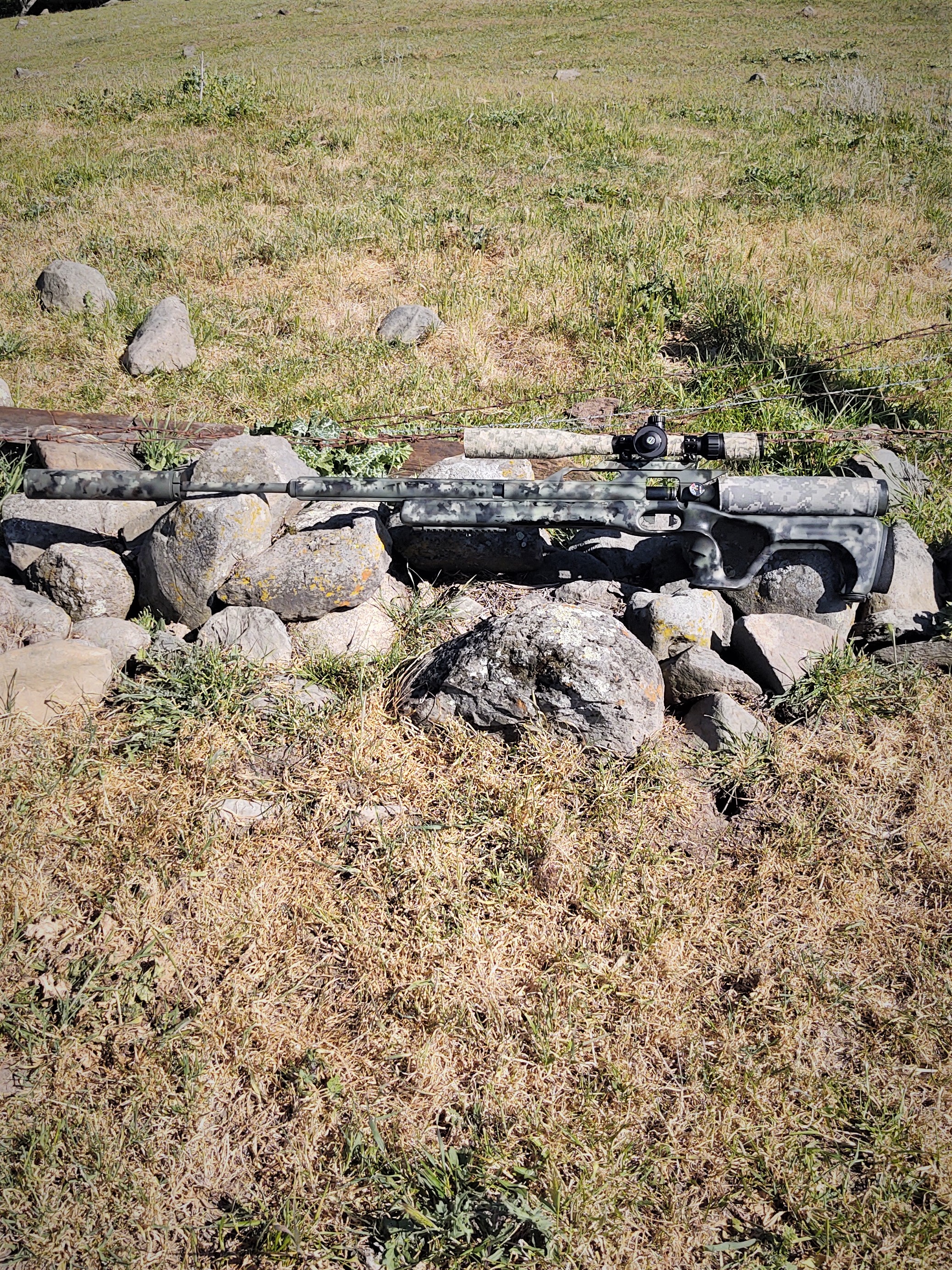

Below is a pic after I camo'd my .308 and also the .50 with the Diamond Stock.
