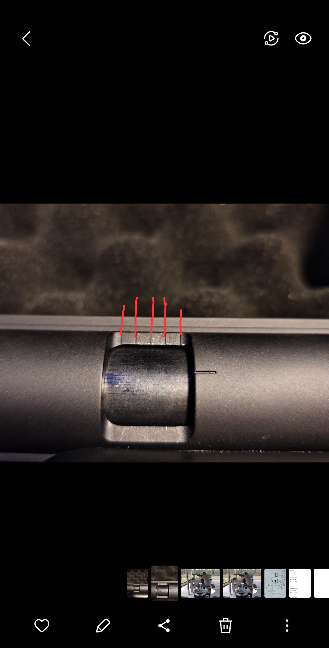

I just received my Texan CF bottle with TX2 valve and want to tune using the tuning wheel on my Texan 457. I see there are 5 marks on the barrel for the wheel. I watched a video with Ton Jones with airforce airguns saying the the max tune is only the second line. I am wondering what are the other 2 lines closer to the end of barrel for?

OK... First question; Are you aware that the action needs to be open to view the tensioner wheel. The images below are with the action closed and again with it open (see the tensioner wheel). Ignore my marks, just note that the round holes are all the way to the right/towards the chamber. This position places the maximum tension on the hammer spring. This is the place you want to start when tuning. Also, it may be necessary to crank it in like this when running max pressure in your tank. Let me know when you are ready for more info.
