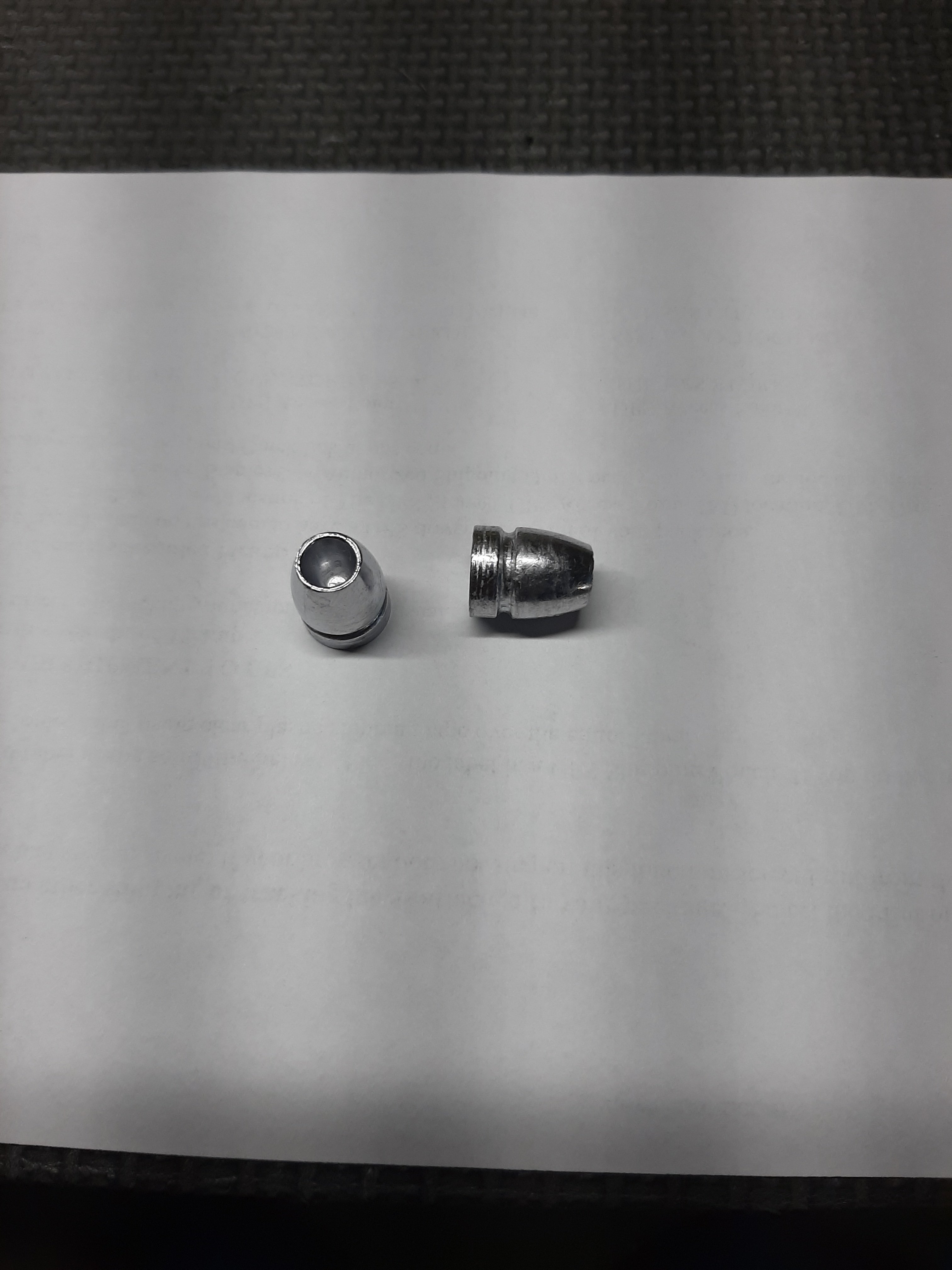

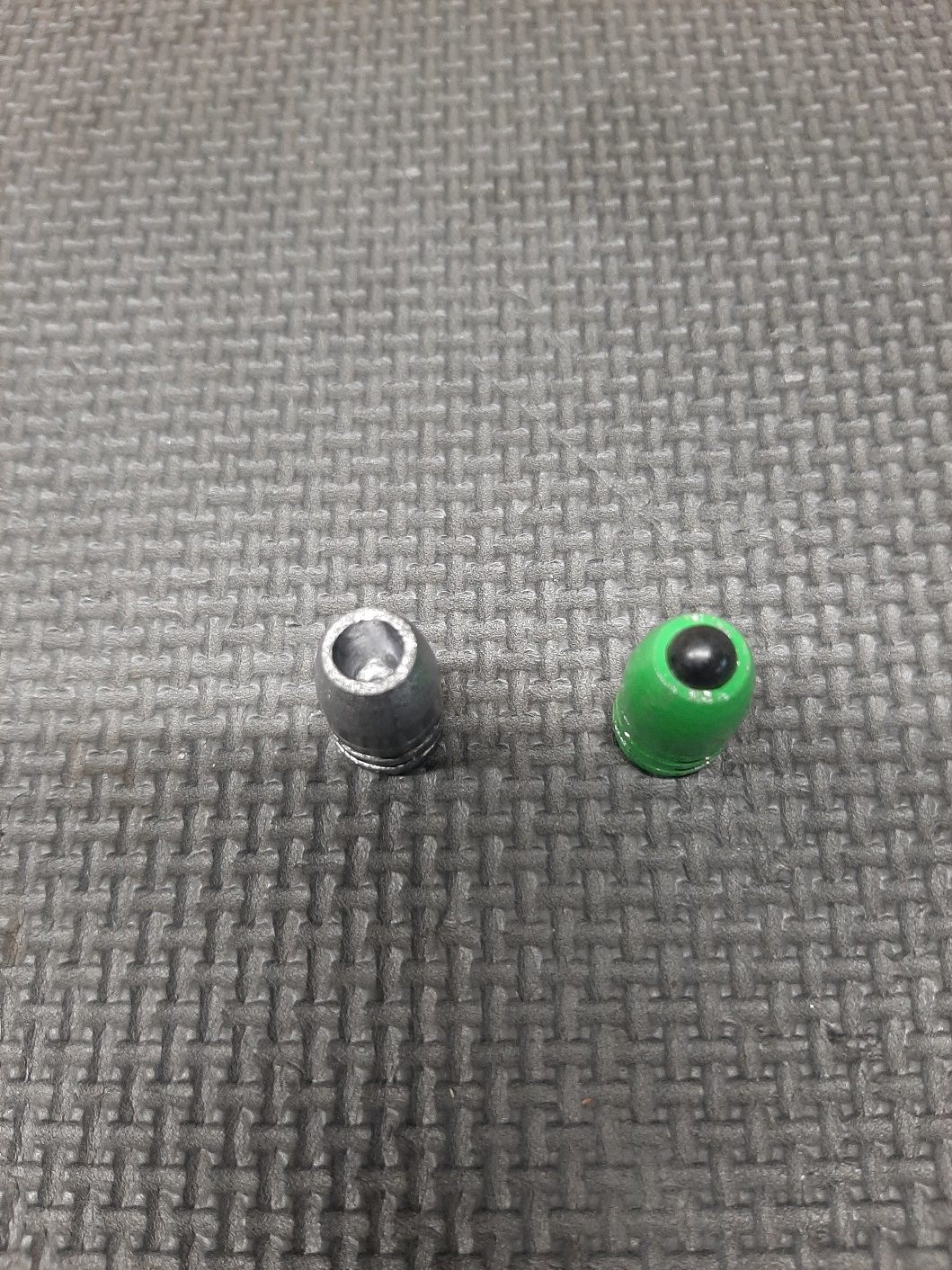

Casting is the cheapest way to go I've been casting bullets for 30 years. I have a Texan and a XP Ranger both in 45 I have a Lyman mold that drops a 180gr hp that shoots good to 75 yards, I have shot 454 diameter in the Texan with good luck and that's what the Ranger likes 454.
The 2nd pic 180gr hp, the 1st picture is a 280gr hp I cast and powder coated. For shooting paper and plinking you could also shoot muzzleloader roundballs their alot cheaper.
