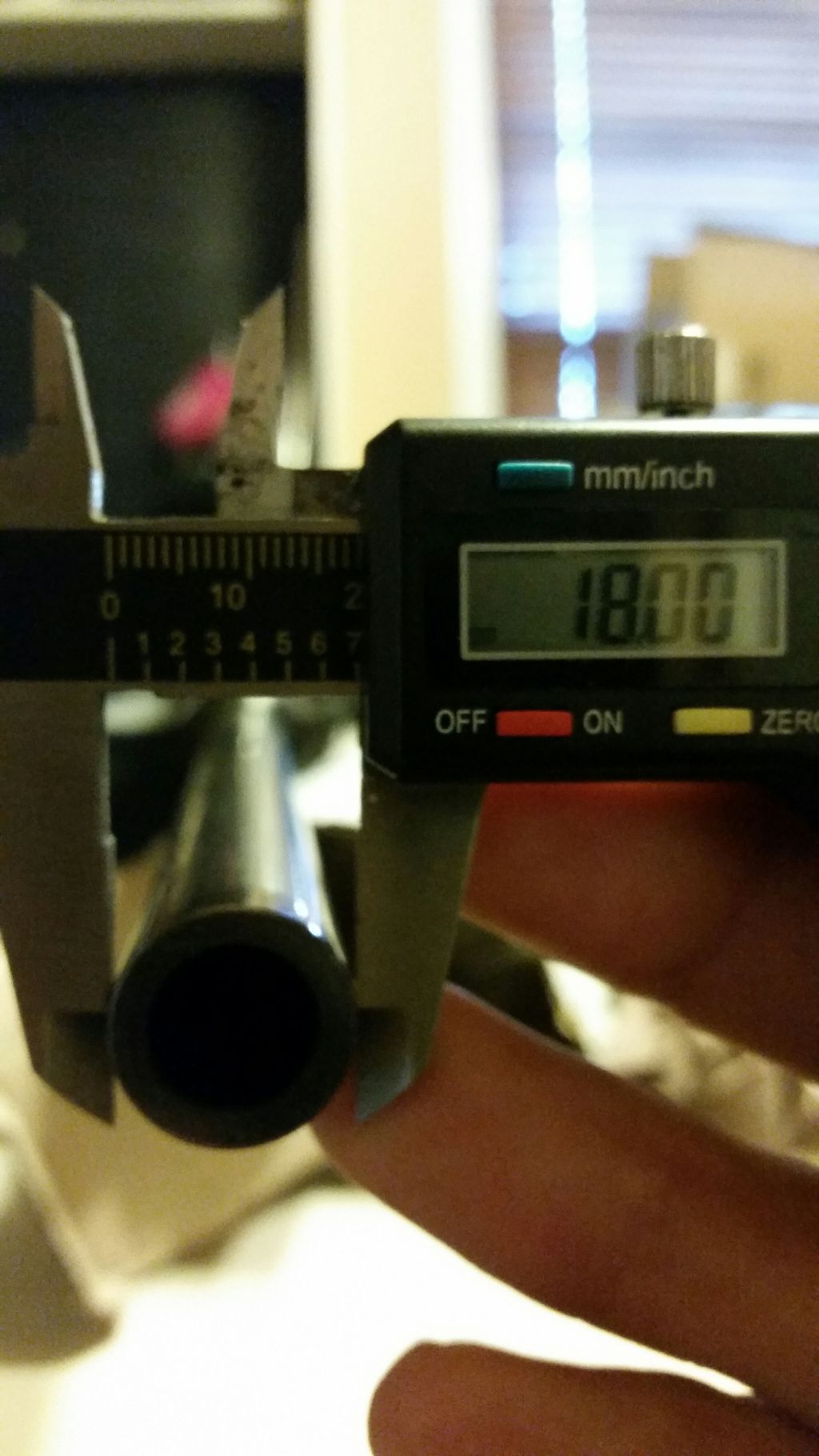

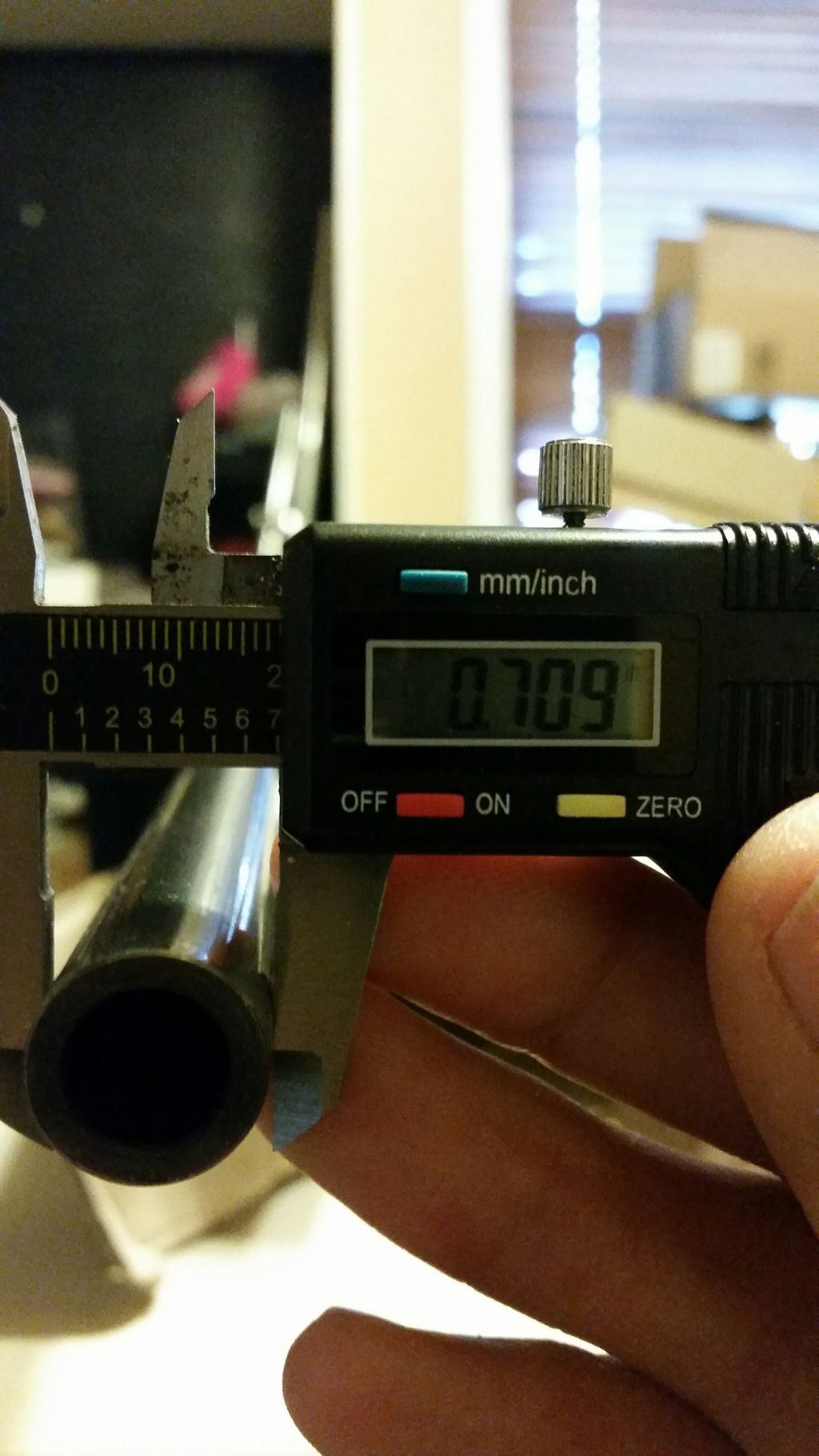

Airforce told me 18mm which is 0.709 inch. I am not sure what to go with now

According to my barrel I'd go with AirForce. And it is the same diameter all the way down the exposed barrel.
