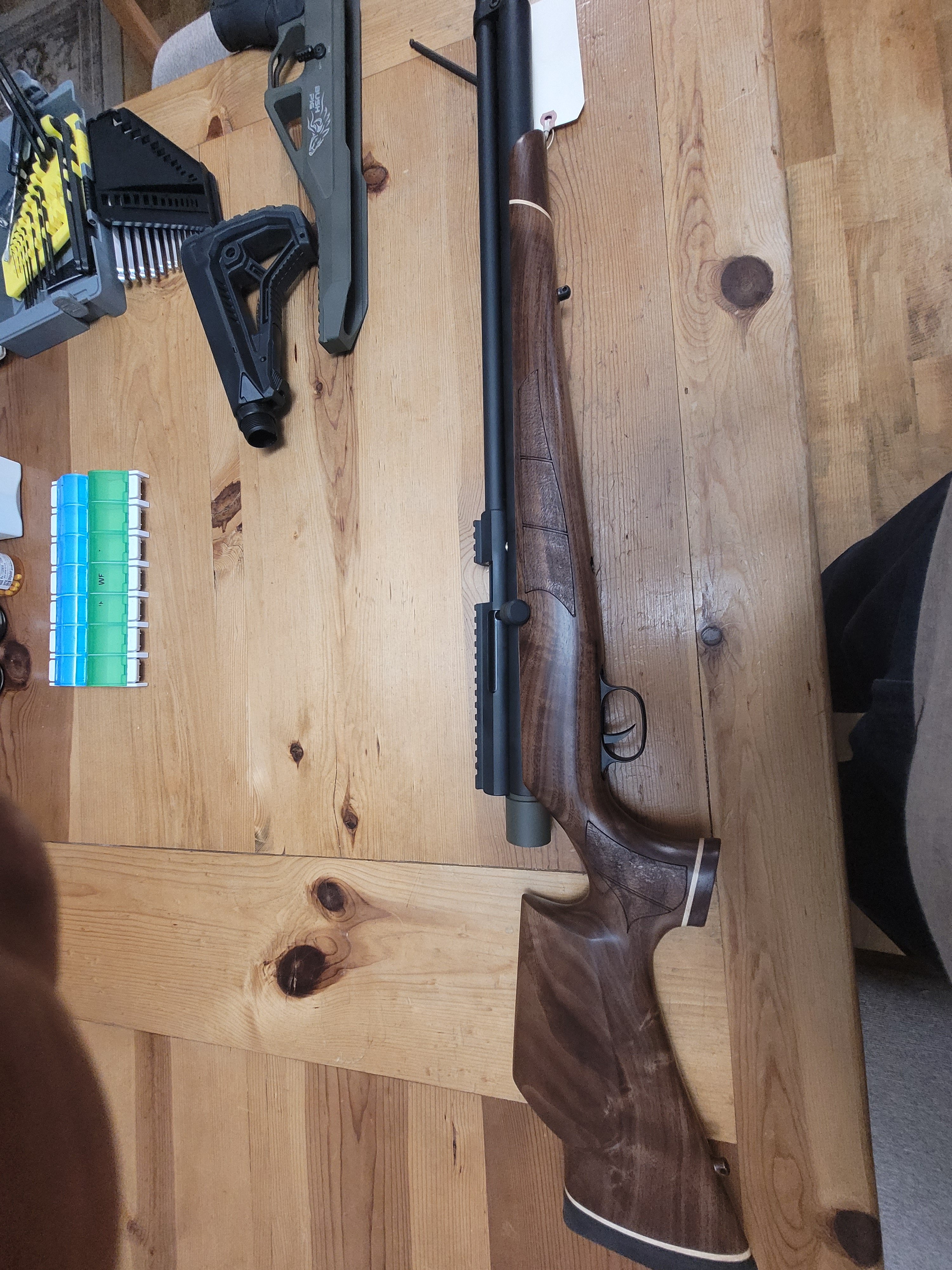

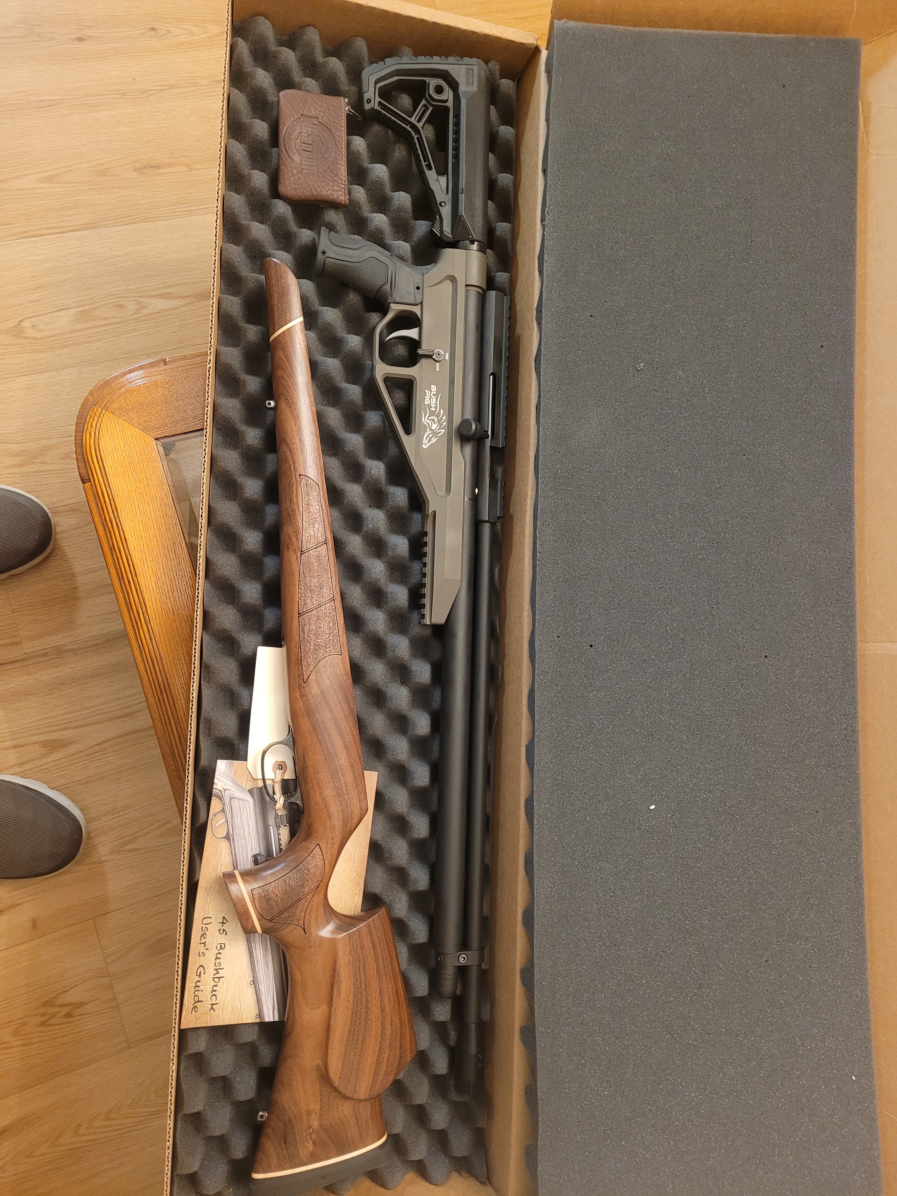

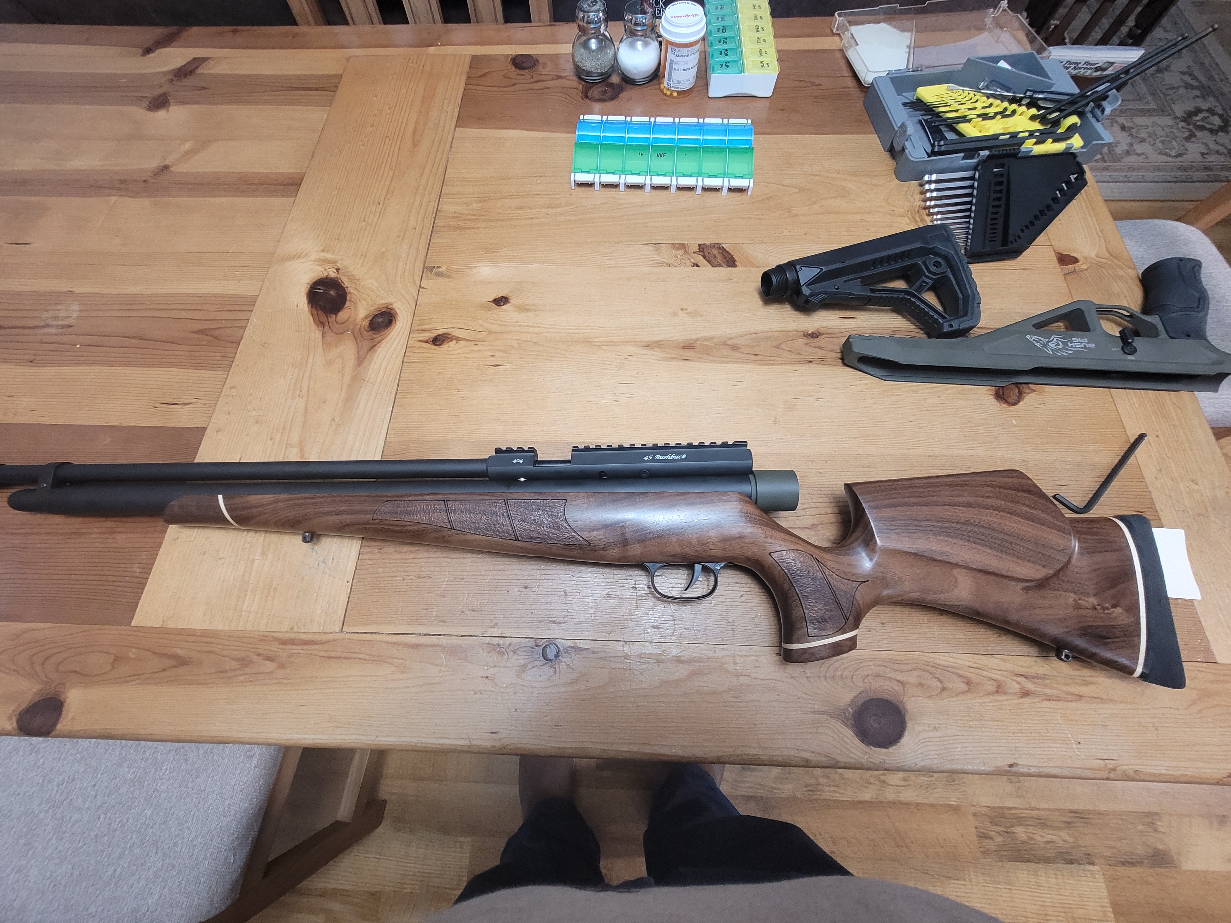

Won a bushpig at EBR then Kip Perow was kind enough to give me a Steve Corcoran stock he won! Talk about putting lipstick on a pig !!!! Have the emperor w/extension on the way as well as some nielsons slugs . hope to give my take on it this weekend .
Oooh, that timber turned out nice :)
