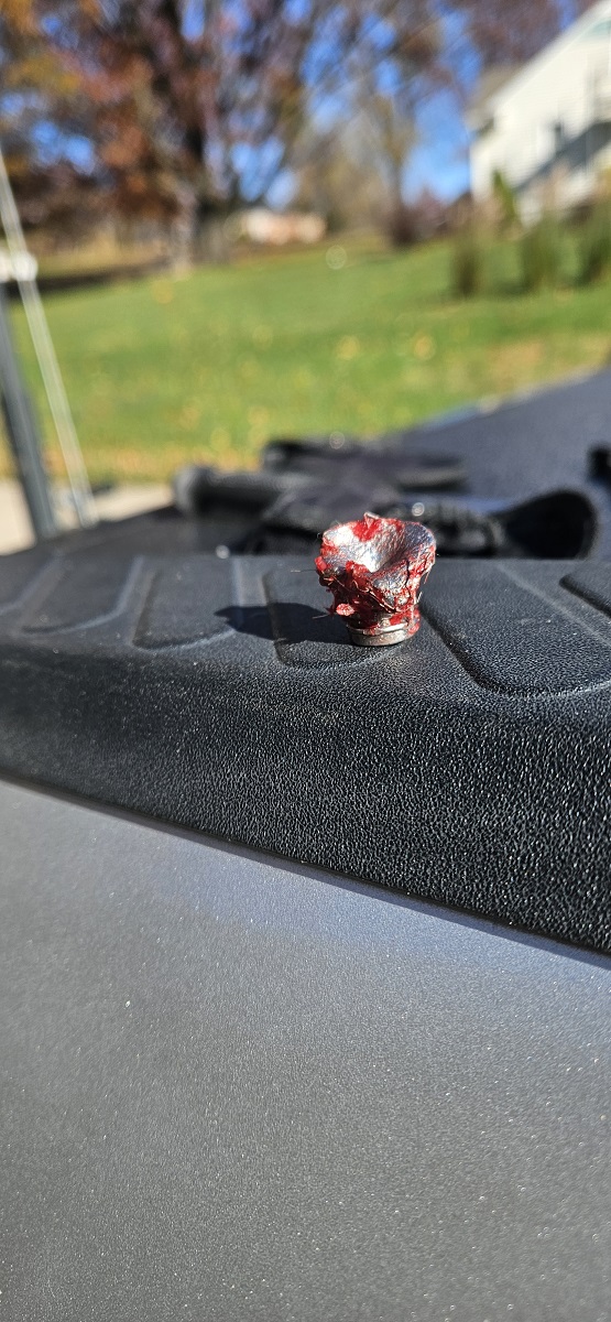

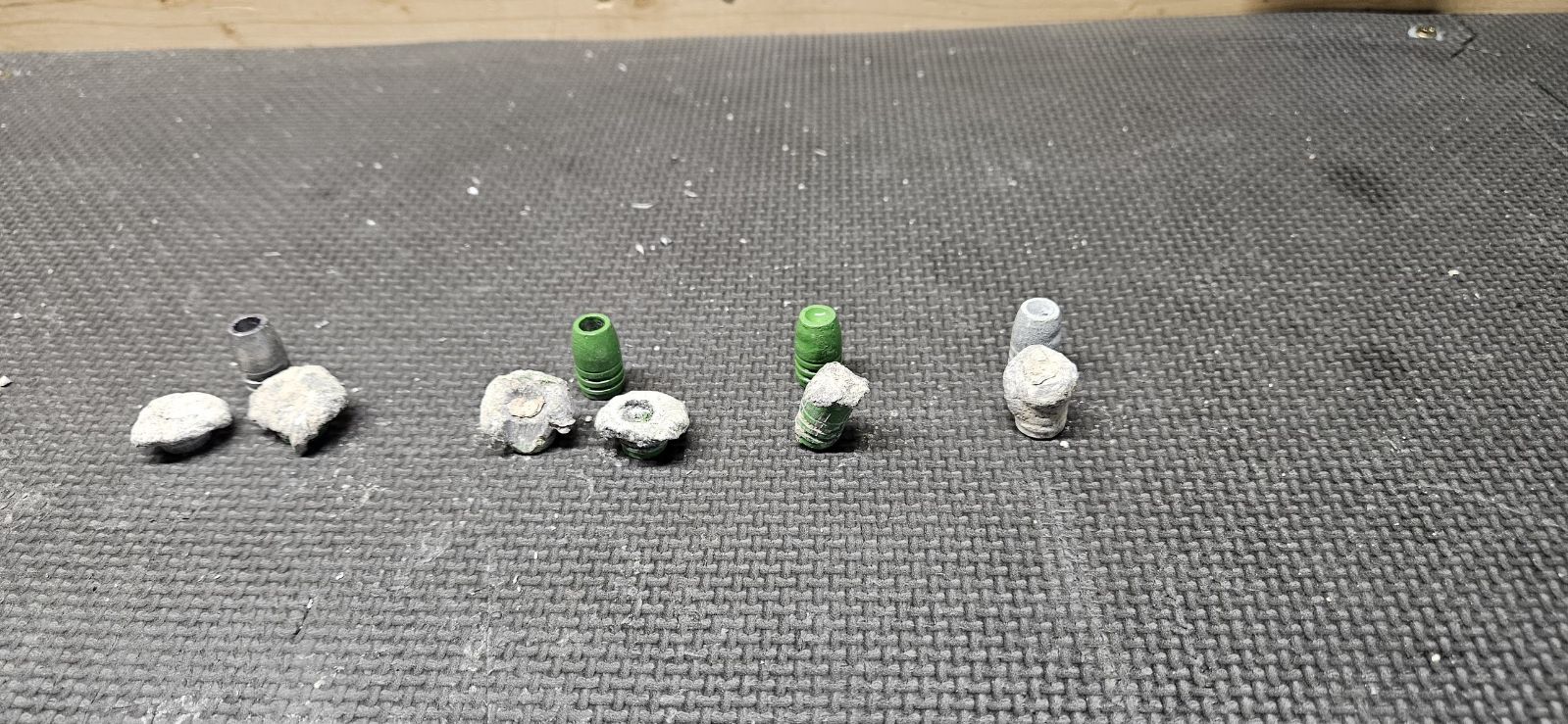

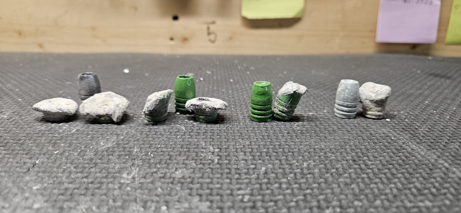

My Texan 457 loves the bullets I cast from a NOE mold 460-315-RF-AV3 sized to 458 it has pins for a flat point, deep HP and cup type HP. With the ratio of 2#s pure and 1# wheel weight the large hp drops at 280 to 286 and the cup at 315 to320 grains. Here's a 280+ from the 8 point I got last year
