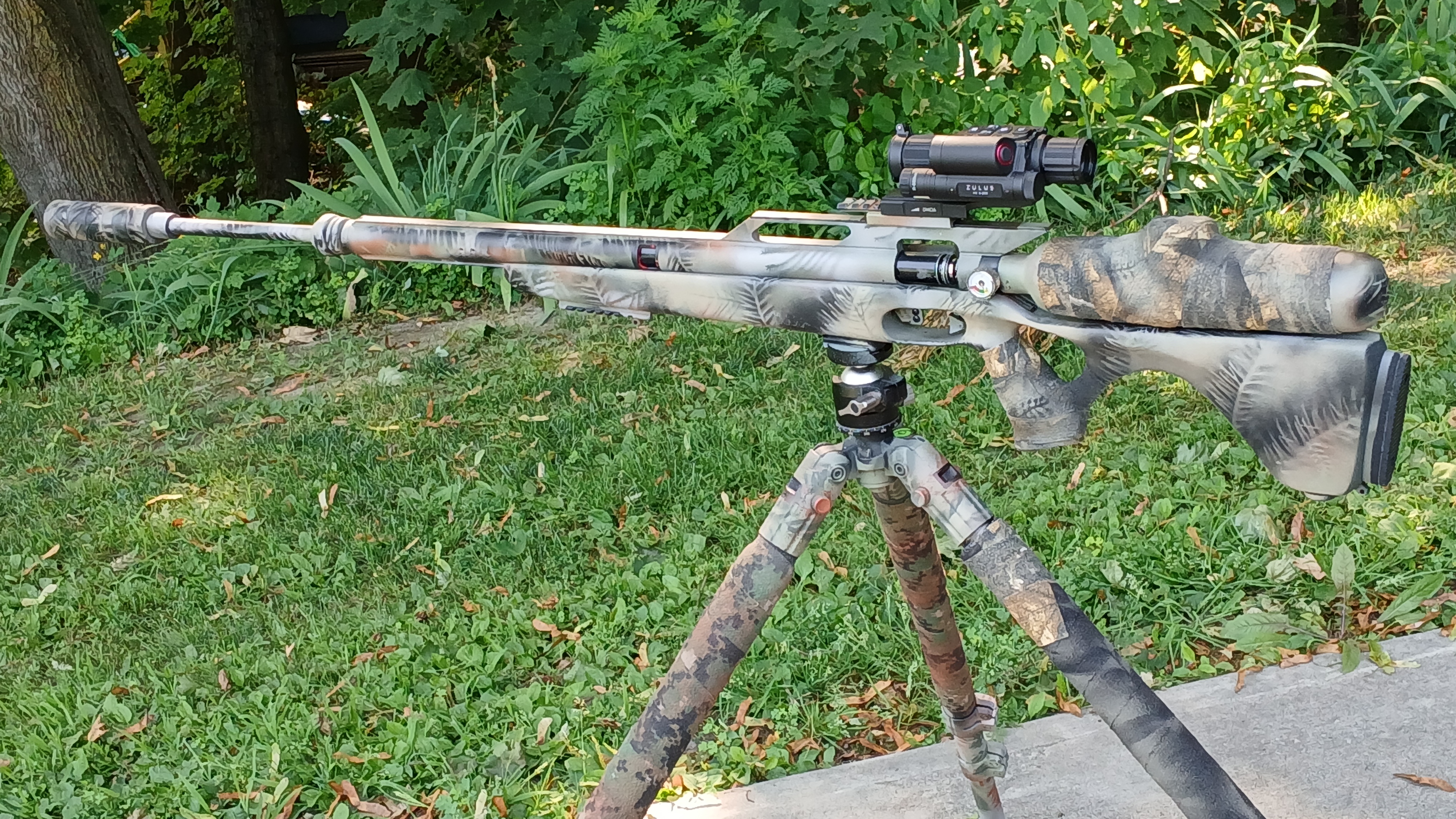

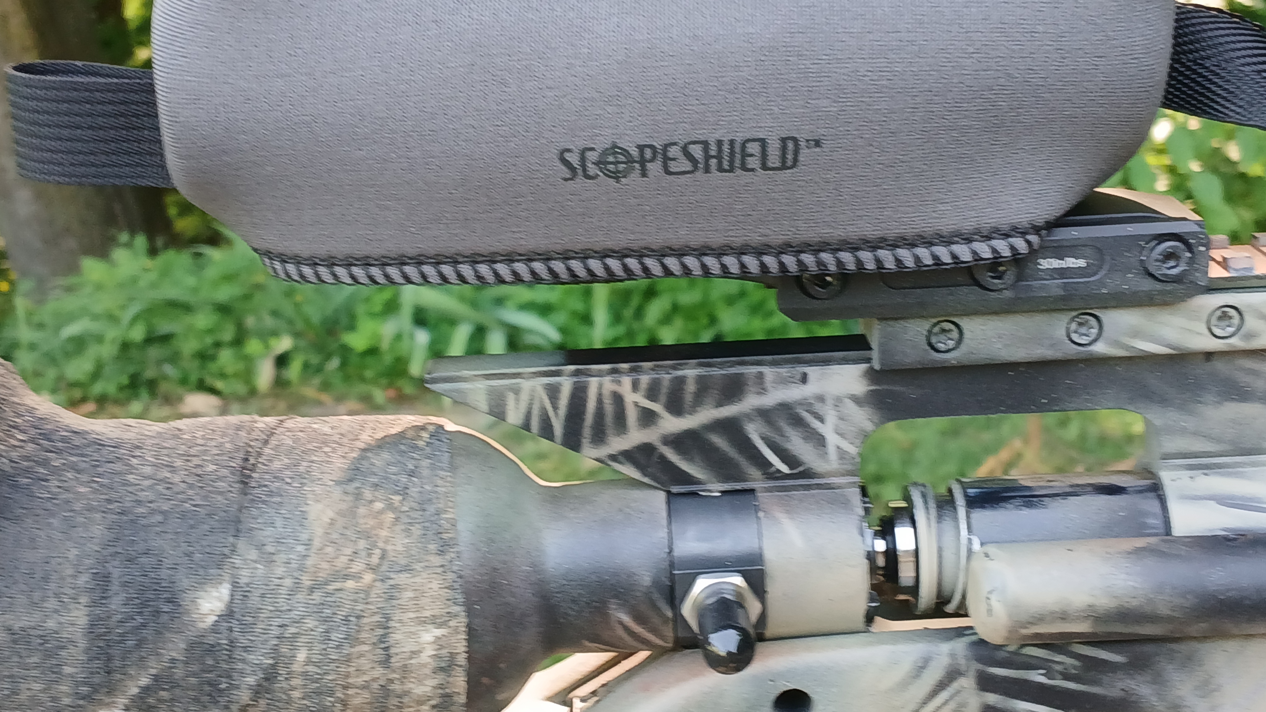

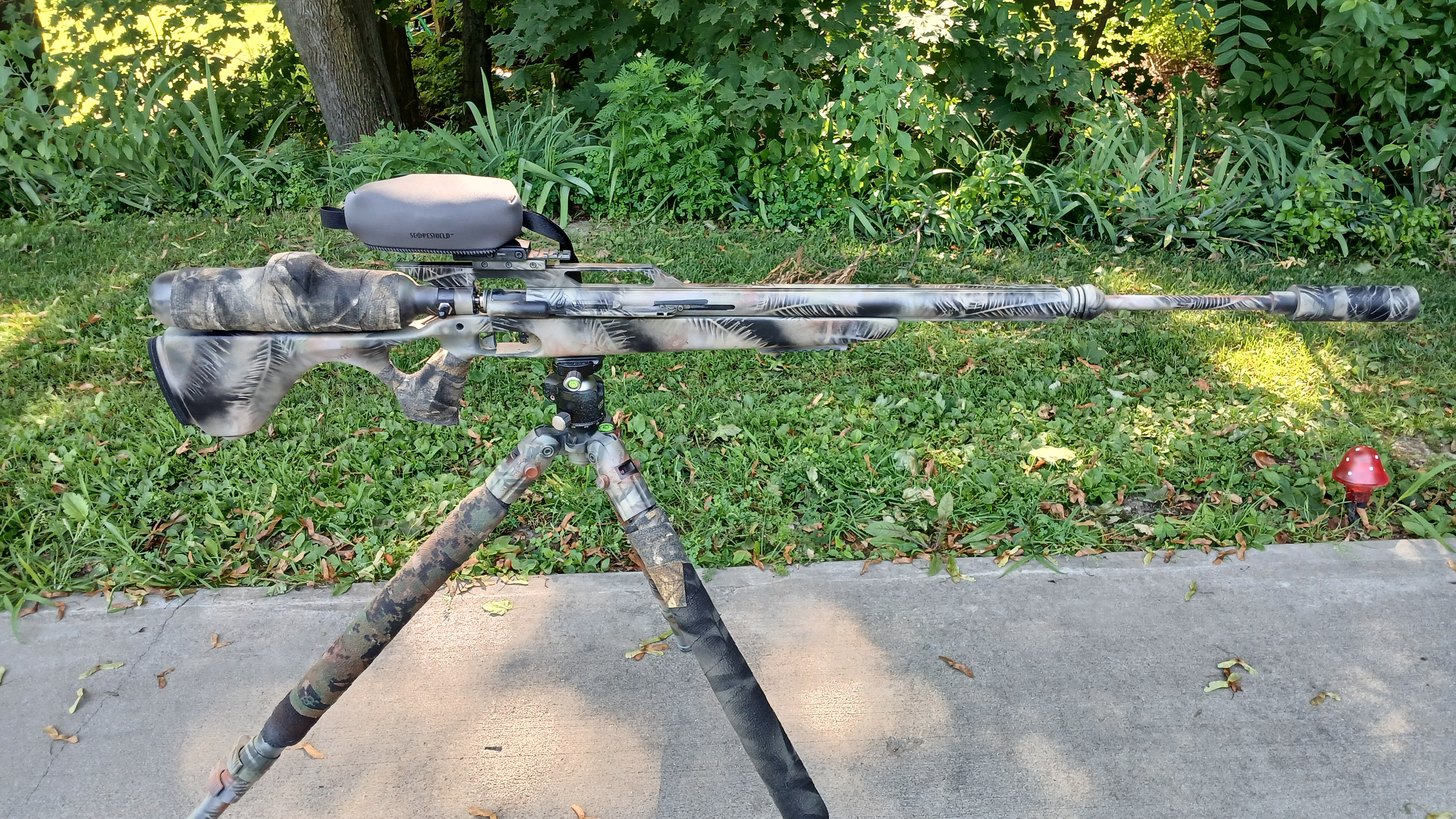

🛠️ Texan .308 Refresh – Function Meets Form Wanted to share the final touches on my Texan .308 build. The Trajectron 3625 psi valve is now installed, so no more flirting with the limits of the stock setup. Scope protection? Sorted—ScopeShield came through with a custom-fit cover for the Zulus HD 5-20x rangefinder after I sent the dimensions. Can’t say enough about their service.

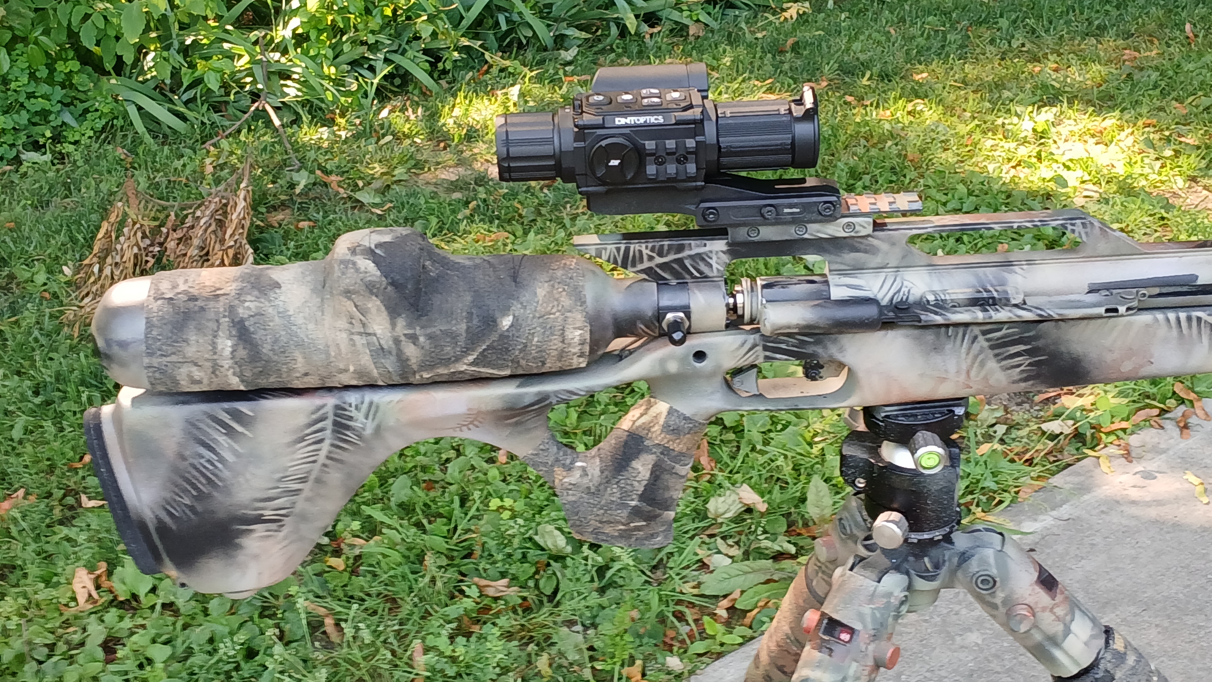

Added a wrap to a section of the tank, placed adhesive rubber squares for a cheek rest, and finished it off with a custom camo blend using Rust-Oleum light brown, black, and a touch of matte. Comfortable, clean, and mission-ready. With all I have done before, (MODS ) I can say it's completed, 150gr fps 990, the limit for a 1;14 twist.
