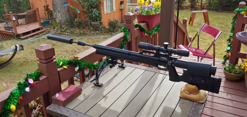

Shooting the texan .257 with the nelson 75 grain slugs above. Seems like these slugs are super tight ? So my experience so far.
1. These slugs get stuck in the barrel at PSI around 2100 or lower.
2. One of the slugs is really stuck now in the barrel even when I fill up the tank to full power and turn the gun to max power still will not blow it out !
3. Super long barrel now looking for a rod to push the slug out ...
1. Questions. First is this normal to have a stuck slug in the barrel more than a few times when presume is lower than 2100 ?
2. How would you suggest getting this slug out of the barell as now it just blows around into the barrel and you can feel the back air blowing from the pellet chamber ?

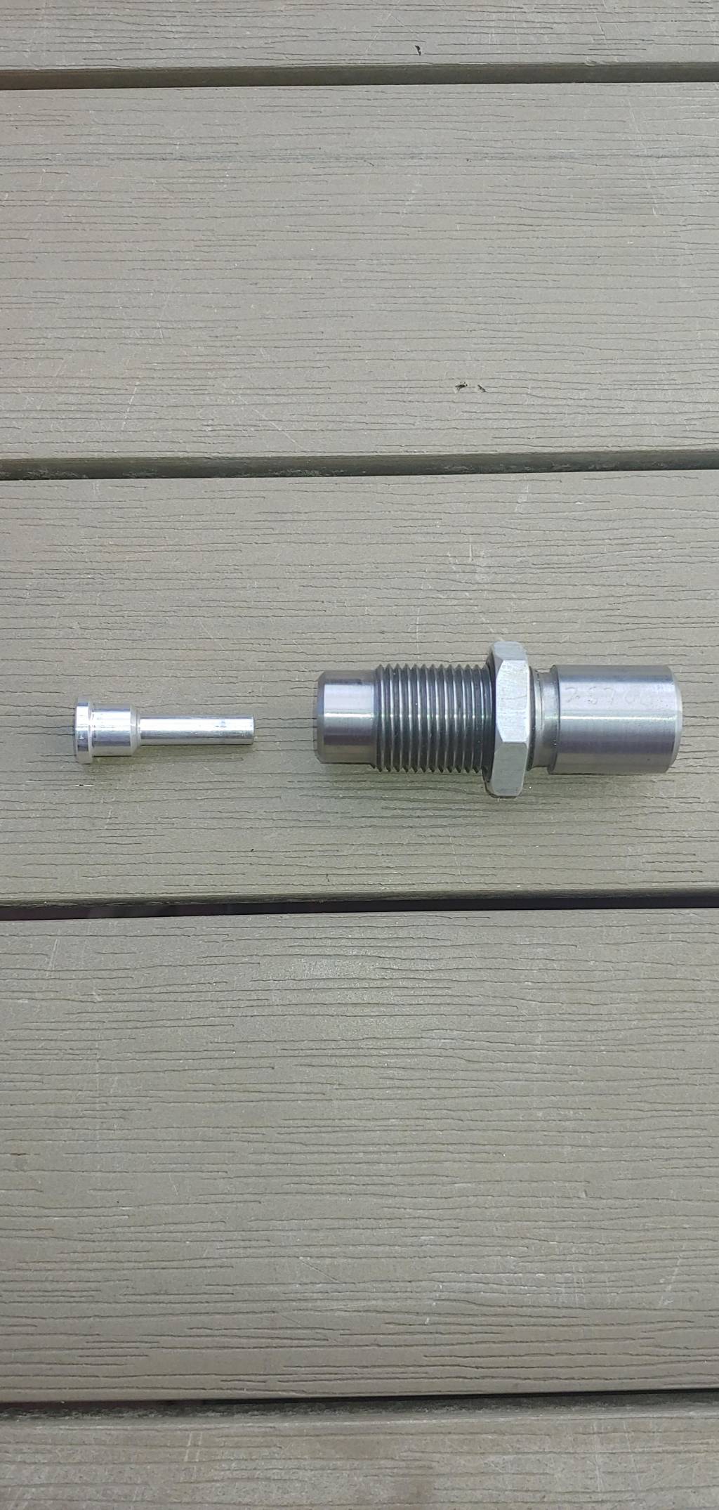

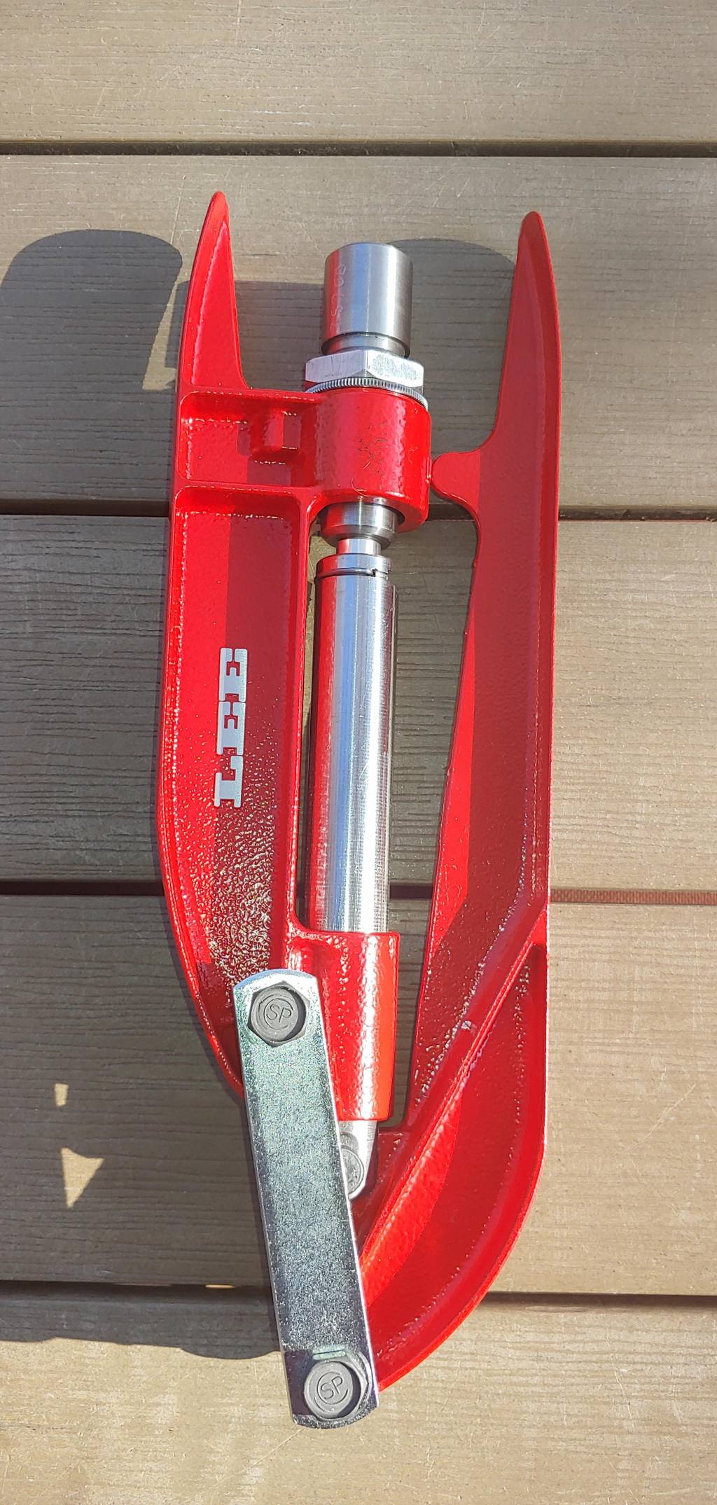

Jaydog, slow down man. First you need to slug your bbl. Then have a sizing die made .0003 over the the slug size. You also need some type of lube. Very hard to beat imperial wax. Are you lubing slugs before shooting them. 2100 psi is way low for texan. Consider very hard a 60 min tank and regulator. Hook it up and shoot tethered. Pm me if you need help.

Secret? I size and lube my bullets as i would for a powderburner.
