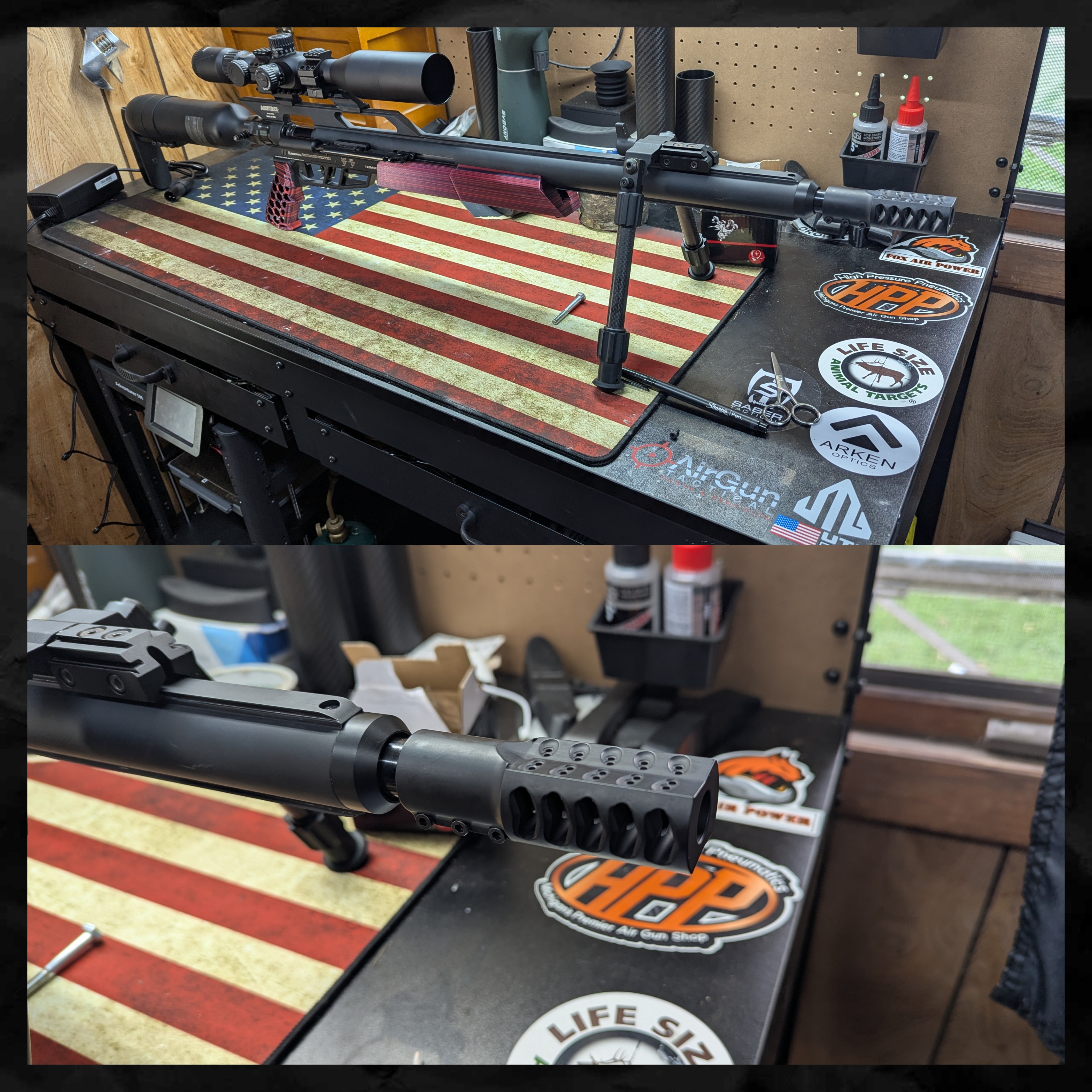

So I've done a few videos on the tex-rex 50cal and it's been a pretty good gun but I figured I could make better.. first I 3d printed my own stock and grip.. then I made a 4in long rubber bushing to slide over the barrel and fit inside the frame to act like a a shock absorber. I cut 7in off the barrel. Re-crowned it. Polish the barrel and Finley added a muzzle break... This is like a completely different gun and shoots amazing.

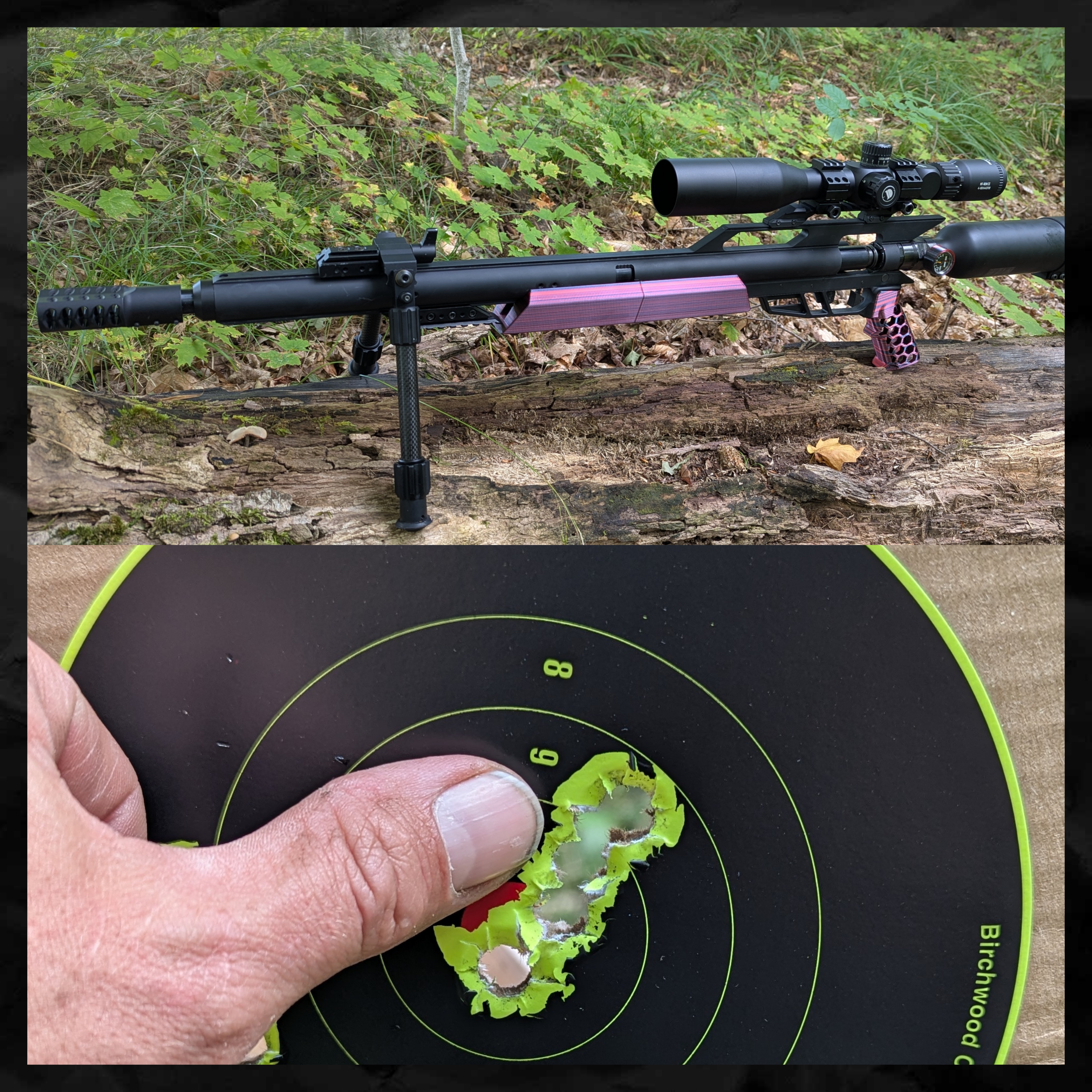

4 shots at 60 yards 345gr mr.hollow point slugs 😋
