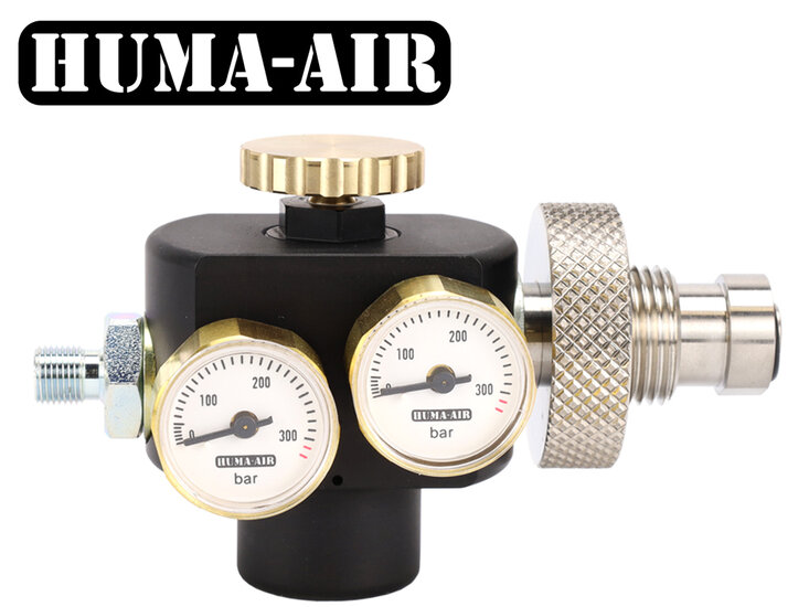

I have a DIN valves on my tanks, and using this Huma externally adjustable regulator for several years. I pre-set it at 185 bars (#2 setting) and tethering my Impact all time when I am at my BR range. Very convenient, you can change the pressure on the go. Also replaced the analogue gauge (in the picture) with Huma digital.

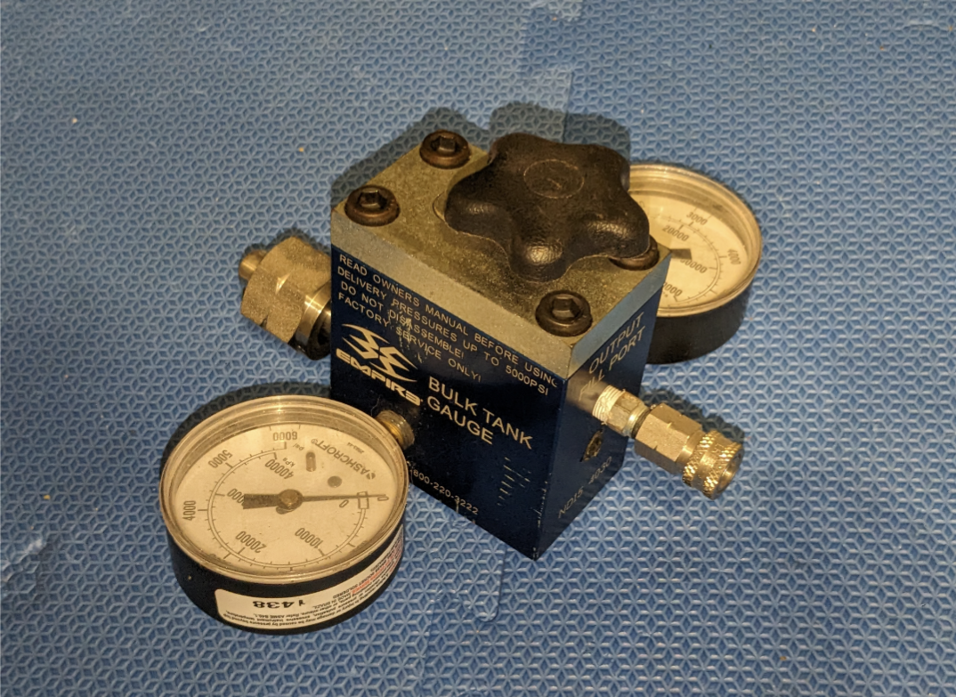

Here's a picture of one I have on my shelf (you can see it's a little dusty!). This one is branded as "Empire" but I think it's made by Ninja. I also had a Ninja branded unit but it's currently attached to my dad's tank. I set it up because I was worried about him accidently overfilling his gun. His eyesight isn't so good anymore....
You’re a good kid. I sold my 2 AlkinW31E because I figured if I died my kids could seriously hurt themselves trying to fill or shoot dad’s airguns.
It’s love that causes us to worry about the worst possible outcomes.
Reactions: virge
Dad took care of us and we take care of him now. Getting older and having my own kids really makes me understand what he had to deal with. To be young and stupid again.... 😂
