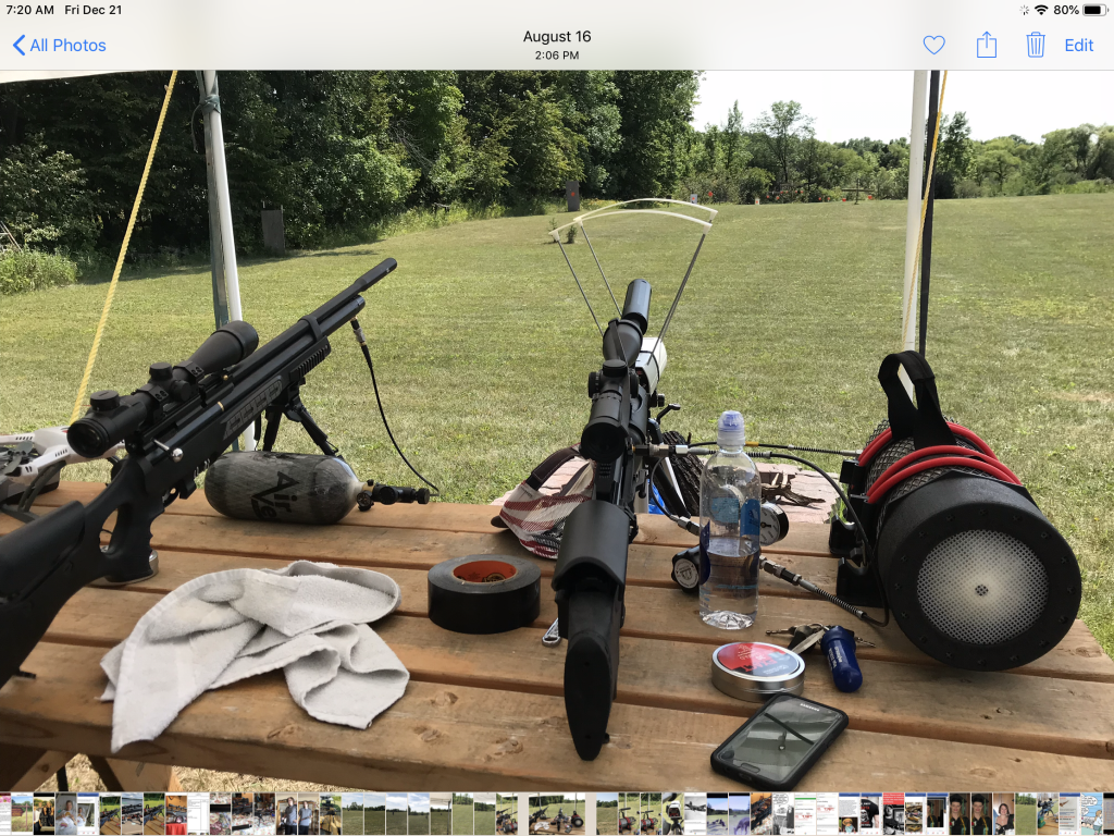

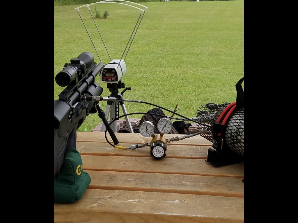

Tethered Setup

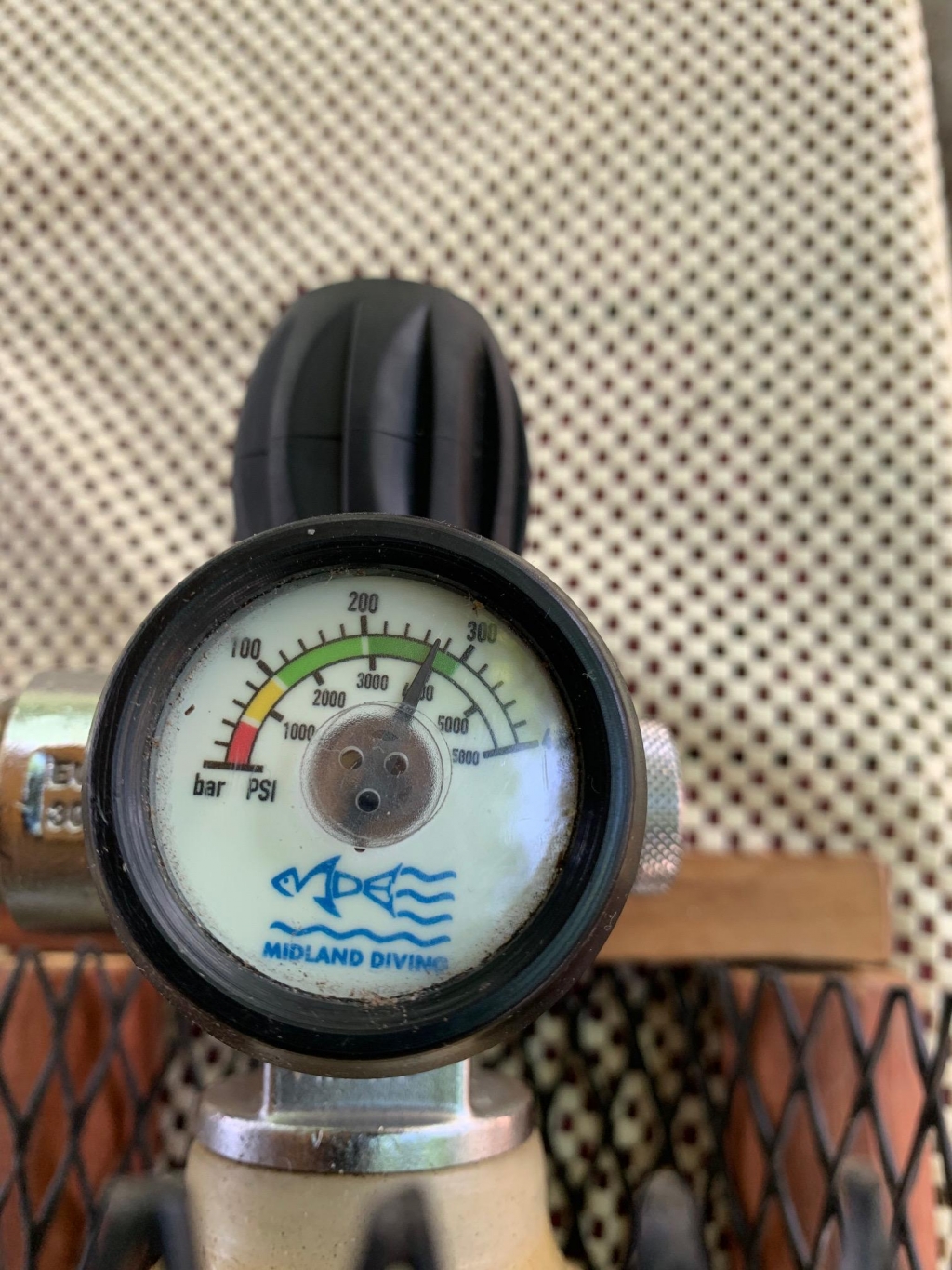

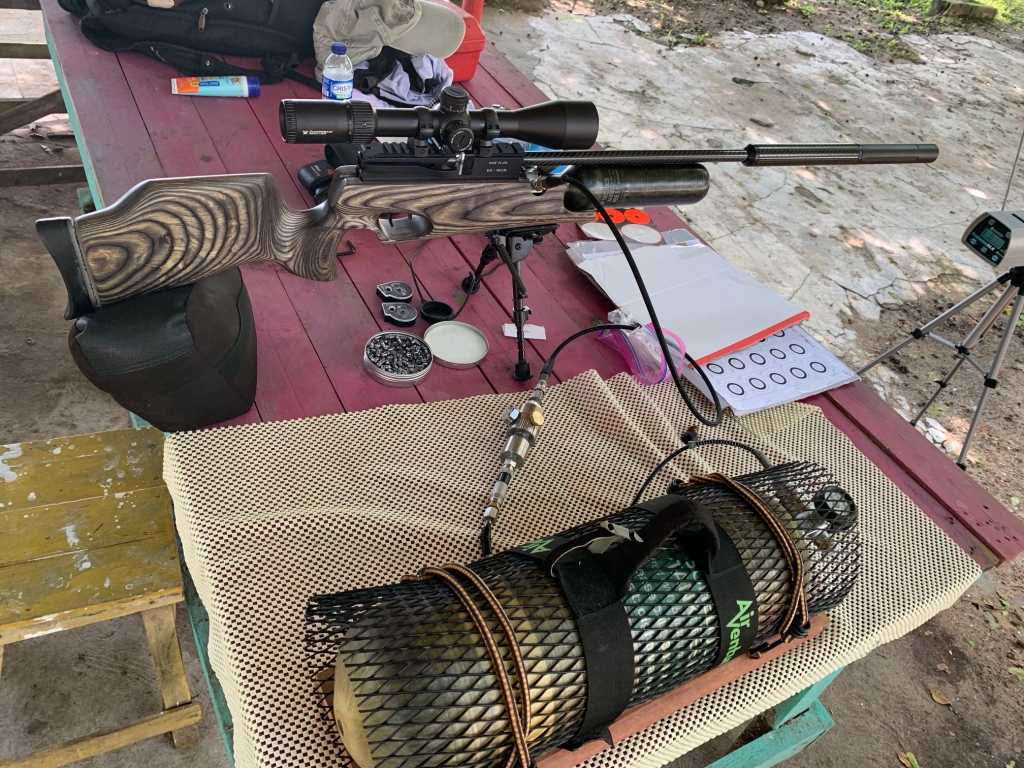

There is probably a fill pressure range your gun is 'most consistent' between. I think that would be my goal. But then again, I keep it simple and just use something in between. That is partially convenience for me. I don't use an external regulator. I have an old SCBA tank that I just fill to about 210 bar and shoot down to 160bar with the fill probe plugged into the gun and the tank valve open. The new tank gets the 4500psi fills. My approach doesn't work for many.... I have 2 tanks and I do my own fills.

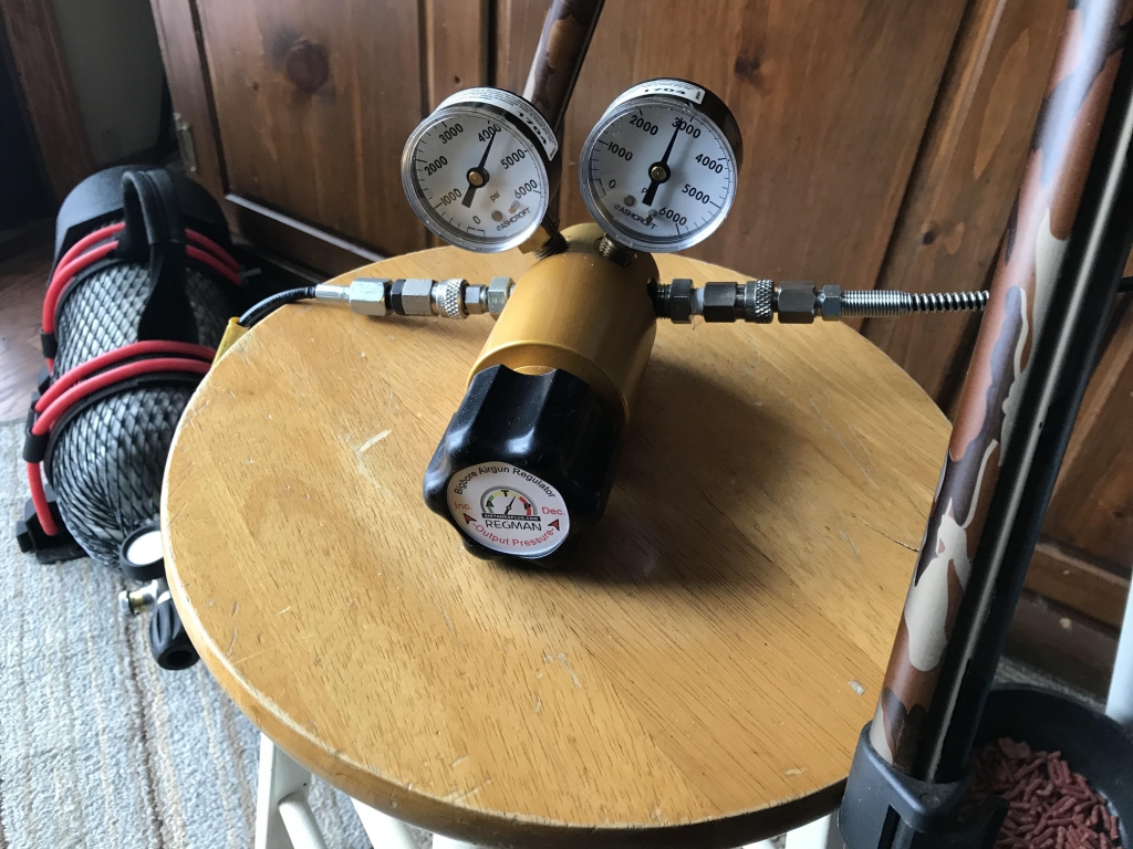

Every gun has sweet spot, fill it and shoot thru the chrony to identify it, then you must set that external regulator on that pressure range, in my case my sweet spot is between 160-170bar. You will not waste air anymore by bleeding the system, you will increase consistency, save time by not having to stop shooting, You also avoid taking the system to the limit due to those fills to the maximum working pressure.
