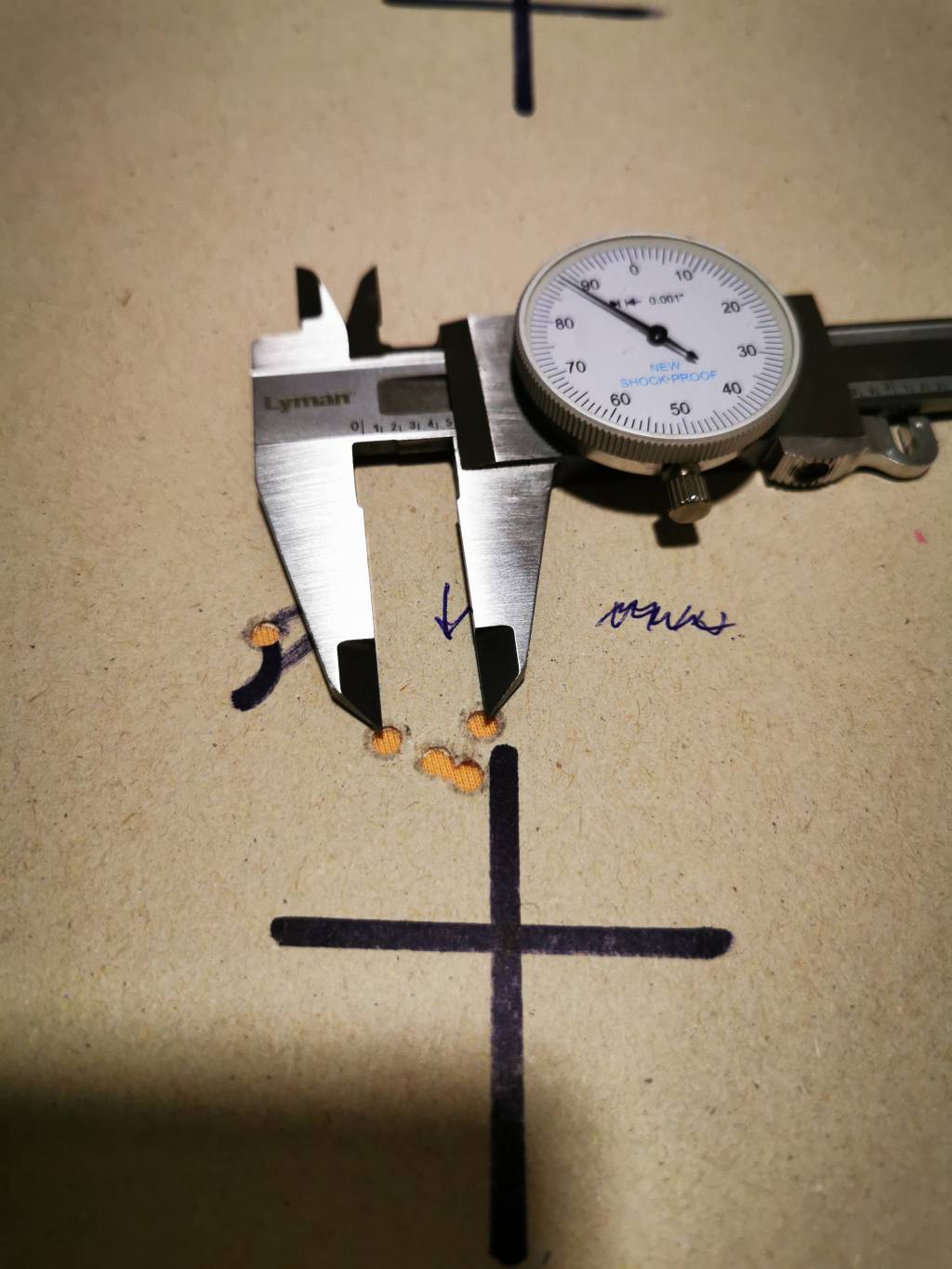

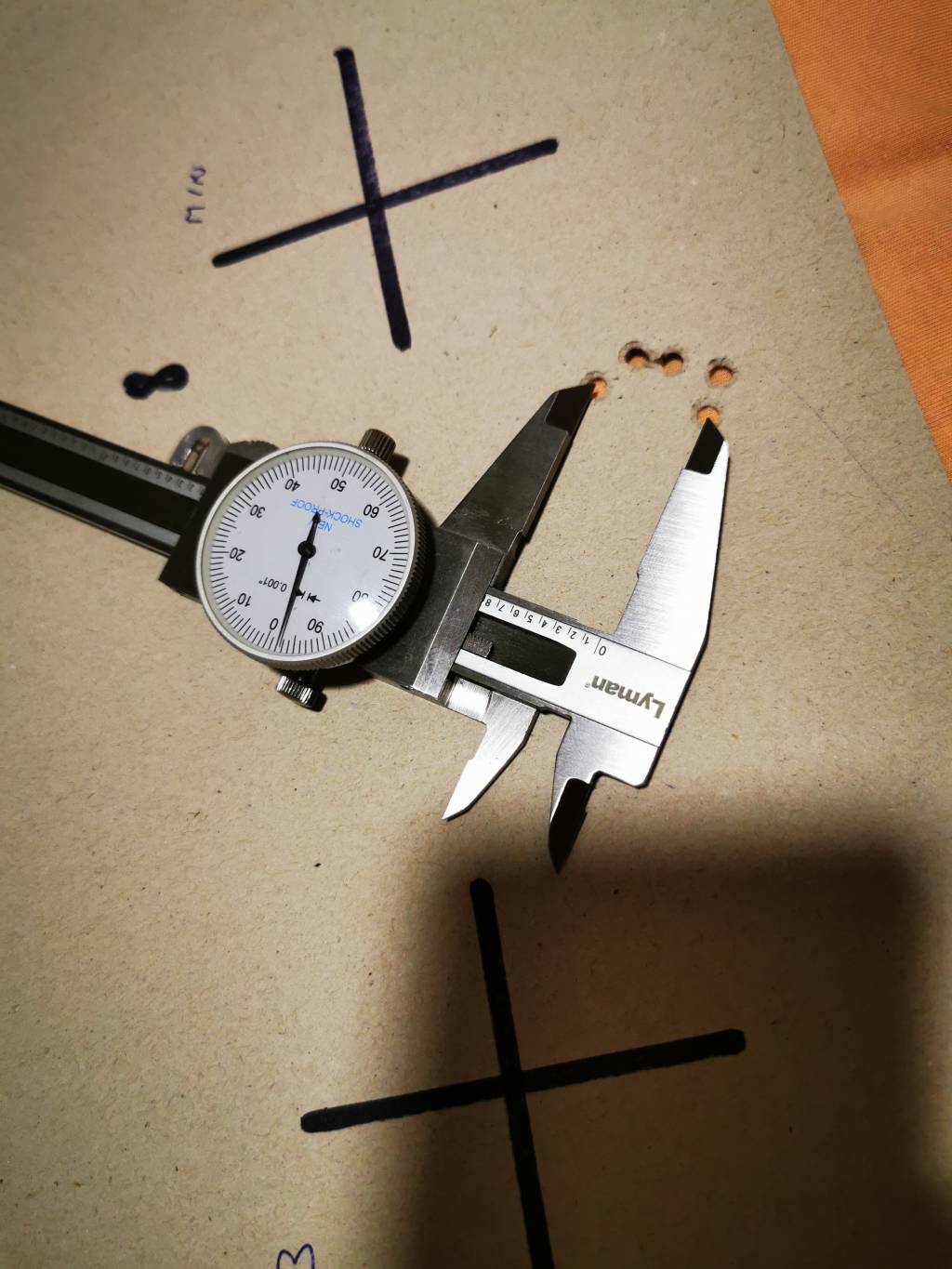

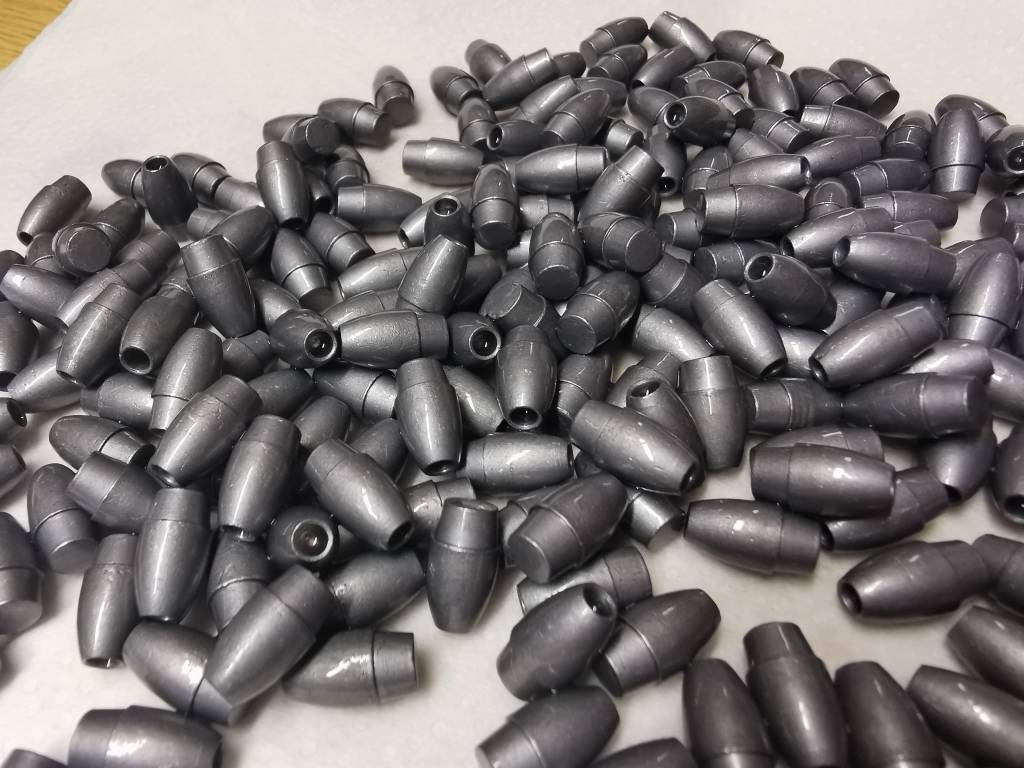

I made some slugs in 32, 34 and 36.7 grains with cup base.
Unfortunatly my chrono was dead due to bad light, so i couldnt get any speeds. I made 5 shot groups with diffirent hammer setting.
I was shooting on 107yards and best group was 0,8inch and i screw up another with the last shot, it was 0,45inch until last shot that i pulled. Best groups i could get with jsb KO was 1,1".
I couldnt repeat any group because i had only 5 slugs for each hammer setting.
I have impact .25 700mm superior heavy, reg at 120bars.
Next time i will messure speeds and fine tune with hammer spring. Also need to try other weights and tail shapes
