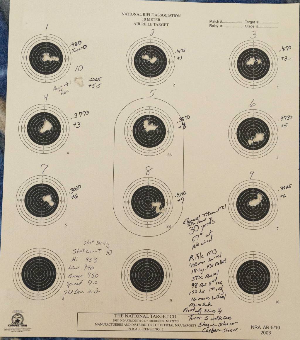

I was able to get out today and try to tune my M3 Sniper 22 with FX 18.13 pellets.
The Rifle Specs
FX M3 Sniper
Cal. 22
STX sleeve
Scope Element Titan Mil. at 24x
Range 30 yards
57 degrees out sunny and no wind
18.13 FX pellets
1st reg. 150
2nd reg. 98
16 Macro Wheel
Micro 2-2
Front Adj. 3 lines and 1/4
Full Carbon sleeve Tuner
Carbon sleeve on the liner
and Shogun Silencer
FX Chrony 10 shot string
Hi 953
Low 946
Average 950
Spread 7.0
Std. Dev. 2.2
5 shot groups
Off of a Bench with Bi Pod and bag under the butt.
I shot from Zero top left on the Tuner to +7 large hash lines on the tuner. 1 being zero and target 8 being +7. I was pleased with how it shot and measured the groups on the target. Tightest group was 7 so I shot another group at +6 on target 9. Then adjusted the tuner to 5.5 or 5 and 2 small lines and shot the group 10 by the top left group. I was using the #1 as my aim point. Was extremely pleased with the group measuring .2565 of an inch.
I am pleased with how the groups tightened up, but I wasn't surprised as I have had the BOSS system on my 300 Win Mag and 308 before so I had some history with this type of tuning and was happy with the purchase.
