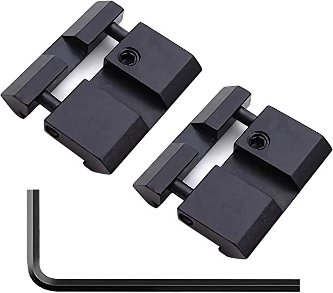

I've tried just about everything out there on the market, and these are, by far, my favorite solution to adapting a picatinny mount optic to an 11mm dovetail on my guns.
Why? Height over bore! These keep your optic low, and that height over bore down so your POI shift is minimized at closer ranges, making those close-in and elevated shots much easier to get spot-on in the field. And the best part? They're inexpensive, and made of good quality aluminum! :)
Snap in 11mm -> Picatinny Adapter

Yes, they fit inside of a set of picatinny rings and are nearly invisible.

I need one with 20 MOA down compensation. My scope is completly agaist its up stop.
Reactions: iAMzehTOASTY1
What you need is a set of lower rise rings. It'll reduce the adjustment needed to zero.

Hi,
I shoot springers and looking for solutions to use my powder burner optic mounts… keeping optic low is a desired outcome. Last but more importantly, it needs to hold given the effects of spring gun “recoil”… gun is a RWS54 (Diana AirKing)… any experience for that application?

I use them on my R7 and HW97. I replaced the set screw in the middle of one with a socket head cap screw. It makes a better recoil stop.
