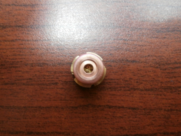

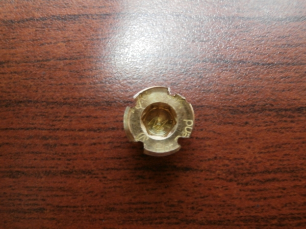

Boys and girls I can now tell you that there is no alarm clock nor anything else that will wake you up from a very sound sleep in sheer terror than a full 3600 PSI 500 cc bottle popping its burst disk in the same room you are sleeping in. It launched me straight up out of bed with prickles running up and down my spine. There was no reason for it to pop. The room was 65 degrees and the bottle / R&L extreme valve setup had never even been used on my .257 Condor to date (It had been built and pressurized to test for leaks). The only thing I can think of is possibly when the valve was shipped it accidentally had a stock 3K Burst disk because a 5K disk should not have ruptured at that pressure. It is also a bit hard to go back to sleep after such an incident.
O well at least it wasn't a 75 cu/ft bottle! :p
As you can see from the pictures it is impossible to tell what PSI the disk was because it was ground away when the grooves were cut down the sides of the assembly.

@ Hynzie ... No the disk and shattered parts are all captive within the assembly. I always install my bottles on AirForce equipment with the burst disk facing down or away from me as much as possible. This happened with the gun in its case in the closet. If it had not been contained I can only imaging how loud it would have been. I just ordered 2 new assemblies rated at 5K (Bottle HP is good to nearly 5500 and WP is 3625 psi) so I hope that cures it once and for all.

The local scuba shop bought a pallet load of 3000 psi 80 cu ft tanks complete with k-valves a few years ago, four of which were ordered for me. Two burst discs popped on first fill at no where near working pressure. It turned out to be defective burst discs and we wound up replacing all of the burst discs.
One of of them going off next to you at the fill station does result in needing a change in underwear.
