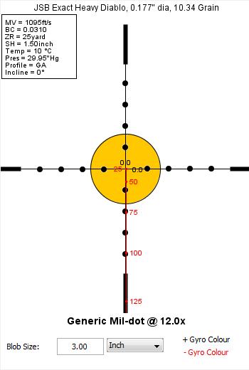

Examples: This is the best ChairGun can give me since I do not have a Hawke Scope:

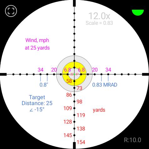

Strelok

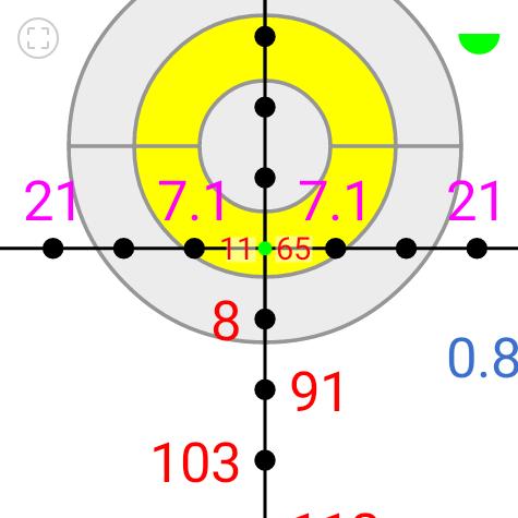

Now this is what my scope looks like, and although the Strelok has all the added settings on (far distances, MRAD, etc.), but you can switch off my a touch on your screen. If my target was closer or farther away will dictate the hold under's as well via app view, and I love the feature I can email myself or anyone my views immediately from the phone. See the circle upper left with the small rotated 'L' brackets? That's instant zoom!
Here is an example when I recently zeroed my scope @ 12yds to do ratting once I am back home with a max distance we will be shooting is @ 24yds: Right there, without fail with zero wind is where I need to aim (albeit you can see this without zooming; all depends on distance).
Also, based on location, Strelock will automatically adjust for temperature, pressure and humidity which yes, has more to do with long range shooting say a center-fire, but temperature does have a factor regardless when it comes to shooting anything.
