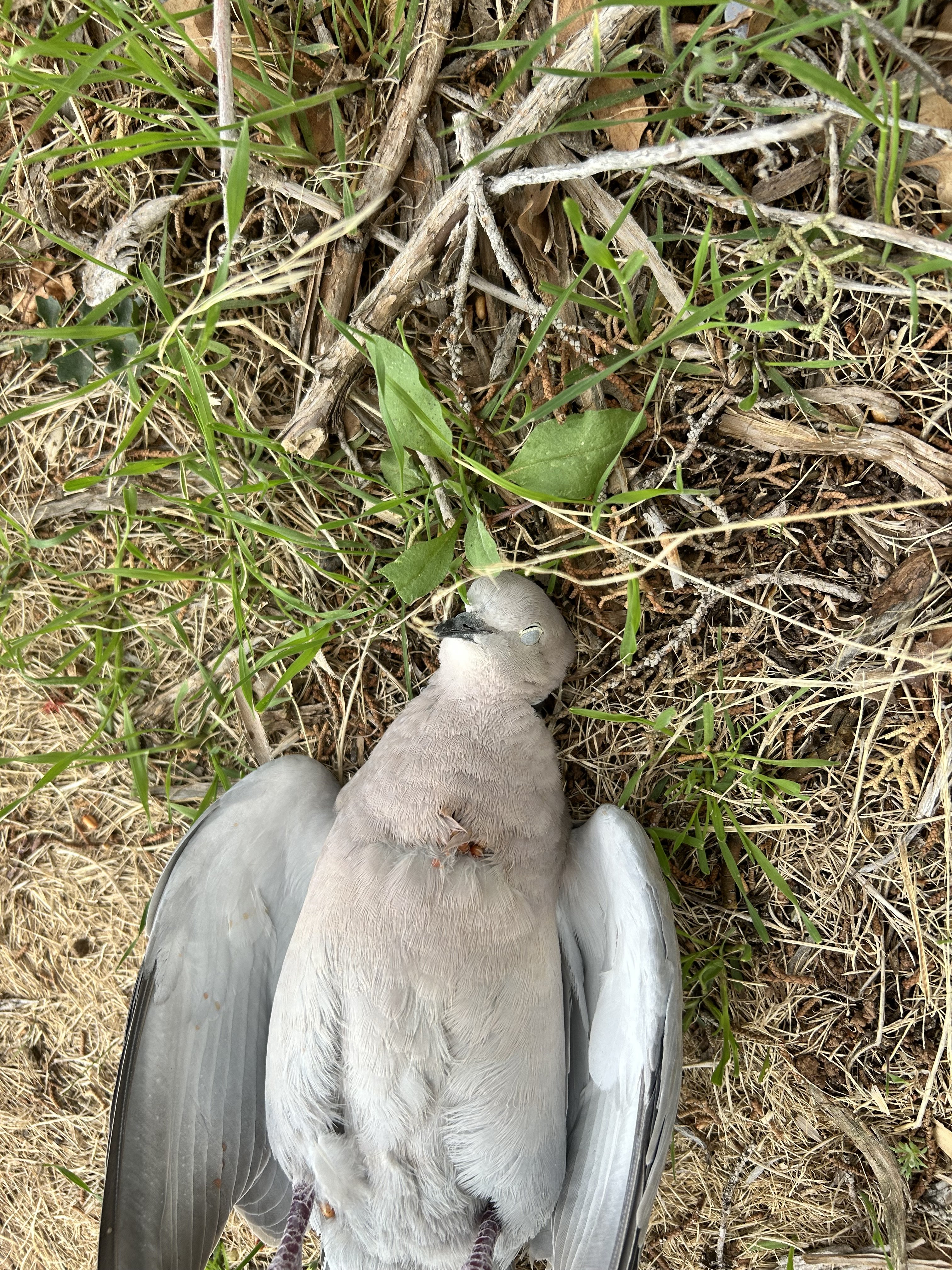

Im using a .25 30gr going 960 out of my Barra 250z… it the only gun I own and I use it from squirrels all the to coyotes. I also shoot a lot of Eurasian Collared Doves. I like the 30gr slug because it’s very accurate, shoots flat and more importantly at 960 the expansion is unreal. Every time I shoot something it sounds like a little firecracker goes off when it hits. Doves are freaking Dove little birds but this slug drops them super quick cuz I’m surrounded by juniper trees a sage, if the critter moves too much I’ll lose it….
My point to all of this is I think you should be focused more on effective energy transfer rather than caliber. 30fpe is the same for all rounds regardless of size, the difference is what ammo is gonna dump its energy into your intended target most effectively?

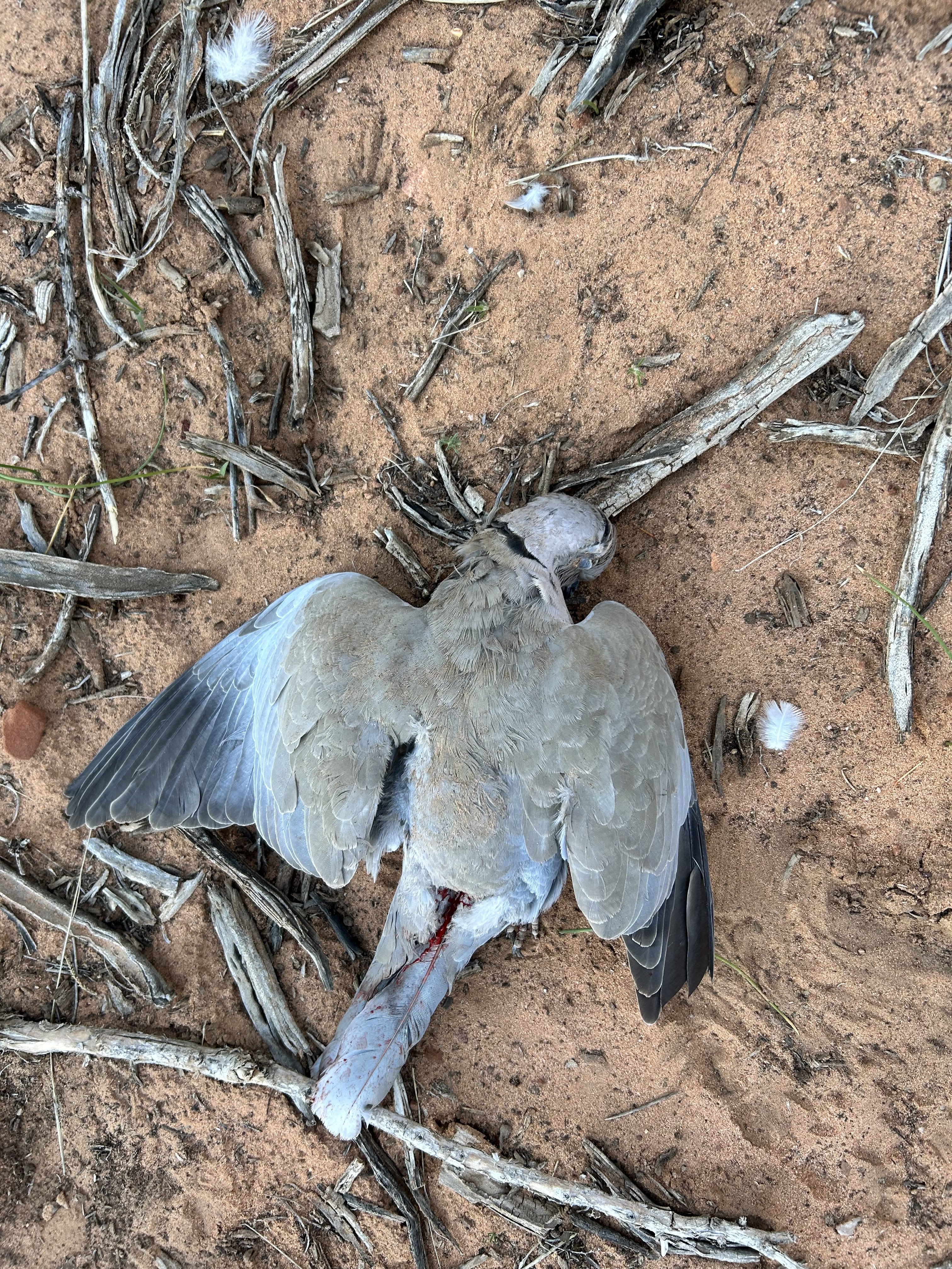

You make really excellent points. Most people don’t ask 1 gun to as many things as I do which is why I run it the way I do. The gun will shoot 35 and 36gr slugs beautifully in the 880’s but I find that they pass through on the smaller game. I probably need them to go faster but the BC makes them carry waaaay farther than I need/want. The 30’s will too but it’s always windy in SW Utah and the pellets just move a bit too much for me.
I have a couple spots where I definitely have to be very careful. I don’t shoot about 10 times more Doves(I don’t shoot native doves at all. Too many invasives around haha) than I actually do shoot. The nice thing about these soft 30gr is that I can hear when they hit which is nice. I’m not a marksman by any means so I try focus on shot selection and putting myself in a position so that if I miss it’s in a safer direction.
Mostly I was just saying that for birds I go for ammo that dumps its energy the fastest because it seems to drop them faster and I don’t worry about passing through. OP mentioned using the .30 but going real slow. My concern with that is as he mentioned the trajectory might be wonky. So maybe harder to aim? Also even going slow a pellet with 32 fpe can still pass through the bird depending on its shape. My focus would be less on the caliber of the gun used but on being super accurate with ammo that won’t pass through the target.
