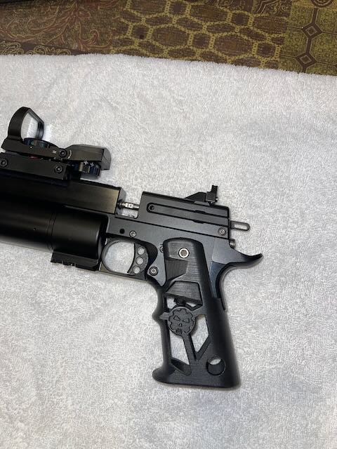

Well our friend sent me a new grip, printed with carbon fiber. This is like grippy, you will NOT EVER SLIP with it. The fit was the normal excellence, actually had to tap it on, the screw requires a 7/64 long reach to get to it, I used a hemostat to get it in the hole then tightened it. It survived me using it so short of smacking it with a big hammer it's good to go. Did I mention it feels great?
