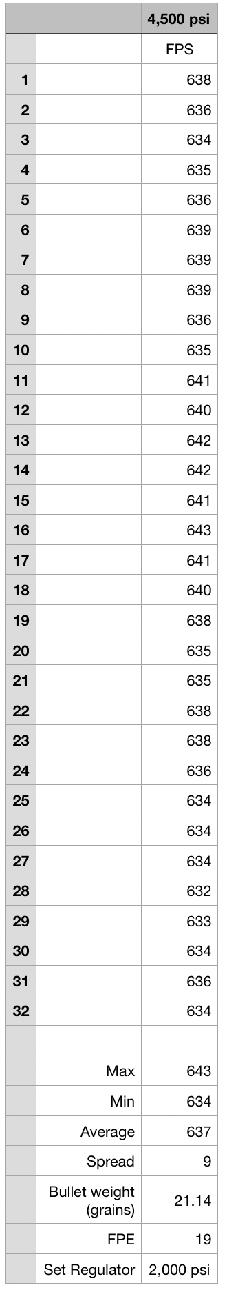

Hello everyone,

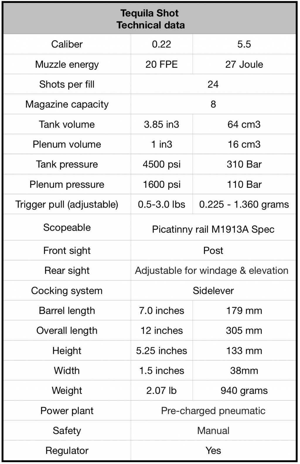

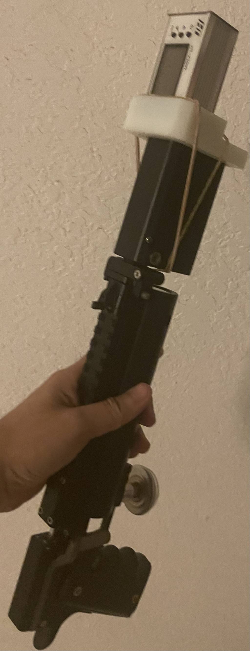

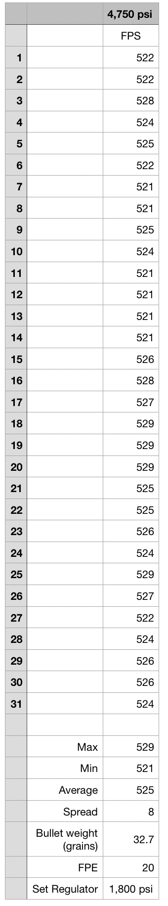

Finally I can shoot the Tequila Gun, I can get 19 energy pounds, using a 7 inches barrel and regulated to 1,700 psi. It is very noisy but the folding suppressor doing the job and quite it a lot.

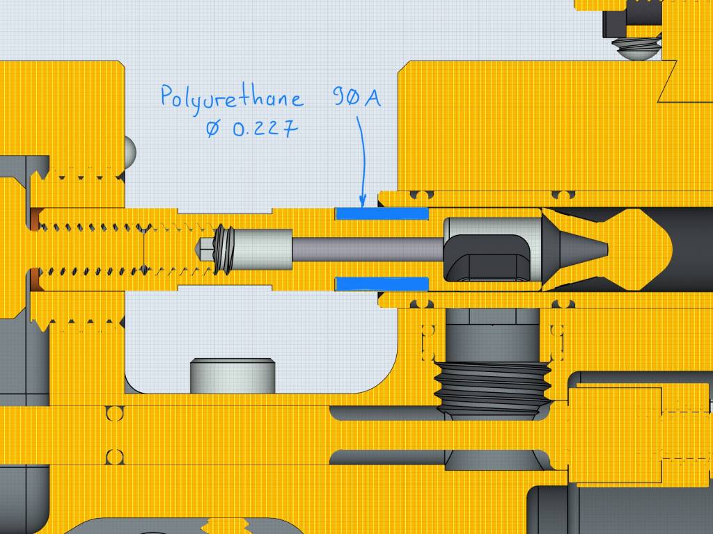

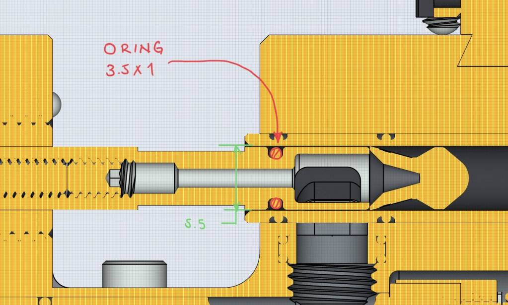

Unfortunately the gun has a leak in the pellet probe. But fortunately I redesigned it and I have the concept ready to be fabricated.
The attached pictures show the issue.
The leak is because the 5.5 oring is no sealing the barrel, but I redesigned it adding a bigger and harder seal. Tomorrow I hope start do them.
Regards
