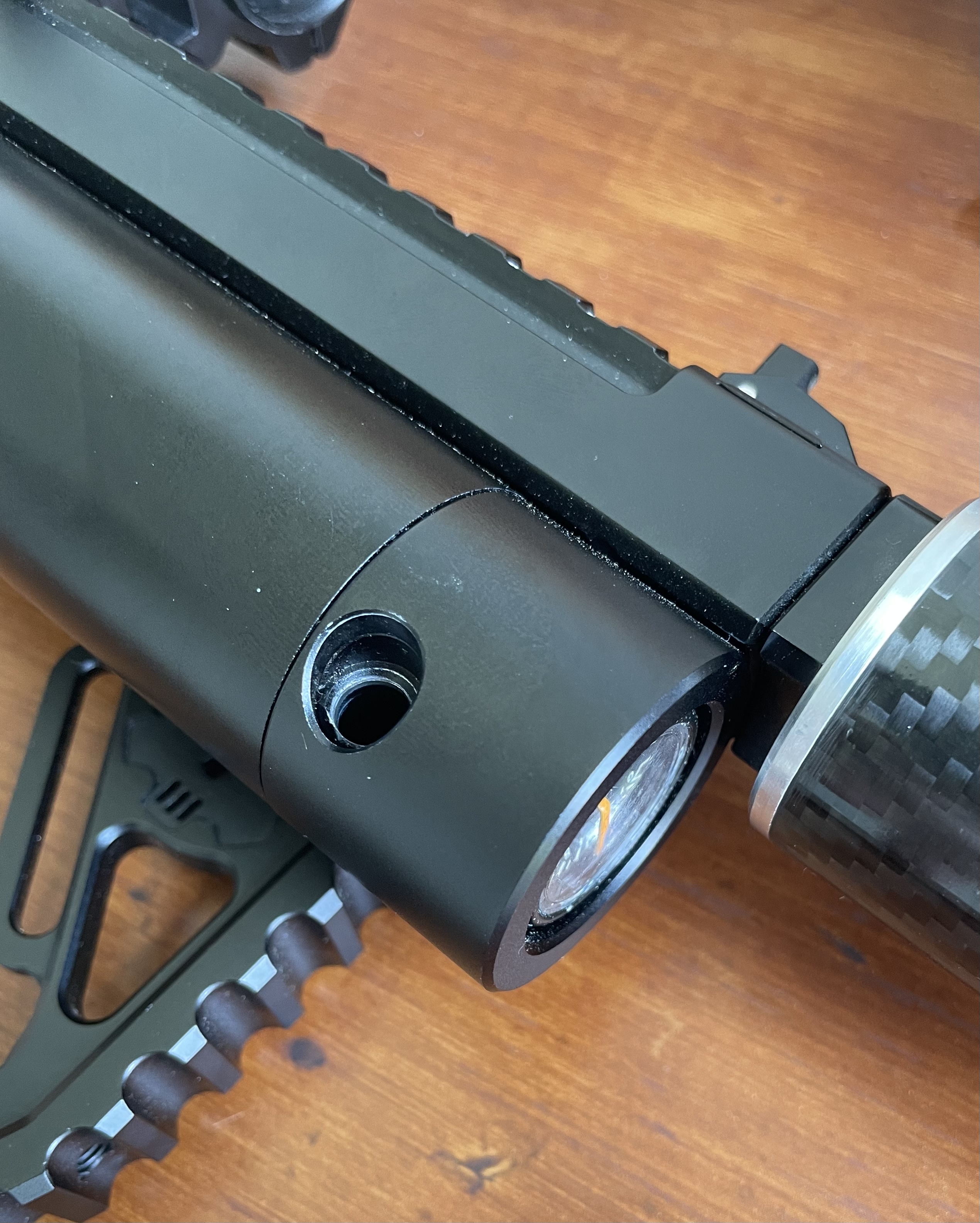

I'm pretty sure I've read every post in this thread, somewhere along the line I missed how is this fine looking gun charged? I'm anxiously awaiting a video of the gun in action, not a bunch of slick advertising but a solid step by step of this gun. Also, is the barrel threaded? It appears to be in later photos. And of course, having the charging handle on the right side. I truly appreciate the step by step progress that Xolotl has provided.
Reactions: Bandito

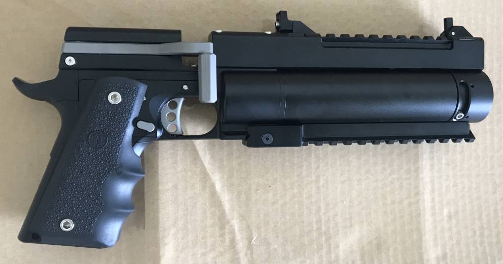

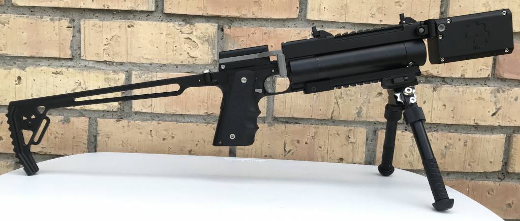

Hello Hog Killer,

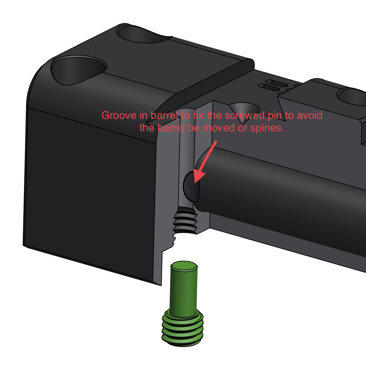

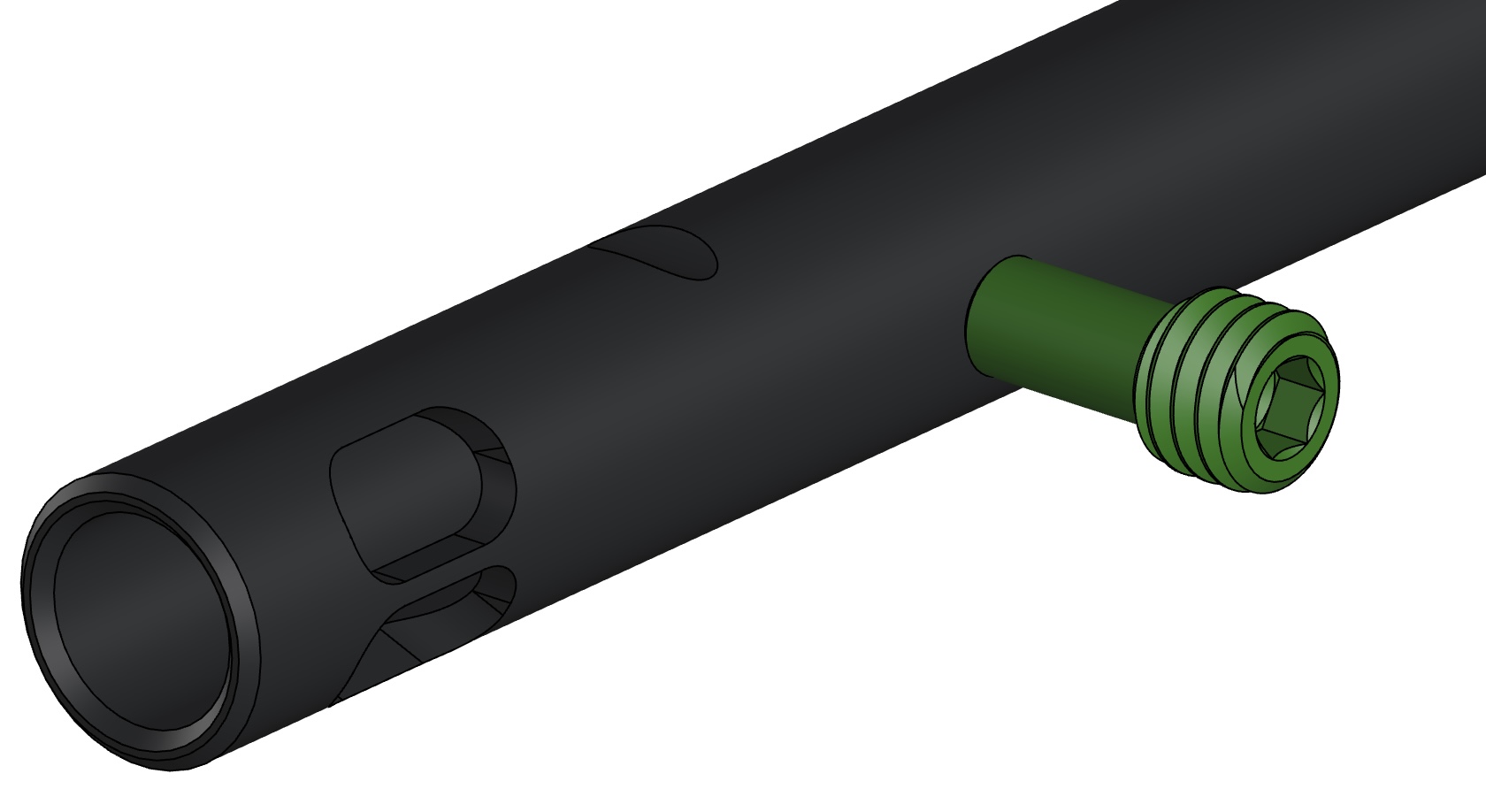

The attached pic show the following:
1 Charged port open and close.
2 How the barrel is attached.
Any question please let me know.

Air charged the same way that most other guns are charged. The outer end (adjacent to the gauge) of the air cylinder with a probe.
The cocking lever has been changed from its original design. A thumb action to open and fingers to do the actual cocking. Nicely done.
The barrel is threaded. Unlike the original design with a proprietary suppressor, it is now threaded, and most all suppressors will now screw on.
