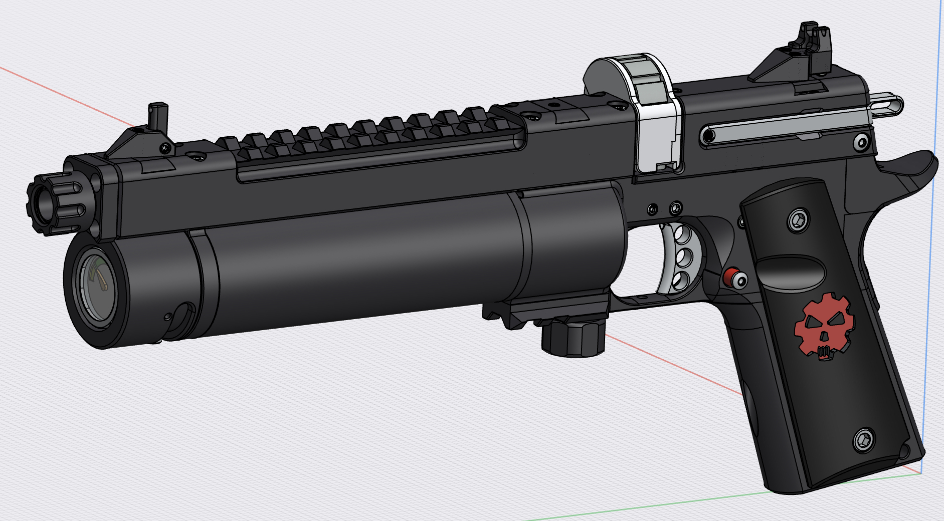

Hello everybod,
In 10 weeks, 50 Tequila guns will be ready to be shippe. If someone is interested to get one, please send me a private message or email: [email protected]

Haaa...a left handed gun !
Difficult for right handers.
Unless,,,the handle can be swapped from side to side ??? The final product
Final detail information requested -
Calibers offered ?
Fill pressure max. ?
Magazine quantity sold with the gun ?
Fill probe sold with the gun ?
Is the suppressor removable ?
Is the trigger adjustable ?
Is the power adjustable ?
Mike

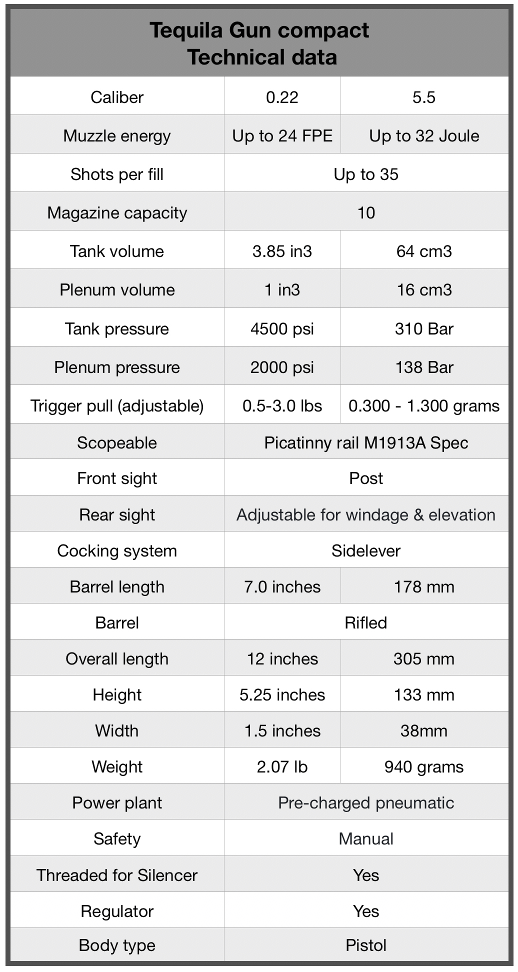

1.- The first 50 pieces are be built for right handler
2.- 0.22
3.- 4,500 psi
4.- One magazine made of stainless steel
5.- One fill probe made of Stainless Steel
6.- YES
7.- YES
8.- YES
That looks fantastic. Unfortunately it looks like that gun could not be sold in Canada. Our market probably isn't significant-enough for you to try, but to make it legal to sell here it would need to be designed in a way so that the gun could not fire with the stock folded. Either that, or it would have to be designed to shoot sub 500fps.

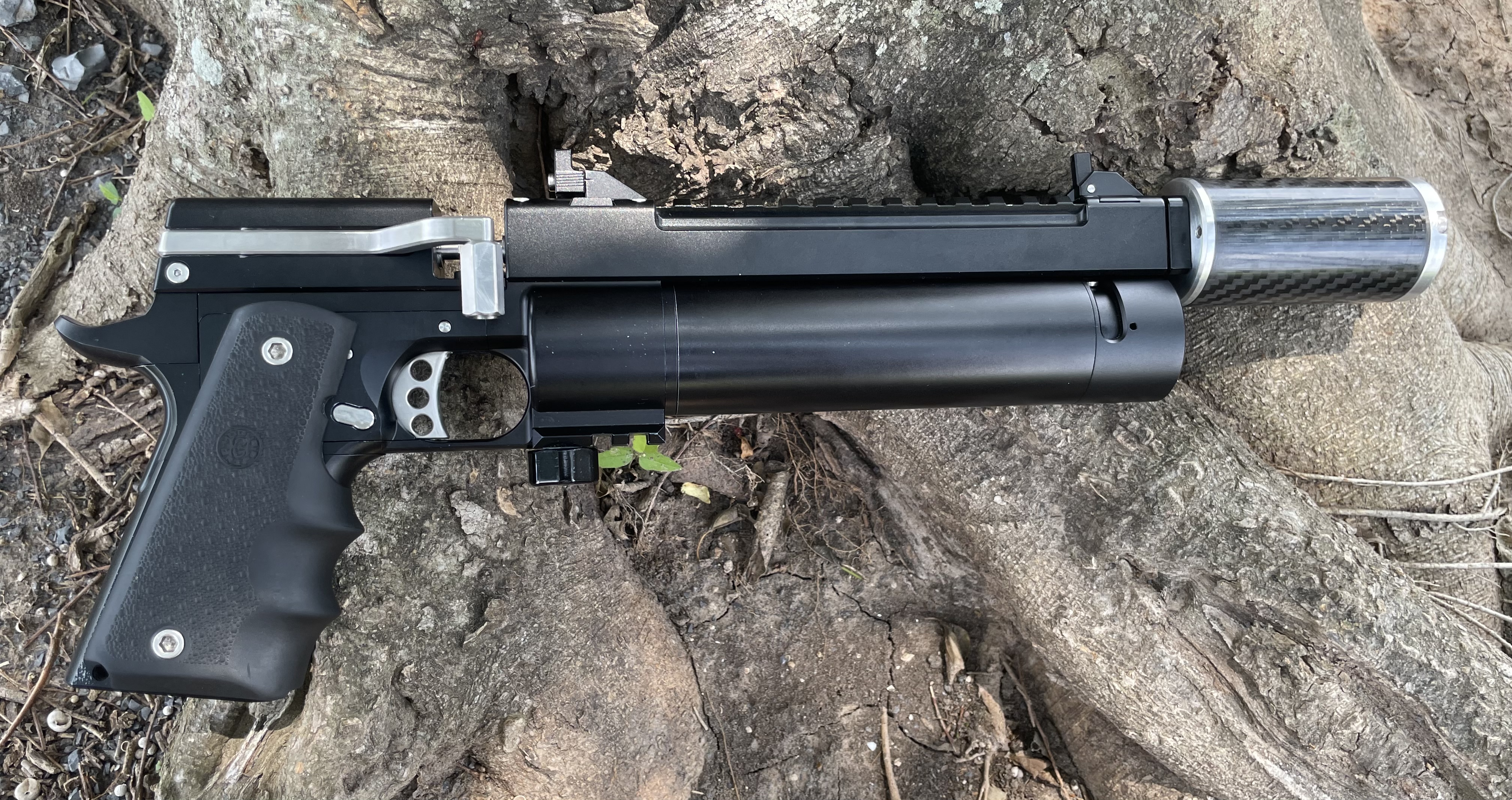

I know the canadian rules, for this reason the Tequila Gun will be offered in 0.30 caliber. And the specs are the following:
7” barrel
490 fps
Pellet: 48.6 grains Hatsan
Energy: 26 fpe
Shots: 24 by fill

Alfonso,
your engineering piece has some spectacular specs, and the pun is not to be funny. This is cool.
It is super short, similar to the Ataman AP16 Compact. But your Tequila blurps out over 20FPE — whereas the Ataman Compact just gets half of that....
And getting 35 shots from the 64cc tank is a lot, the Ataman managed in a test only 22 shots at 14FPE.
I appreciate the picatinny rail.
Tell us more about how to adjust the power:
Is the regulator and the hammer tension spring adjustable from the outside, or do we need to take the gun apart for that?
Matthias

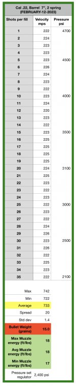

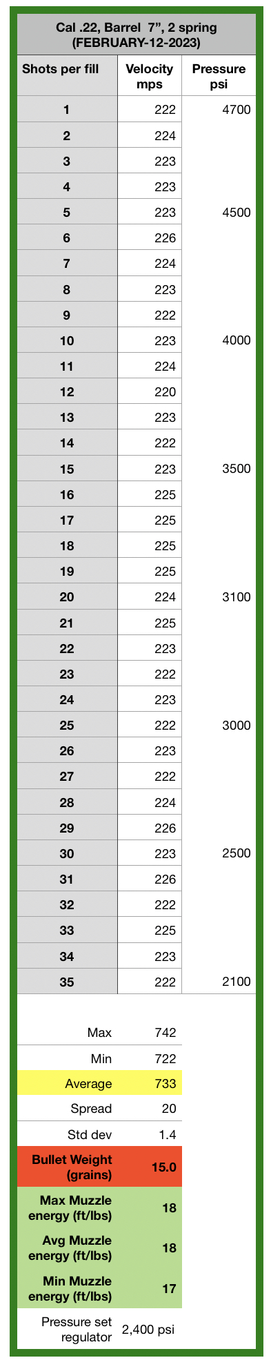

The attached table shows the pistol performance. Please noted the column values are in meter per second. And the result of the data are in feet per second.
To adjust the power the compression spring screw can get the power from 13 fpe to 18 fpe
