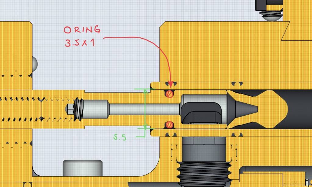

Hello everyone,
Finally I can shoot the Tequila Gun, I can get 19 energy pounds, using a 7 inches barrel and regulated to 1,700 psi. It is very noisy but the folding suppressor doing the job and quite it a lot.
Unfortunately the gun has a leak in the pellet probe. But fortunately I redesigned it and I have the concept ready to be fabricated.
The attached pictures show the issue.
The leak is because the 5.5 oring is no sealing the barrel, but I redesigned it adding a bigger and harder seal. Tomorrow I hope start do them.
Regards
Hello everybody,
Answering your questions.
I have not a web site. If the product is successful I will build one, but currently I have not.
I contacted several airguns distributors, I am waiting show to the pistol performance to them. But if no one wants sell my product my goal is sell it by my self.
Now the good news.
The last modification in the probe does not work. Why? Because the high pressure in the barrel blow out the polyurethane seal. I used again the oring but now it is a silicon material instead of buns.

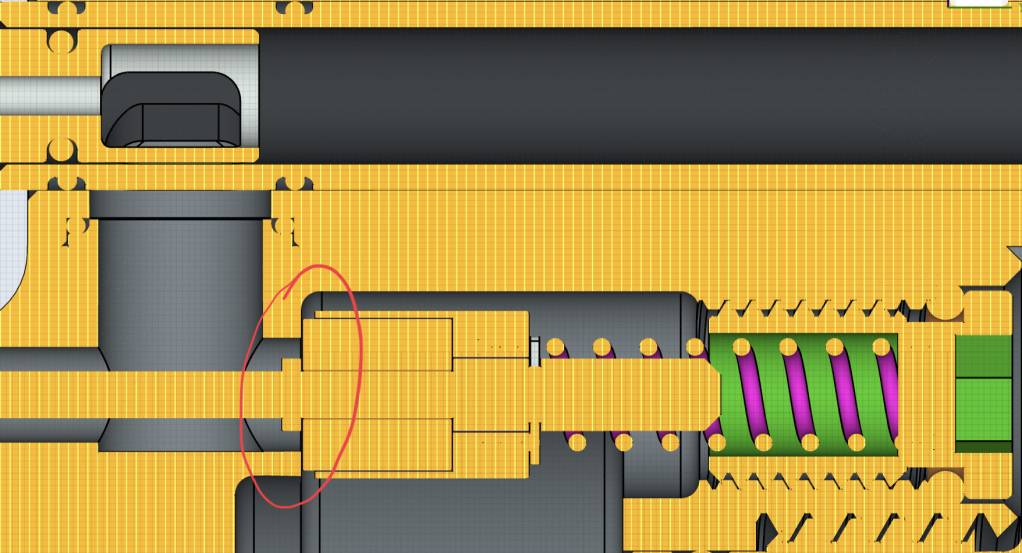

Currently the gun is doing constant 17 foot pounds. The issue of the leaks are fixed. To get a more power I will remove material to the valve probe, this improvement will do the next week. The attached picture shows the current mechanism valve and the improvement in valve pin.
CURRENT
IMPROVEMENT
Finally I can proof the modification but unfortunately it does not work properly. I was trying to reach a 15% of speed increase, but it only increase 2%.
For this reason I moved to other design concept a Balance Valve. This last Monday I stared to build it. As soon as I have the result I will share.

Hello everyone,
Sorry for the lack of communication, but I was working hard to do this Gun safe and functional. I tried the follows to get a high performance product.
1.- Balance valve. It did not work because the limited area to implement it. Only can got 1400 psi until the pressure leaks stars.
2.- Ketron 1000 valve poppet. Unfortunately the limited area and small diameter of the spring used to close the valve was impossible get a safety seal. I need a very strong and small spring to work properly.
And finally
3.- Developed a very strong and safety poppet valve using polyurethane. It was successful and is the current design used in Tequila Gun.
In a few days I will share the progress and finally specification of the gun and a video showings the performance of it. Also the orders to buy it will be open.
