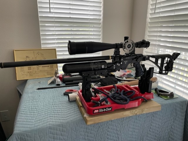

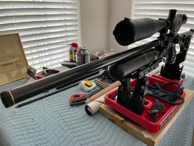

I just received my Ernest Rowe / Bulletcentral.com Crown tensioner/shroud for my 600mm Superior Barrel. It is a true work of art, with gorgeous carbon construction! As you might imagine, this setup is much heavier than the superlight barrel that comes on the Crown...I have the 700mm Superior barrel as well but waiting for the 700mm shroud/tensioner system to come available. The assembly is very stiff once installed. These are available at www.bulletcentral.com but you'll need to call for the Crown version since they are still receiving components and putting the Crown bits together. Chris and Zach were very accommodating (I called every day for 2 weeks :)).
The current setup is using the Impact Superior 600mm barrel with the tensioner and shroud installed as depicted in the pictures below. There is improved accuracy with this configuration and in the near future, I'll post pictures of the groups comparing the Superlight vs Tensioning system results. I'm preparing for AOA/EBR now so more to come there as well and this will be the setup I'll be using in the One Gun Challenge this year.

The overall quality and appearance of the shroud/tensioner system is very nice, you will be very happy with the performance and quality of the product.

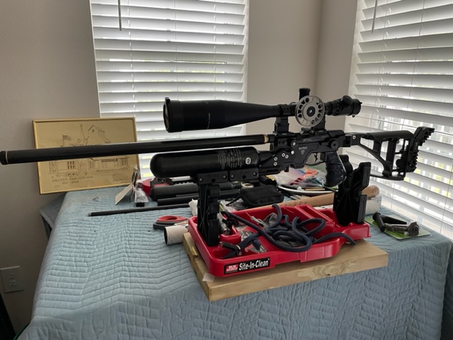

The tensioner system sold by BulletCentral is designed for the Crown. The Crown system requires you to upgrade the barrel to an FX Impact 600mm barrel and then the carbon fiber sleeve and tensioning shroud slides over it. It's very effective and improves accuracy if that's your goal. I've attached a picture of mine with the system installed. I recently installed a 20mm heavy custom barrel and it's very accurate so I may be selling the barrel, sleeve, and tensioner. It looks really good when on the gun. It's bolt-on, so very easy to swap out.

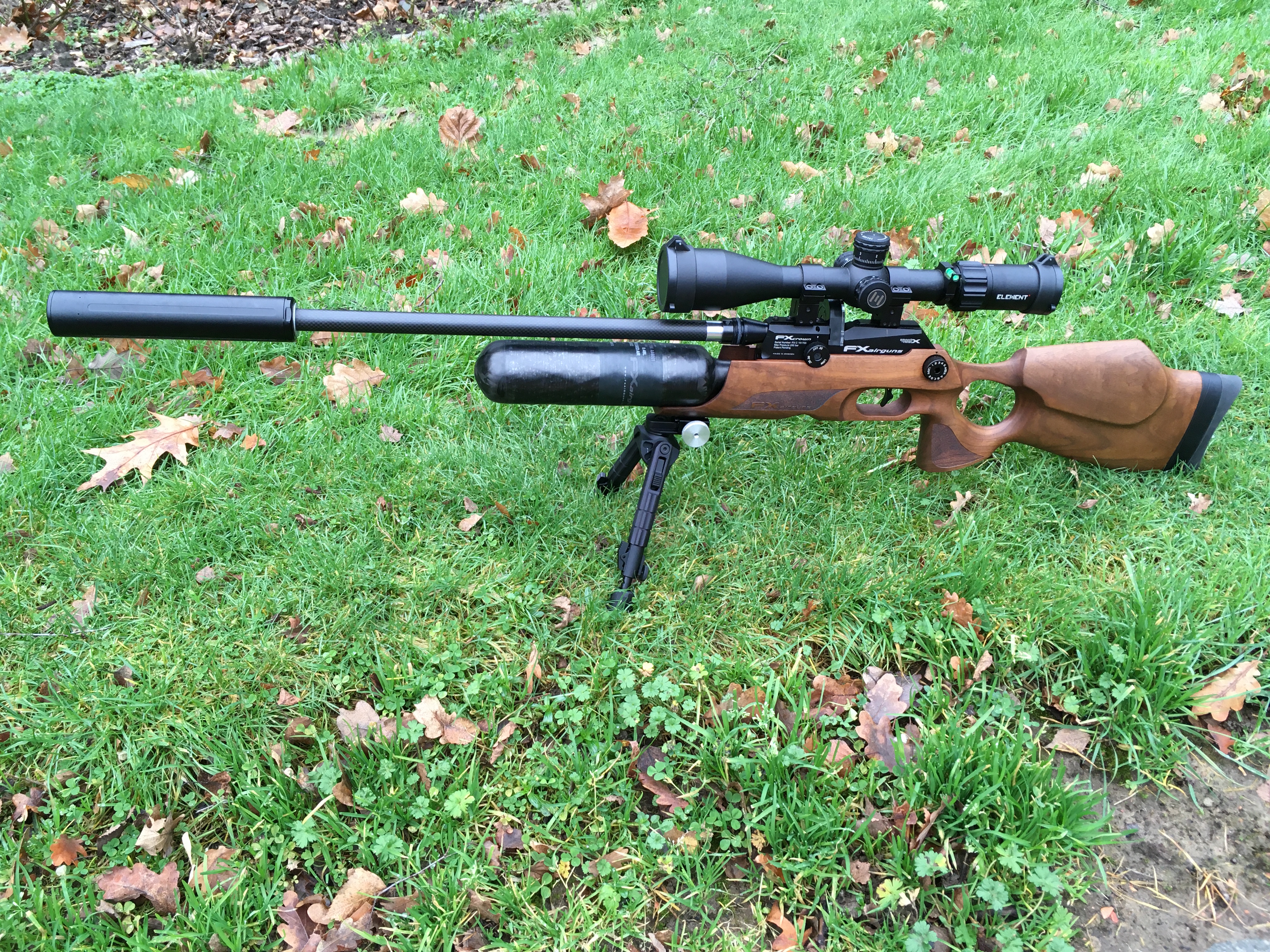

This is a pic of the Crown with CF sleeve and aluminium insert
