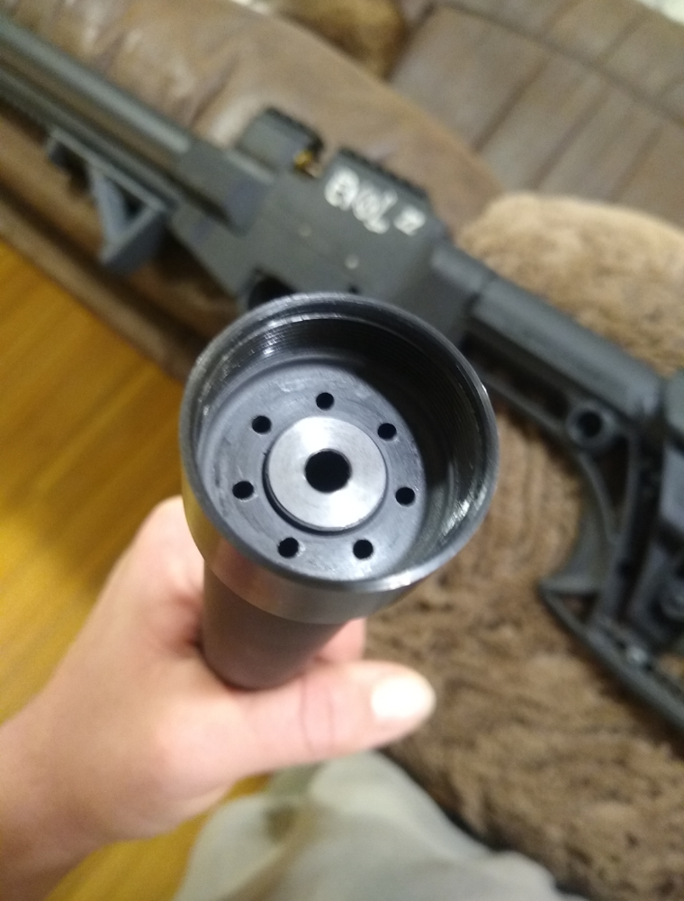

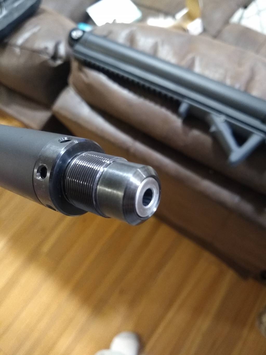

I tensioned the barrel on my Impact within an hour of opening the box it came in. The little white dots are so I can put the exact same tension on it every time I take it apart for cleaning. Change the tension change the tune and I don’t want that. I will clean up the design if I am satisfied with the results.
