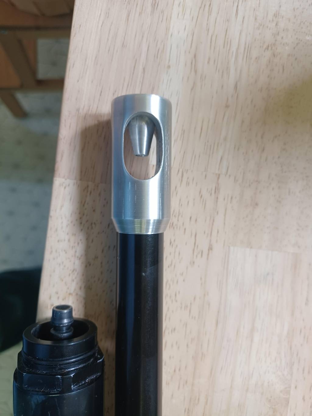

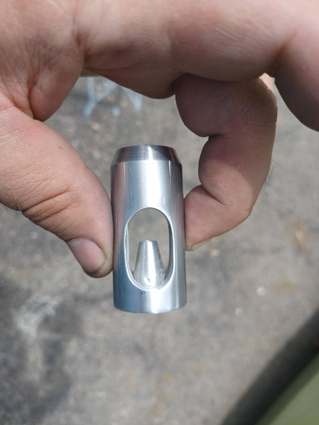

Tensioned barrel nut with built in air stripper!

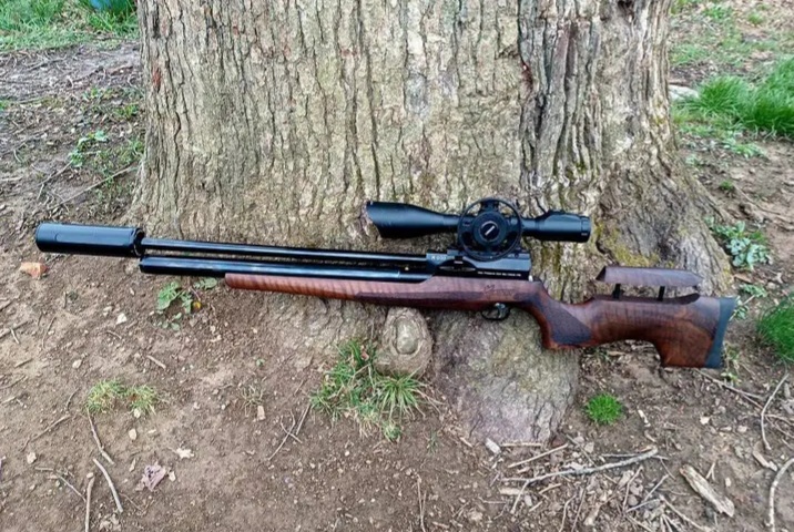

I've never claimed to be a machinist and my lathe and mill are both manual but still fun to build on. May not be the prettiest but hopefully very functional. Going on my HFT rifle.
Lightened the hammer to 35g with a peek striker. Heavier spring in free flight. Trigger polishing and barrel polishing. Tensioned shroud with airstripper and a Huma reg at 130bar/1900psi.
