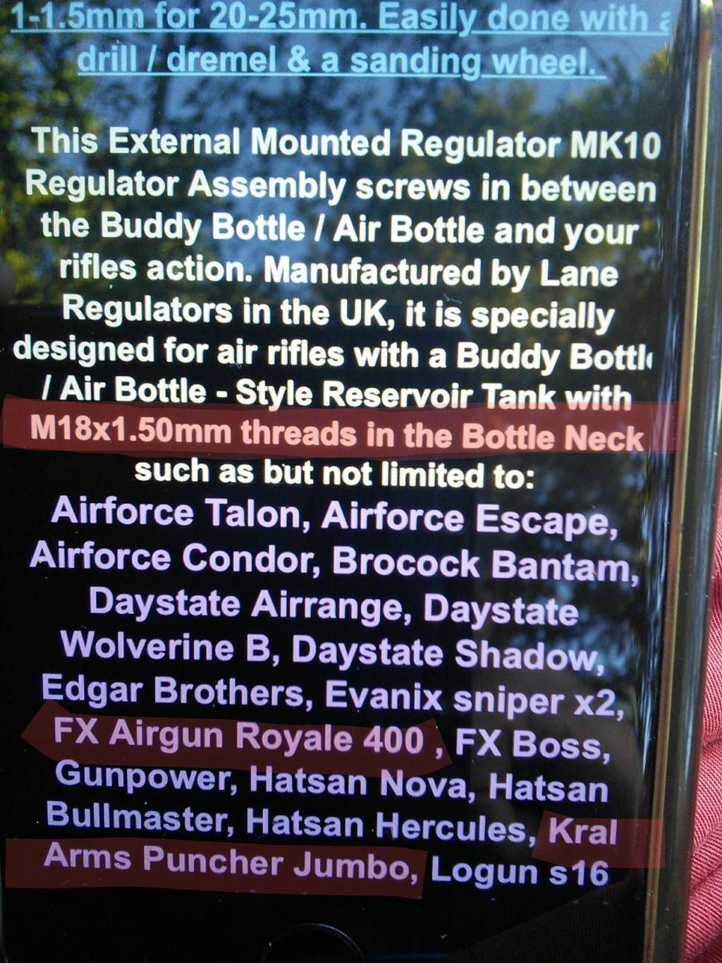

Take a look at the Robert Lane bottle reg as well. Excellent build quality at a good price.
