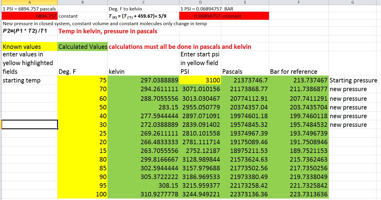

Everything you need to calculate pressure/temp change in a closed system.
