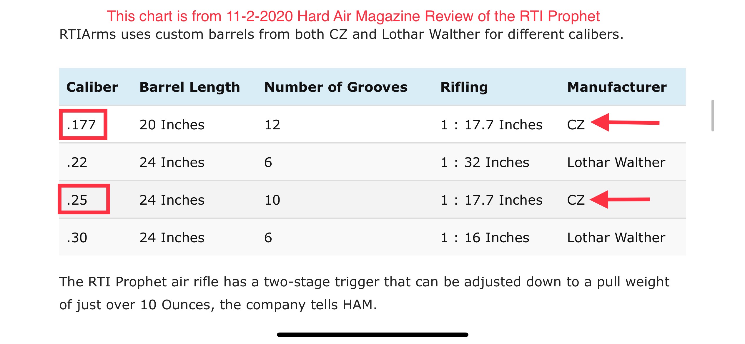

I’ve had RTI’s since they were invented. I’ve had every reg they ever made. This latest version is pretty good. Like almost all regs, there are things you can do to make it a little better if it’s throwing off your first shot of the day. I rest my cheek right behind the mag. If my mag is rotated because it got bumped, yes, you immediately know it. But I just swing it back over to the right with my cheek if I’m in the process of drawing down on a critter. I won’t touch on ergos or sharp edges that bother some because that’s all personal stuff. What I will talk about the .25 CZ barrel. It’s a better pellet shooter than the RPB in the same length. It’s not a slug barrel. But the 500mm RPB is only a so so slug barrel. The main thing with the gun is getting a comfortable butt pad. Get creative and you’ll like the gun more. What the gun comes with is just sheer laziness.
