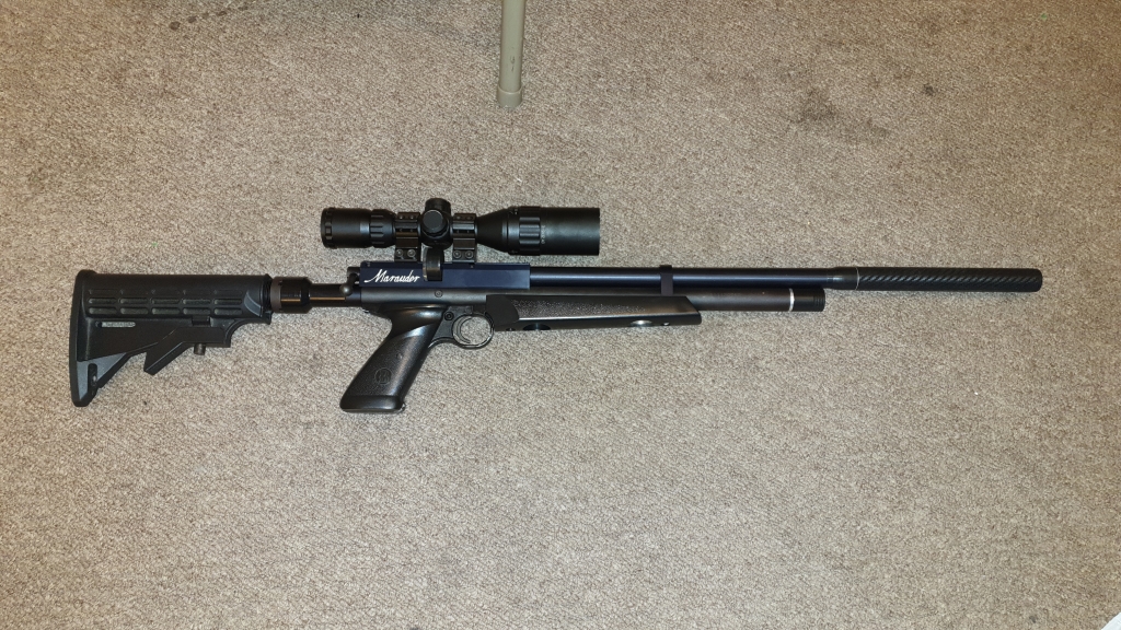

I have one, it is significantly louder than the .177 Marauder (I have a gen one .177). I get about 24 shots out of it per fill, I turned it down a little in velocity. I added a TKO mod to it, it is quite a bit quieter, still not as quiet as the marauder. I find the p-rod to be pretty accurate, but it isn’t as easy to hold steady as the rifle. A lot of guys in forums have gone to LW barrels, and I considered it too, but don’t really shoot it much beyond 25 yds. The OEM stock extension is not solidly attached, and until you realize and compensate for it in the hold, it can affect accuracy. The kit to add the AR butt to it is not without issues as well, it attaches to a part that slips in and is held with one screw on body of pistol. Gotta watch that as it affects POI if it gets loose and took me a bit to figure it out. I put a Hawke 2X7 Airmax on it, has worked out well. I also tried a UTG 1.25-4X LER pistol scope on it, I noted that there is a little muzzle flip shooting without a stock or rest. Might just be me...

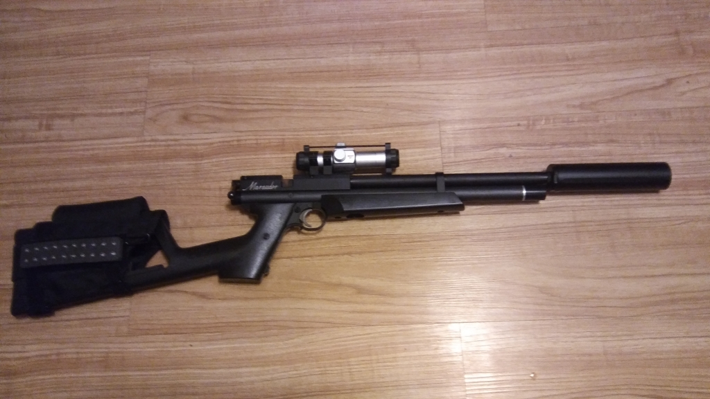

I just picked up one a couple weeks ago. Definitely fun to shoot. I just shot 20 pellets, 2700 psi down to 1900, so I'm thinking 30 shots. Have not had time to put it over the chrony so I couldn't tell you how fast it's shooting. As far as how loud it is, well it does have a snap. I put a Sumo on it from Donny and now it's unbelievably quiet. Down side I have to remove the moderator to fill the gun. Could have went with a different one with a tapered end cap to alleviate this but I like this set up. Went with a SP1 red dot from Millet, found it on Craig's List for 10 bucks. Really like it but will probably get replaced with a 2x20 pistol scope eventually. Guess they upgraded the trigger recently, you can alter weight, first stage, switch to a single stage. Vast improvement over the original like a buddy has. As far as the stock.....like most say, it needs improvement. I ordered a cheek rest made by Voodoo Tactical off Amazon for under 15 bucks with free shipping. After a couple hours of farting around with it I am satisfied with the stock and cheek rest. Accuracy is pretty darn good for a 12' barrel and a red dot. I made my own single shot tray, it and the magazine work flawlessly. $329 at Joe Bob Outfitters, free shipping, make sure you go on their email list first so you get the code for a free t-shirt. GET ONE.

I also have an AR stock adapter on my Prod. A word of warning. Tune your Prod "BEFORE" adding the AR stock adapter. Most of them are secured to the Prod by using the threaded hole in the rear of the air cylinder where you insert the allen wrenches to adjust hammer throw and hammer spring tension. If you put the stock adapter on first, you will just have to take it off each time you want to adjust the gun.
