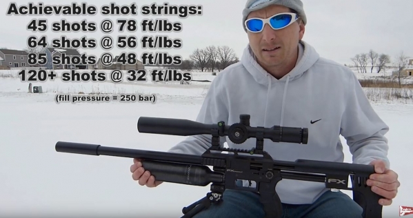

"Frank2533"How does your impact get 70-75 shots with the 34 grainers. My gun is being tuned by earnest. He has it at 845-850 Its getting 40 shots on the reg. Ernest just text me with shot count. I would love to know what you do to get such high shot count.

Well to start he claims 70-75 shots in his video on how he won extreme benchrest. Second 56 ft lbs is 860 Fps with 34 grainers. 64 shots at that power setting cant be done. My gun tuned by ernest rowe the best tuner around shoots 845 to 850 with around 45 shots. If his information was correct i would be getting somewhere around 70 to 75 shots. Clealry cant be done. If theres anybody that would know it would be ernest. Im pretty sure his berral he uses is longer than stock. Thats the only way it would make since.
So 96 divided by 2 is 48. But then he says when he starts shooting that he shoots 16 shots then changes to his other tank thats filled to 250 bar. From there he finishes off his 96 shots. And if yout do the math that would be 80 shots on his last tank. Lol thanks for bringing this up that makes even less since than his claim of 70 to 75 shots. Unless he just fills his gun up again towards the end of his 96 shots.
Hi Frank, he didn't say that. As he said at the end he was doing anothers 32 shots groups so that explain why the tank was with just 16 shots left in my opinion. It's all suppositions of course, but i think it's more likely that those shots were shot with both tanks, i mean, 96 shots isn't a random number, if he was able to shot even more he would shot 100 for a more atractive number. And sorry for the math b.t.w, it seems that something failed in my brain for a moment haha
