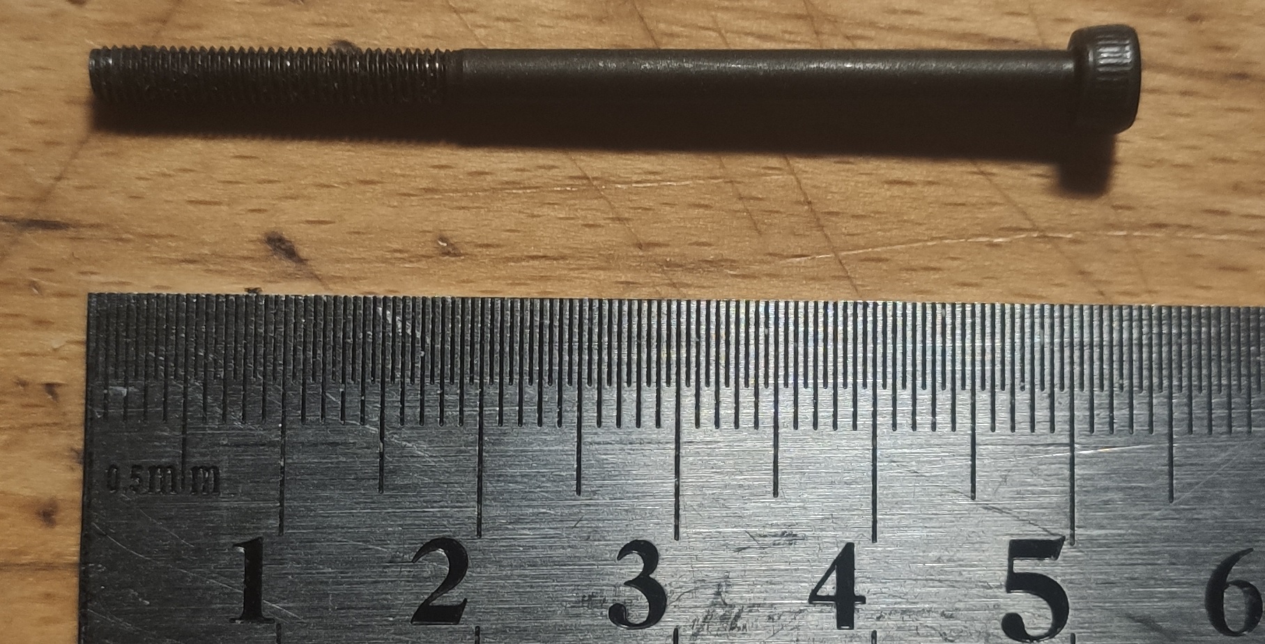

The click ball on my hammer spring adjuster have a tendency to back out, so need to put something on the grub screw thread to "lock " it in place.
PS: the guy pushing out the cross pins in the cocking linkage, there is a reason they are threaded and the rifle come with a long 3 mm bolt, you insert that / screw bolt into the 2 cross pins in the linkage and fish them out the hole in the top.
I would not use names here CUZ it also took me a little while to figure out what the hell that long 3 mm bolt was for.
