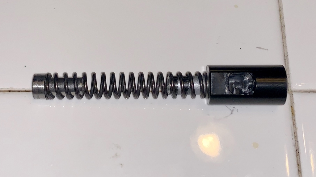

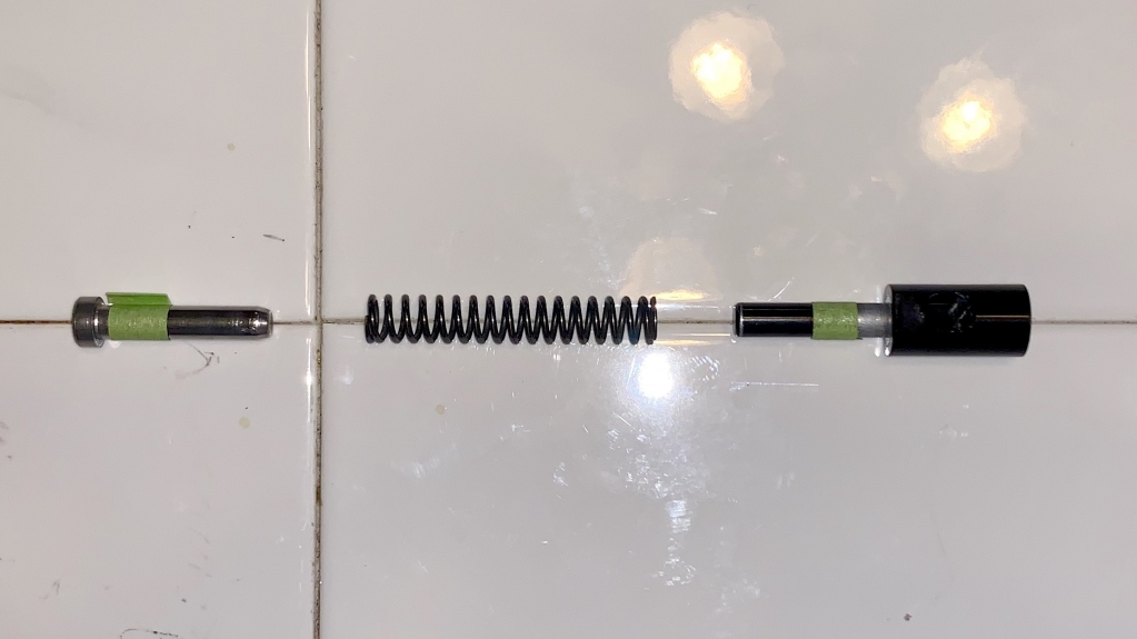

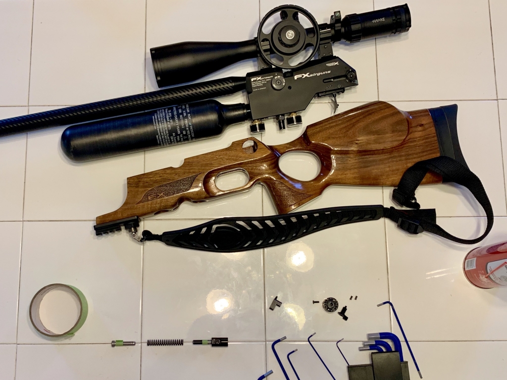

Thanks for the reply. I have looked at all of your posts but have not found the weight of your hammer weight mod. Do you know what that is off the top of your head?

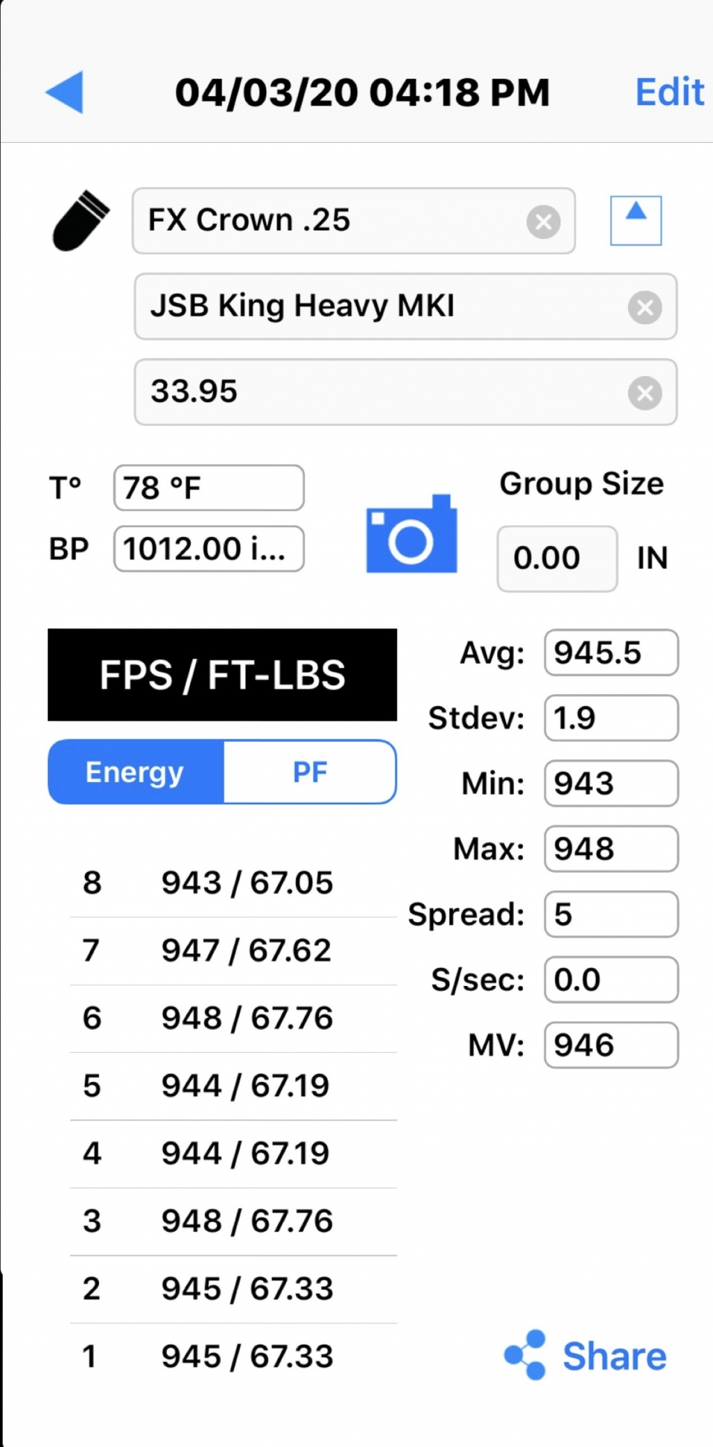

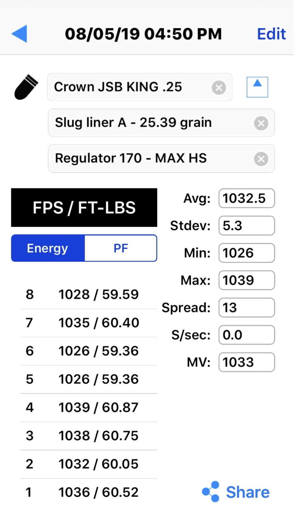

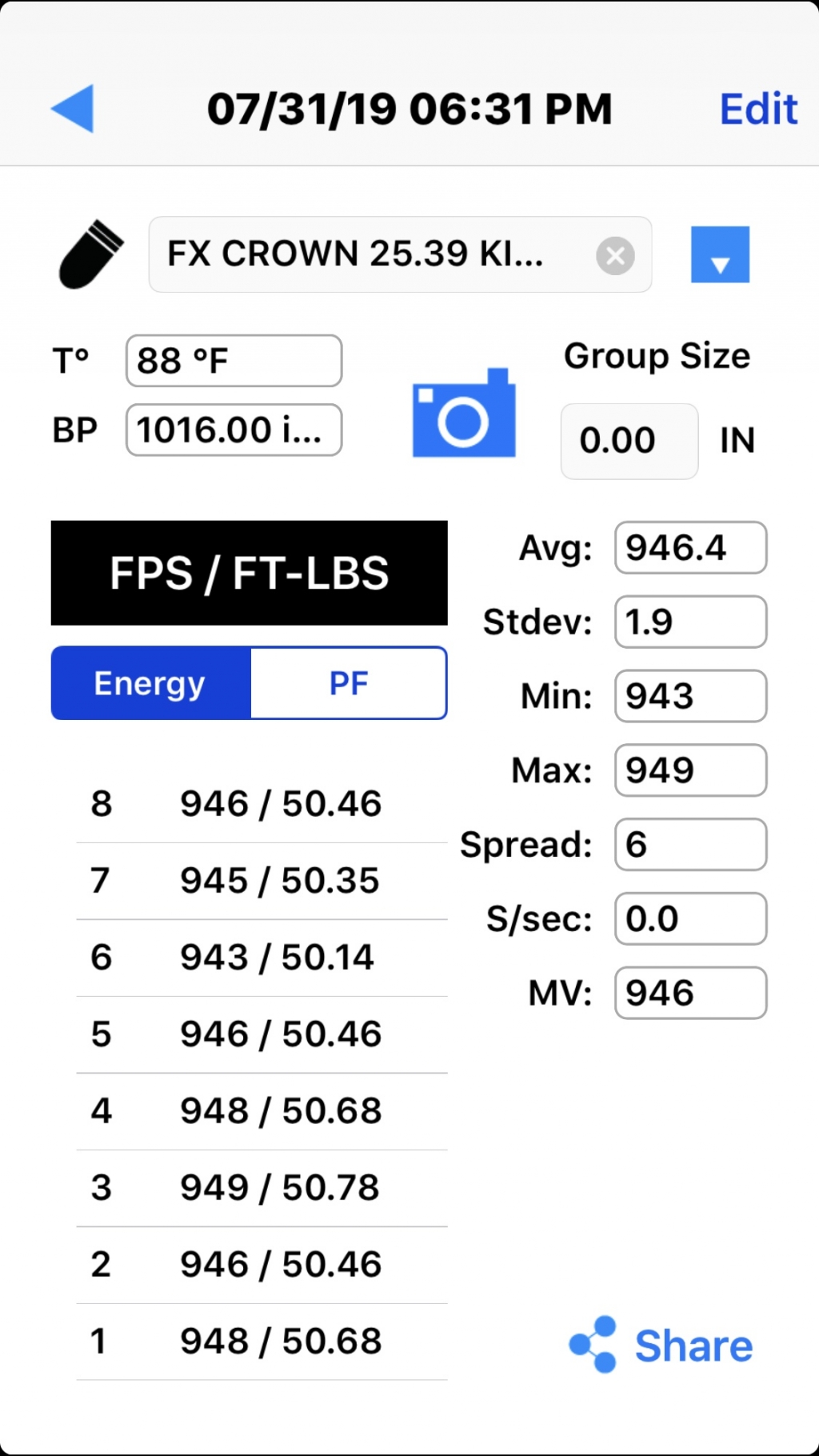

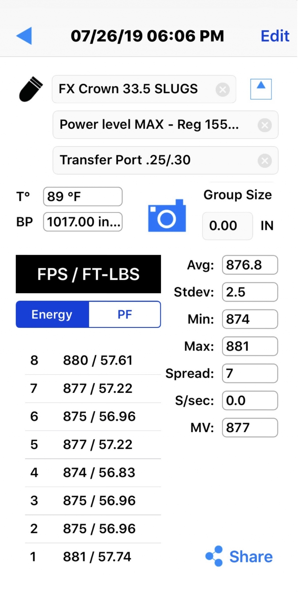

My numbers are pretty much the same as yours, so it is good to have someone with the same caliber to compare with.

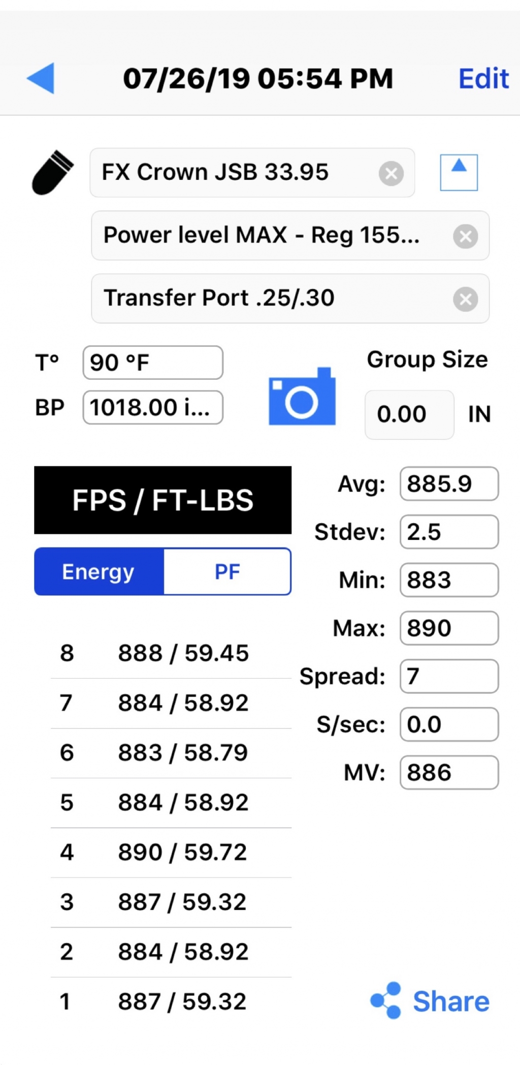

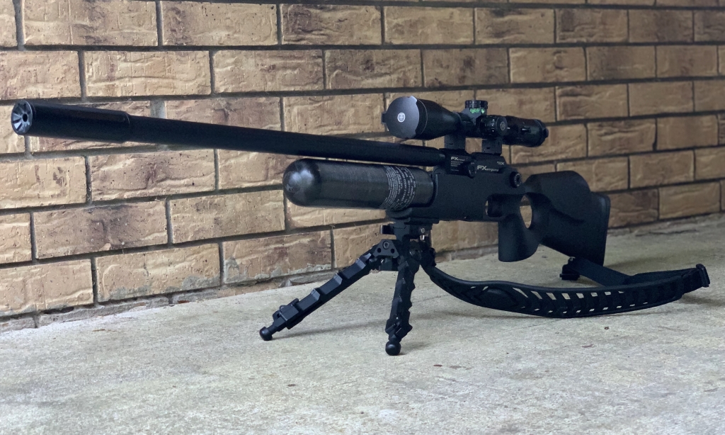

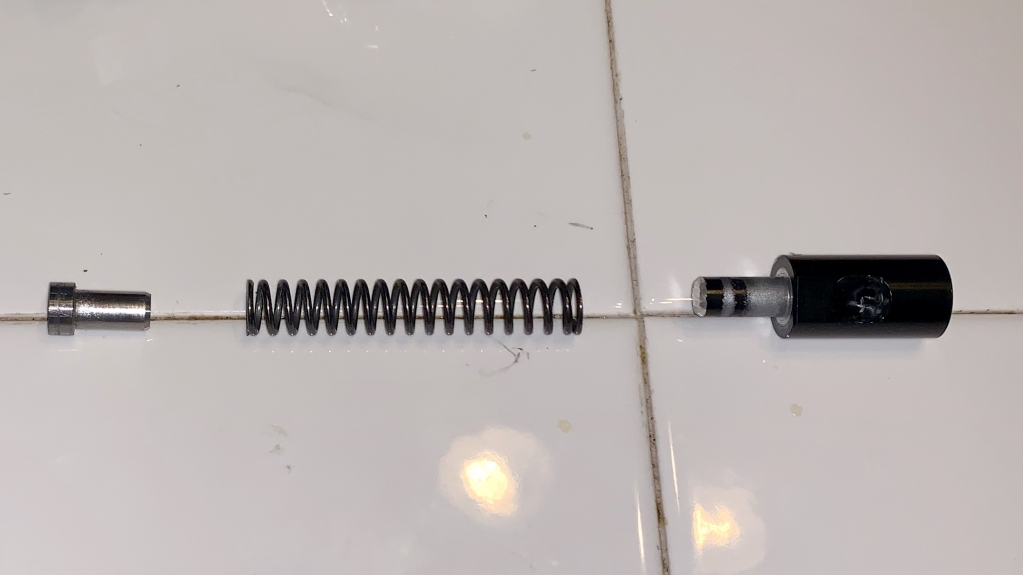

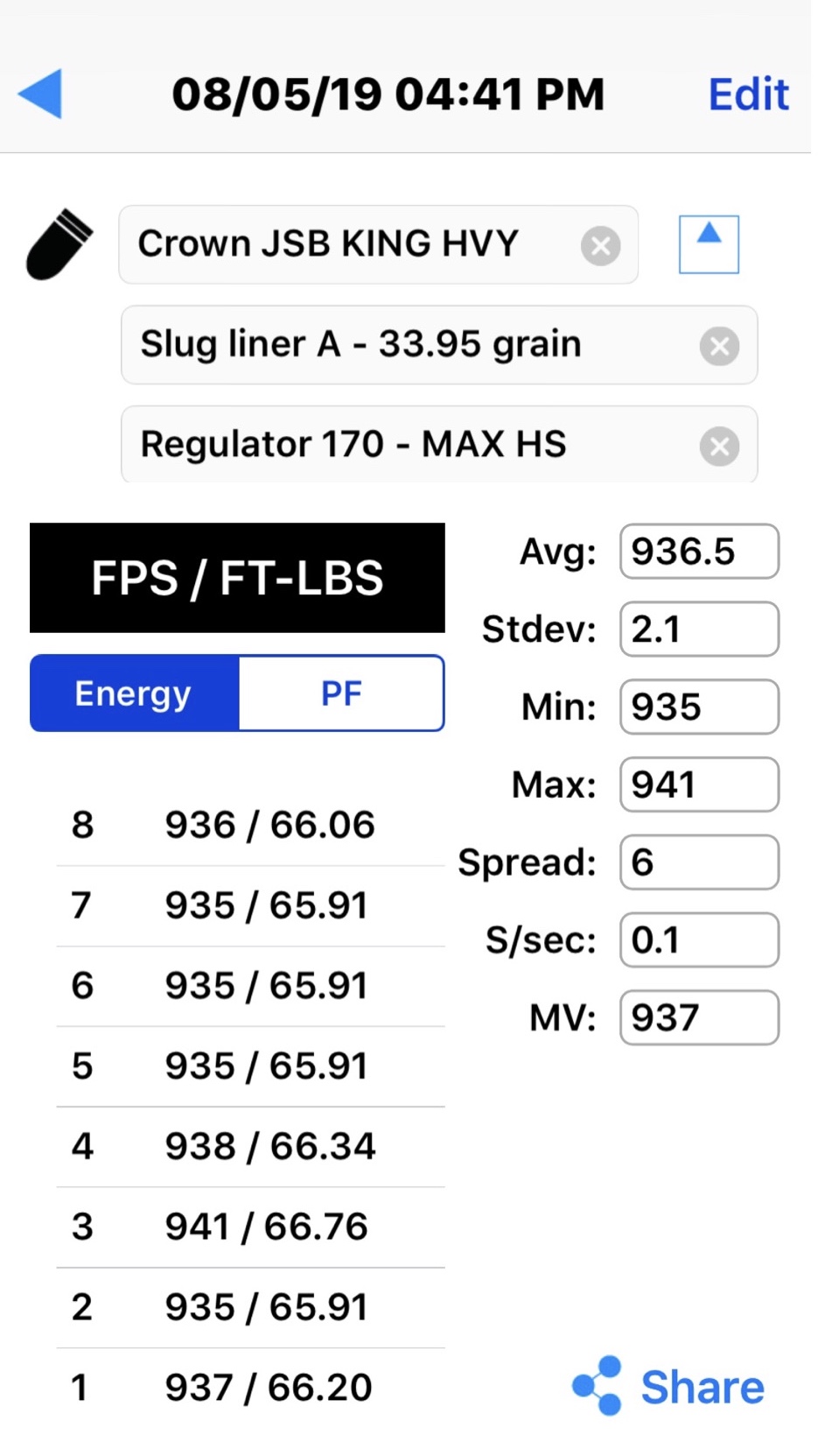

My hammer weight is 7 grams and it certainly has enough to open the valve. I had to back the spring tension down a fair ways to find the best tune, so I feel there is more ooomph in it if I want to go up in pressure. I ordered the Huma spring washers to take my reg up to the extra high range and when they get here I will install them and then at least I can push up the pressure if need be. I am also waiting on a 6.3mm valve seat. Would you say that the valve seat made a big improvement for you? I am hoping to get up around 80 FPE eventually, but am at 66 FPE now.
How many shots do you get per fill where you are tuned now?
