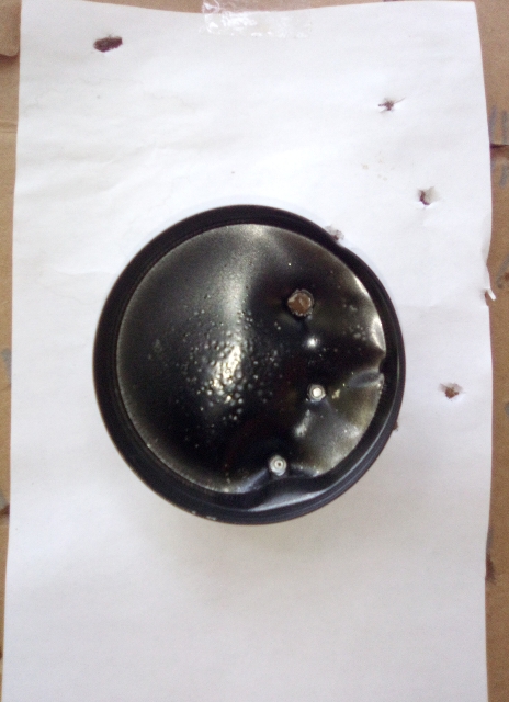

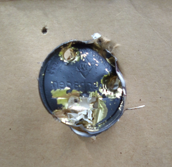

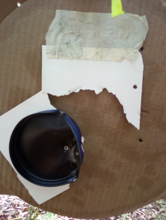

200$ and 50y. A sub $200 hatsan 95 is capable of that.. heck ithas done 100y with walmart cphp. In .22. And thats with factory open sights no optics or peeps a 50 and a 100y box stock.
My gamo whisper fusion mach 1 .22 is a bit better at $225.
Oh, hetes a 100y hatsan 95 with crosman parahans .22 opensight
Ots you get a good gun at any price and then be able to shoot one .
