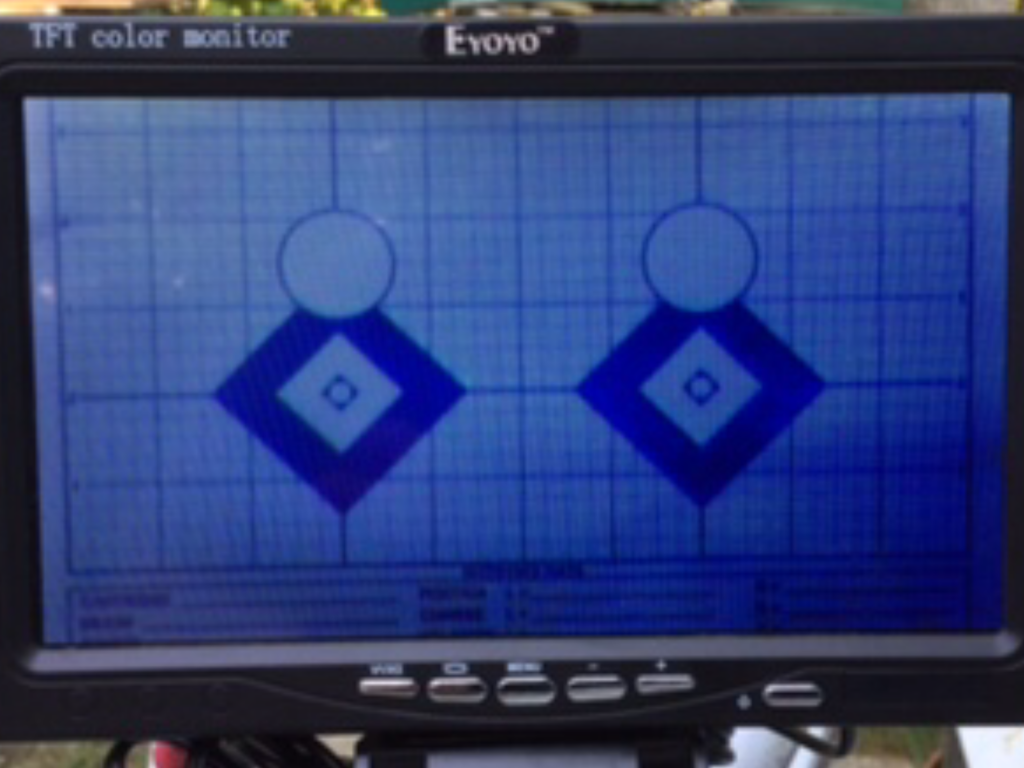

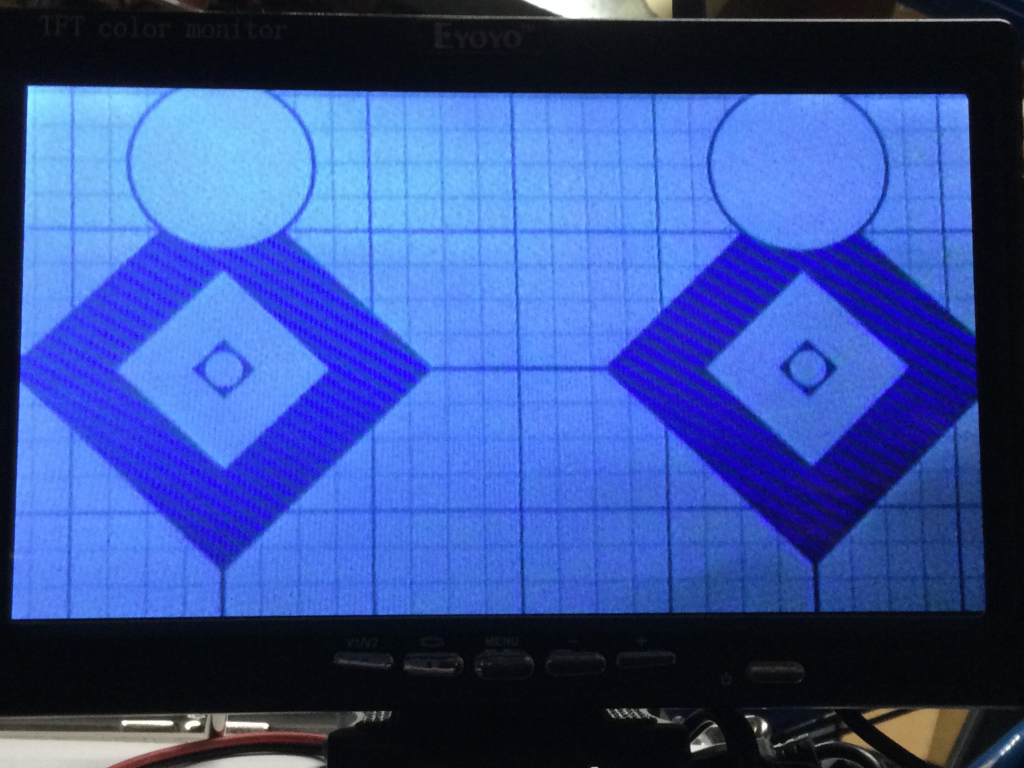

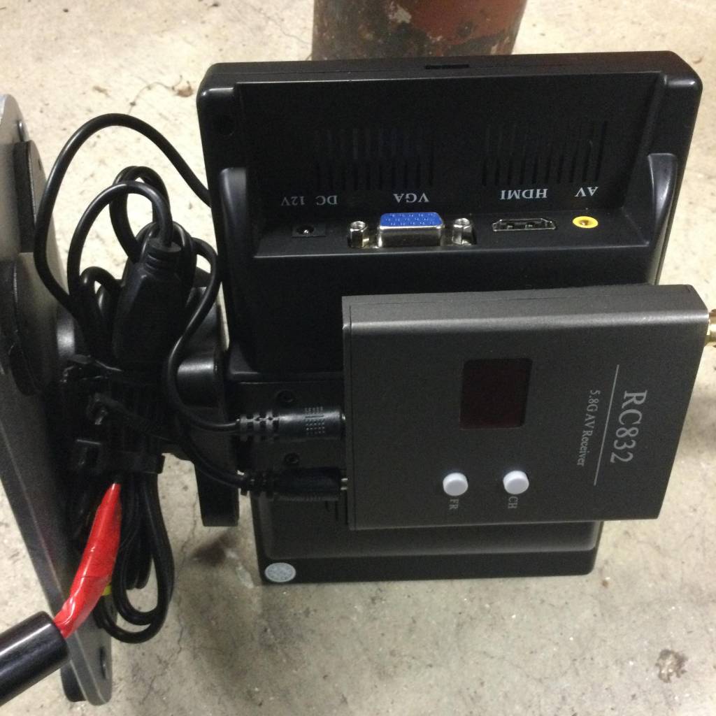

I wanted to post a couple pictures showing the difference between my drone camera and camcorder. Both pictures are taken looking at the 7” screen of my monitor. This is a back up camera like the one in the kit posted above for $60.00. The top left is the camcorder placed about 20 feet from the target and zoomed in. The picture on the right is from my drone about two feet in front of target. Without a zoom feature on the drone it needs to be placed way too close to the target and could be damaged from a bad shot. Some drone cameras may be better than others but I don’t think there are too many with adjustable zoom. I will set my camcorder about 30 feet from target and zoom in. The bottom picture shows the back of the monitor with AV /HDMI/ VGA and RCA inputs.
... the camcorder placed about 20 feet from the target and zoomed in. ....The bottom picture shows the back of the monitor with AV /HDMI/ VGA and RCA inputs.
The first picture quality is not bad. I think I will order the same kit from aliexpress asap, I don't want to loose the Chinese shipping as well.
I am building my own "one-piece-rest", as I can see from the back of the monitor screen I will need to design a bracket for it to mount...not a big deal.

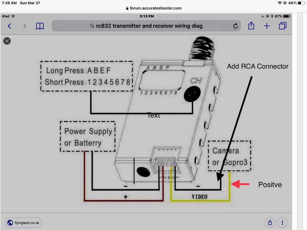

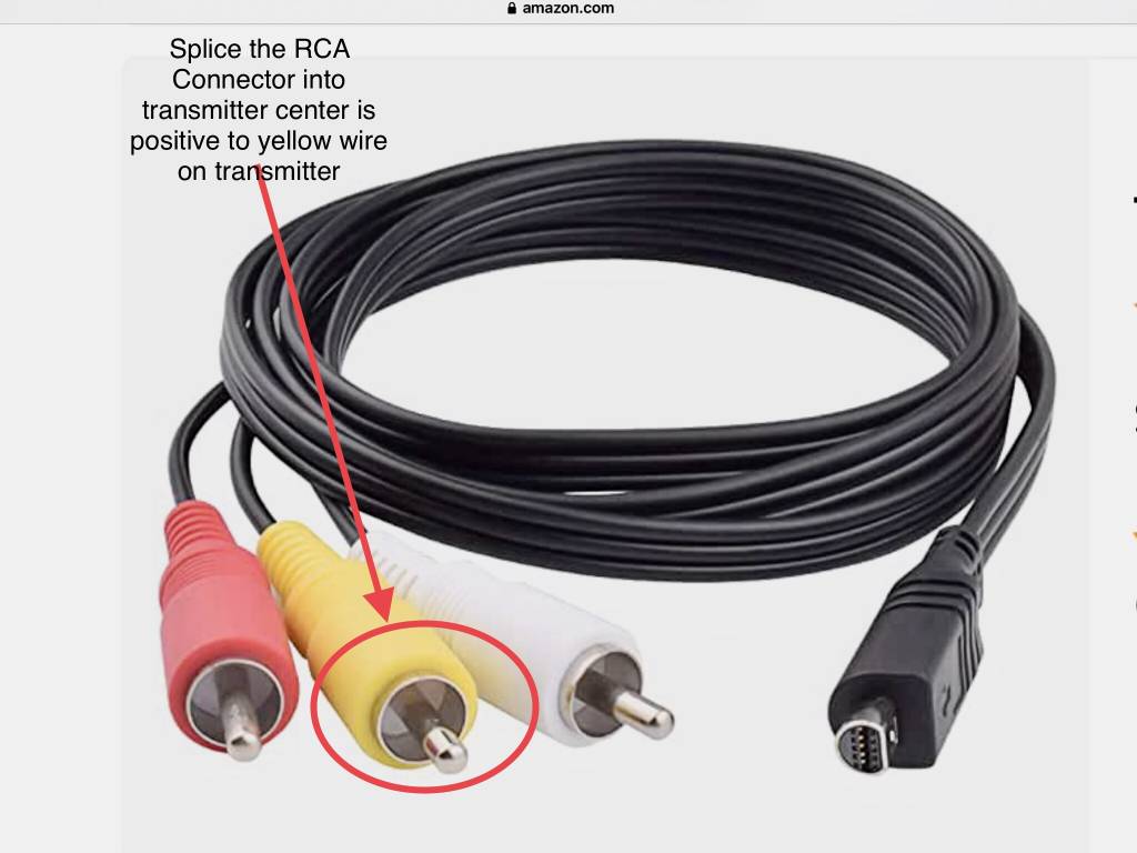

you can find a camcorder cheap on ebay. Then either splice the yellow RCA connector or solder on a female RCA connector to transmitter. Here is what the cable looks like for a Sony camcorder. Buy the kit from China which includes everything and replace the camera with camcorder.
