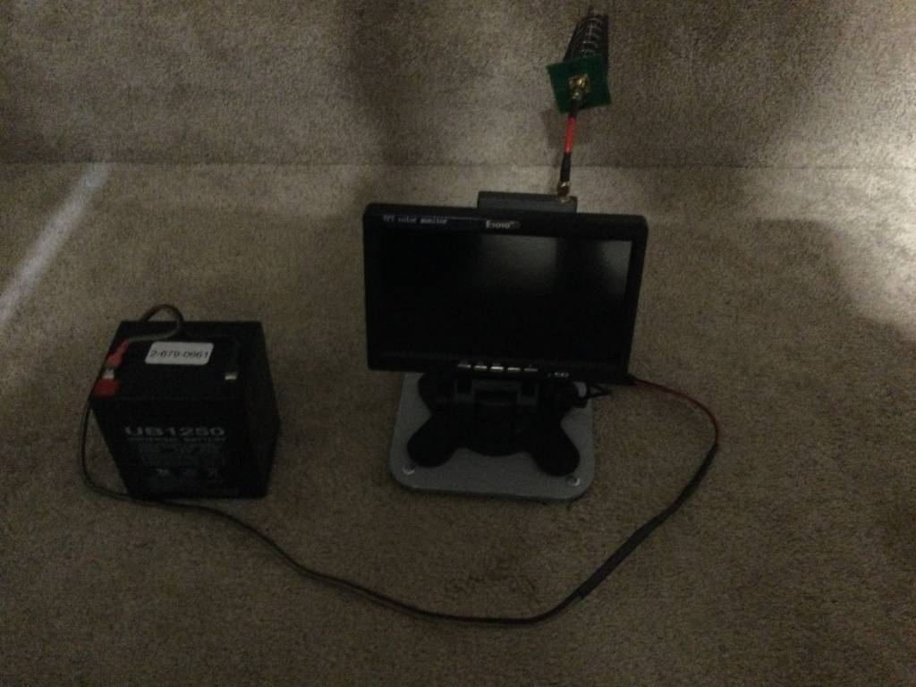

    I used these components for my nightvision set up, a few years back, and it werqed great. It would also werq for a remote camera set up if I could ever find the stinking transmitter. I likely put it somehwhere it would be safe and I would remember where it was. ;^)
    I decided to simplify and removed the wireless transmitter and went back to a wired system.
    This is a picture I took of the screen of the DVR. The video should be a bit better as it was taken with the night vision camera with a resolution of 640x480. So very similar but not exactly the same as in the advertisement. My camera was an IR unit and this was taken in 940nm IR light in the pitch black basement, that is why it is black and white.
    Like you I was looking into a regular remote camera system and found this. It is about half the price of what I did years back and should be comparable in video quality.

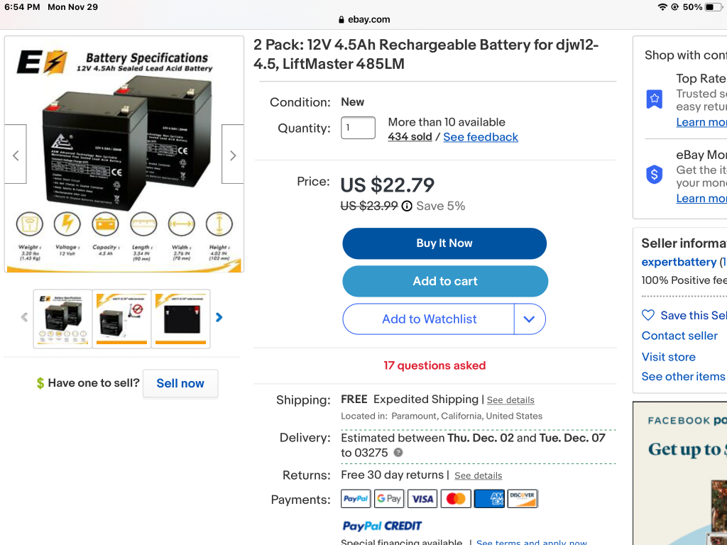

      I use the 12volt lead acid rechargeable batteries. One down range to power the camera and transmitter. The other at the bench to power the monitor and receiver. I’ll place the camera about 30’ in front of the target in a safe spot and zoom in. I have several decent spotting scopes that work when the conditions are good. When the sun is bright there is too much mirage to see bullet holes at 500 yards. That’s why I use the camera setup. There’s no guessing where your bullet holes are. Its just as clear as if you were standing in front of your target looking at it. The reason I run the camera off the 12volt battery (with an adjustable voltage regulator) is because it will run all day. If I were to use the camera battery it would only last a couple hours.

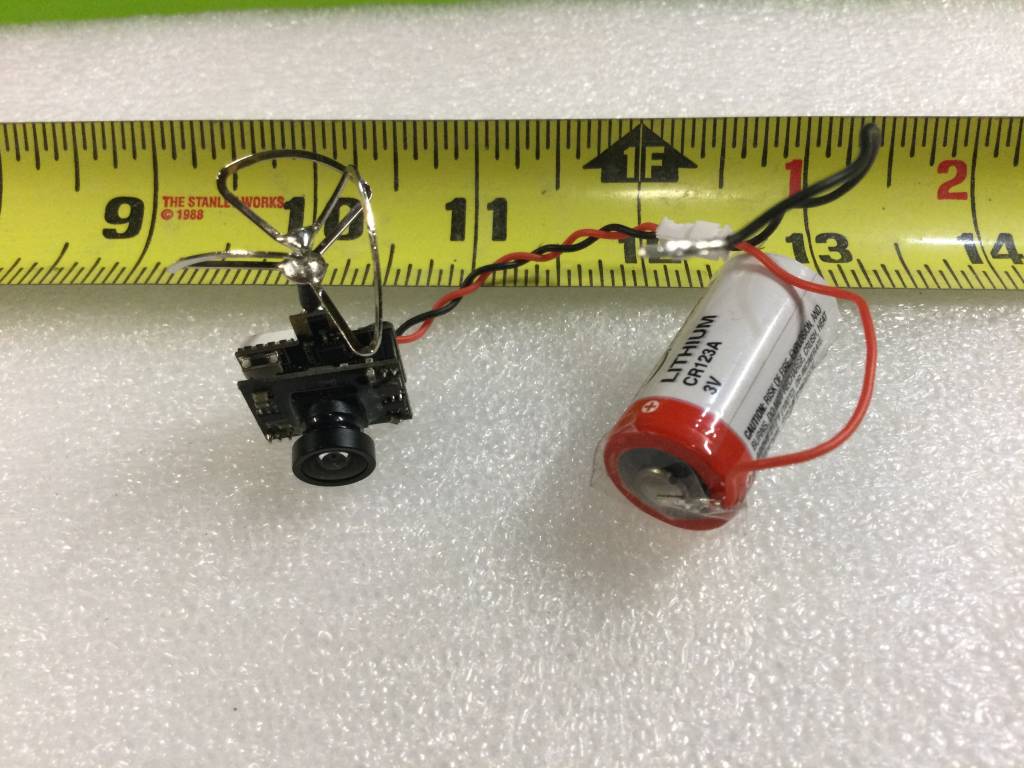

      Also played around with this small drone camera.It transmitted the image fine but without an adjustable zoom the camera would need to be placed about 10 inches in front of the target. Not practical. The transmitter is built into this camera with 40 channels. I think It was just over $20.00 shipped. I was hoping to leave it setup on a different yardage target and just switch channels on the receiving end to view. Not sure if there is any drone cameras with adjustable zoom available that would work.
