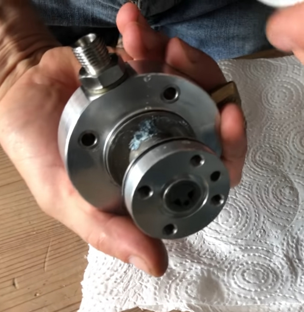

Are you using tap water? This is a photo someone using tap water. I was thinking maybe trying coolant to avoid this.
I have been feeding water to my Yong Heng directly from the tap since day one. Yes, I do get those calcium deposits inside the water jacket. I did not switch to distill water because I want to avoid the trouble of setting up the bucket. My solution is to pour vinegar into the water jacket regularly to remove those deposits.
