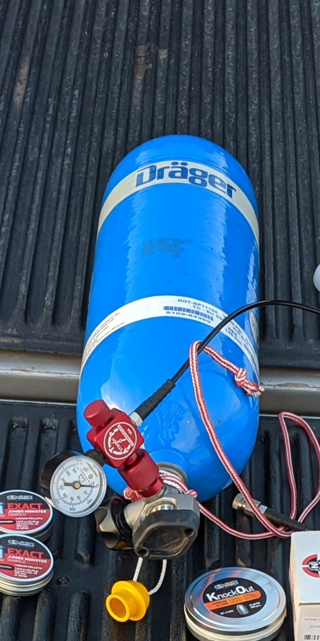

My Drager 4500 (bought from Ebay) expired earlier this year, in May I believe. I'm in no hurry to recertify it, although my local welding/fire supply business told me that they'll keep recertifying it for as long as I want (yes, even past the 15 year "lifespan").
My SCBA looks like it never saw a fire. There aren't any chips, gouges, frayed fibers, etc. ALL of those things would make me reassess my use of this particular tank. As-is this is not something that keeps me up at night.
When I first bought it I had the fire supply place do a visual inspection for corrosion, pitting, etc of the inner liner. They said it looks brand new inside.
I feel good about saving $5-600 bucks, and don't even feel like I'm risking life and limb by doing so.

Just an example of the condition of one of these expired/good for nothing ebay tanks.
I originally was using one of the $40 ebay fill stations too, but got tired of it eating orings so upgraded to the STIK BOY I think it's called.
So, all-in I think I'm a little over $200 bucks for a 60 min SCBA.
