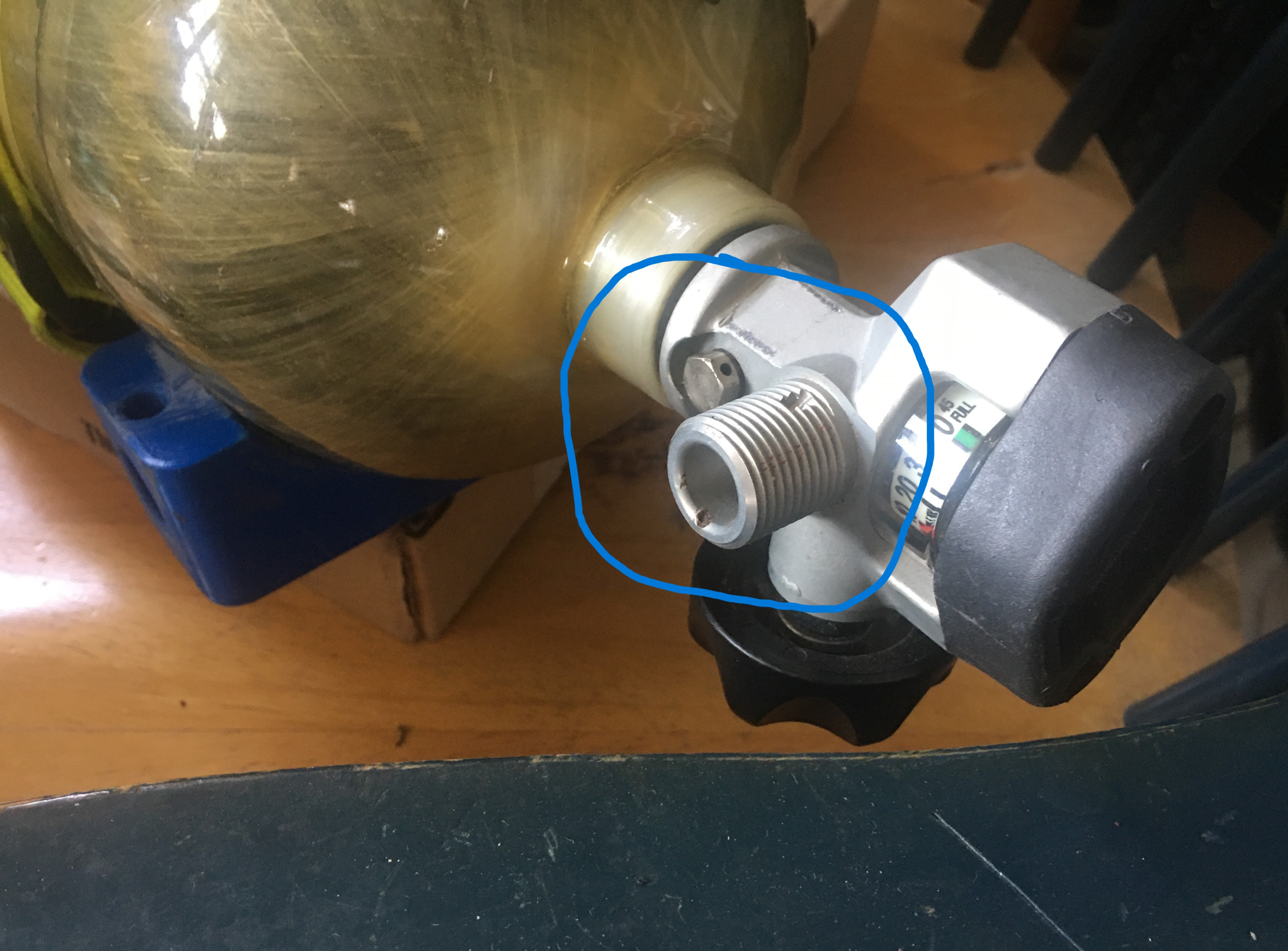

Hello members
I am having difficulty figuring out which fitting (or fittings) are needed to connect to the valve on my Scott 45 minute tank
(see photo)
The O.D on the male output nipple is 0.826" as measured with $16.99 Amazon digital calipers.
The nipple is .690 inches long and has 9 threads
I'd like to connect a QD hose and a bleed screw (or button)
Thanks
Ed
