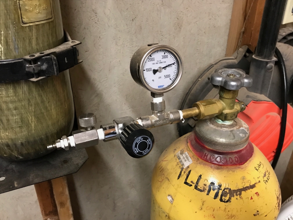

If your using a 6000# steel tank you will need a regulator to reduce to 4500# and a purge valve to dump pressure between the two tanks after fill.
Agree with the bleed valve, but why would he need a regulator? I fill guns and gun tanks to 3000psi from a 4500psi tank without using a regulator, so why would you need one to go from 6000 into 4500? Can't you just open valve slowly and then close when it gets to 4500?
Reactions: Eaglebeak
I didn't see he had a compressor in the question. Yes you could go without a regulator and even with an overfill on the 4500# one would most likely be OK as they are tested to at least the 6000# level but why take a chance. I've been in a room when a 3500# burst disc whent through a very small hole, it blow stuff all over the place and several grown men hitting the deck. I don't think I would want to be around when a tank blew at 4500 plus on a burst disk or worst case the tank letting go. That would be a bomb. I do fill guns with a slow fill to 3000-3600 and even then can fill rather quick from a 4000# plus source and they can jump it pressure very quickly. The regulator would give a margin of safety, needed or not needed.
Don't NEED a regulator but STRONGLY recommend for safety reasons. I've been working with HPAir for many years & have learned it's always best to err on the safety side! A used 6000psi regulator should be fairly easy to find.
Personally I would trust my HAND turning the valve more then I would a mechanical regulator which could fail.
