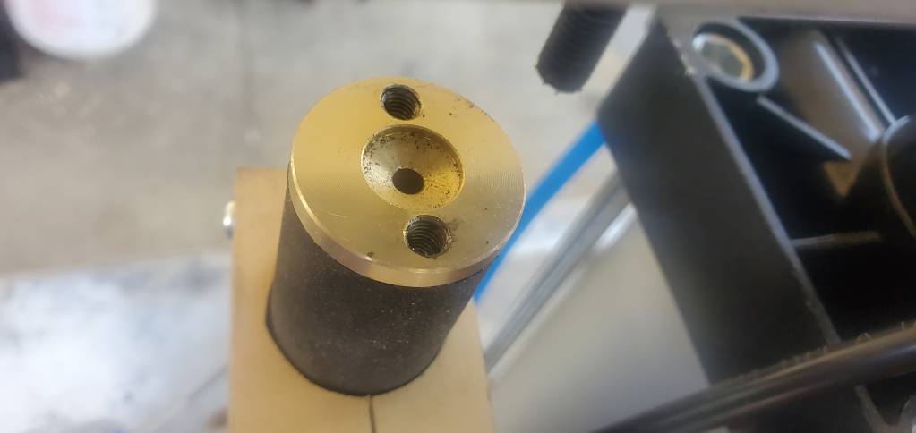

Interesting that you say that because I have done that and will share how I did it. But
Actually what I ment was, on these hand pumps they have a intake somewhere for them. As you normally pump you are just sucking outside air into them, and due to leverage you are multiplying the the starting pressure. What happens if you can plumb the intake so you are starting with 10 or 15 lbs of air? Less pumps to fill the pcp! Another benefit is your compressor probably has a water separator. That air is cleaner and dryer than the air that is normally sucked into your hand pump. But I will warn you depending on how much pressure you put in the hand pump it will increase the amount of effort to pump the hand pump. So play around with the pressures. And no just about anything beyond 50 psi you will not be able to push down.
For example on the top of my hand pump is my intake
You can put higher pressure when the line pressure is low and decrease as the hpa pressure increases

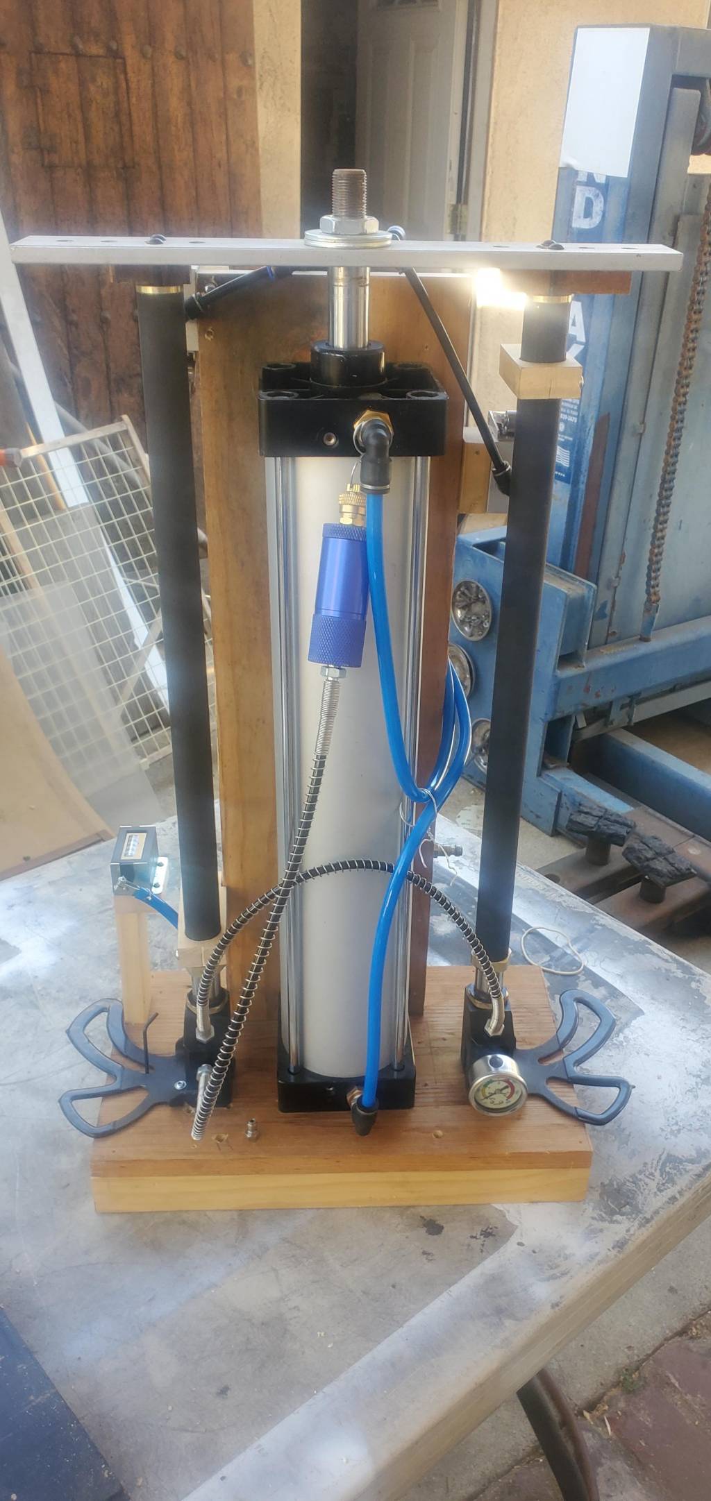

As for using air to compress the hand pump I have done that too. In several configurations, from fully manual with assist (using only your finger to pump hand pump) to semi- automated. I did that with a pneumatic cylinder I bought off of amazon. Actually everything I got for that I got from amazon.
There is a post where i did all this but it maybe a hard read, not much response but i want to kind of chronicle it. Here is one of the most recent pictures is where i use it to pump two hand pumps.
In this configuration it takes about 20 pumps to get my uragan 20 pumps to get from 150 bar to 300 bar and about 27 to 30 to pump my 480cc or 580cc from 150 bar to 250 bar.
Here is the link sorry for long post. If you need clarification just reply to that post or pm me.
https://www.airgunnation.com/topic/using-two-hand-pumps-tethered-together/
