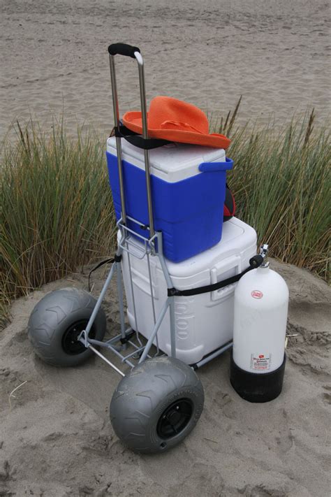

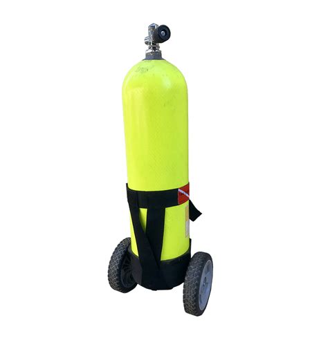

If lazy like me look at the budget wheeled boot ..
When i was diving we made ones with handles . I used a suitcase frame with wheels and the retractable handle that held 2 aluminum 80's and cheap harbor freight handtruck tires .. worked great for shore dives or long dock walks to the boat.
Kinda looked like this for example but just for 2 tanks

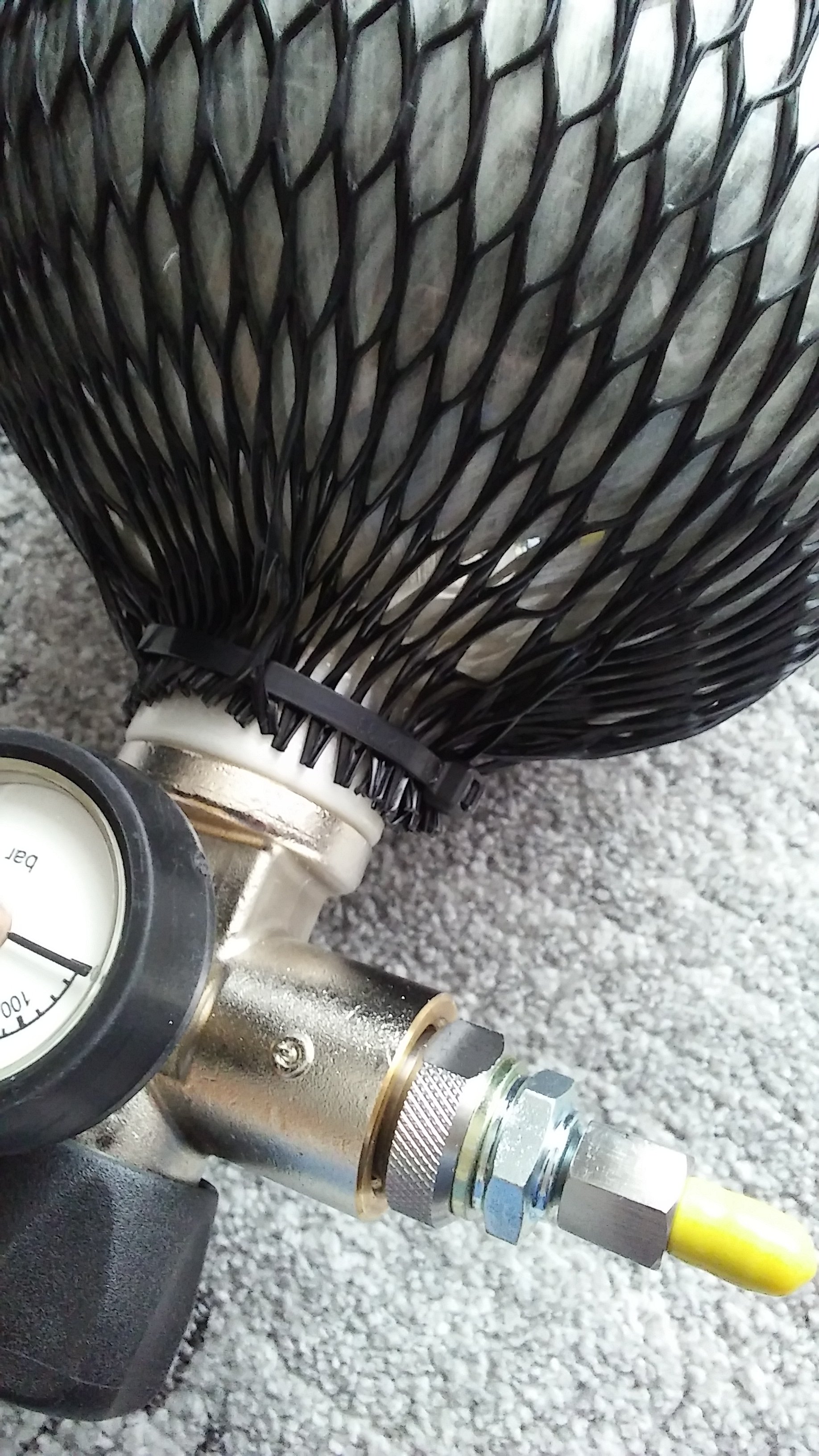

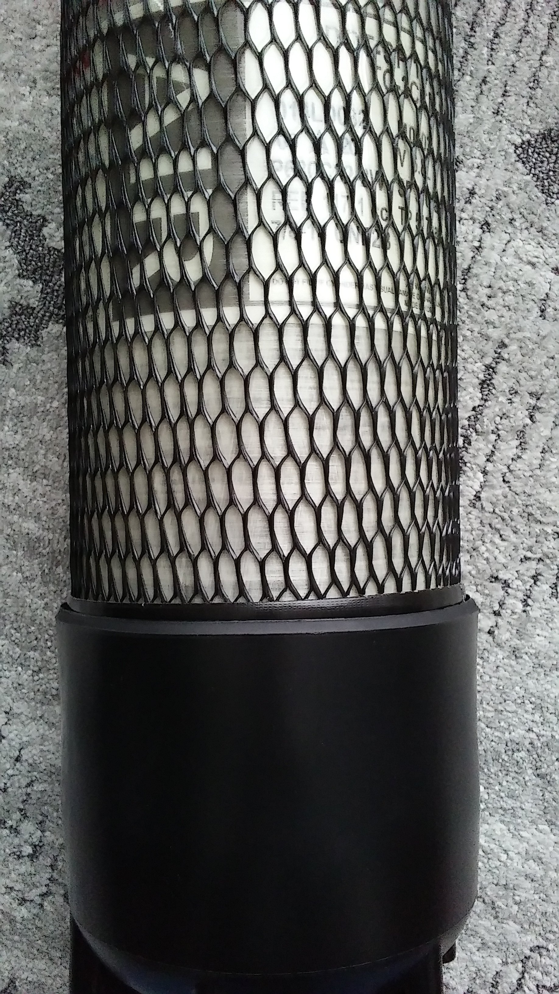

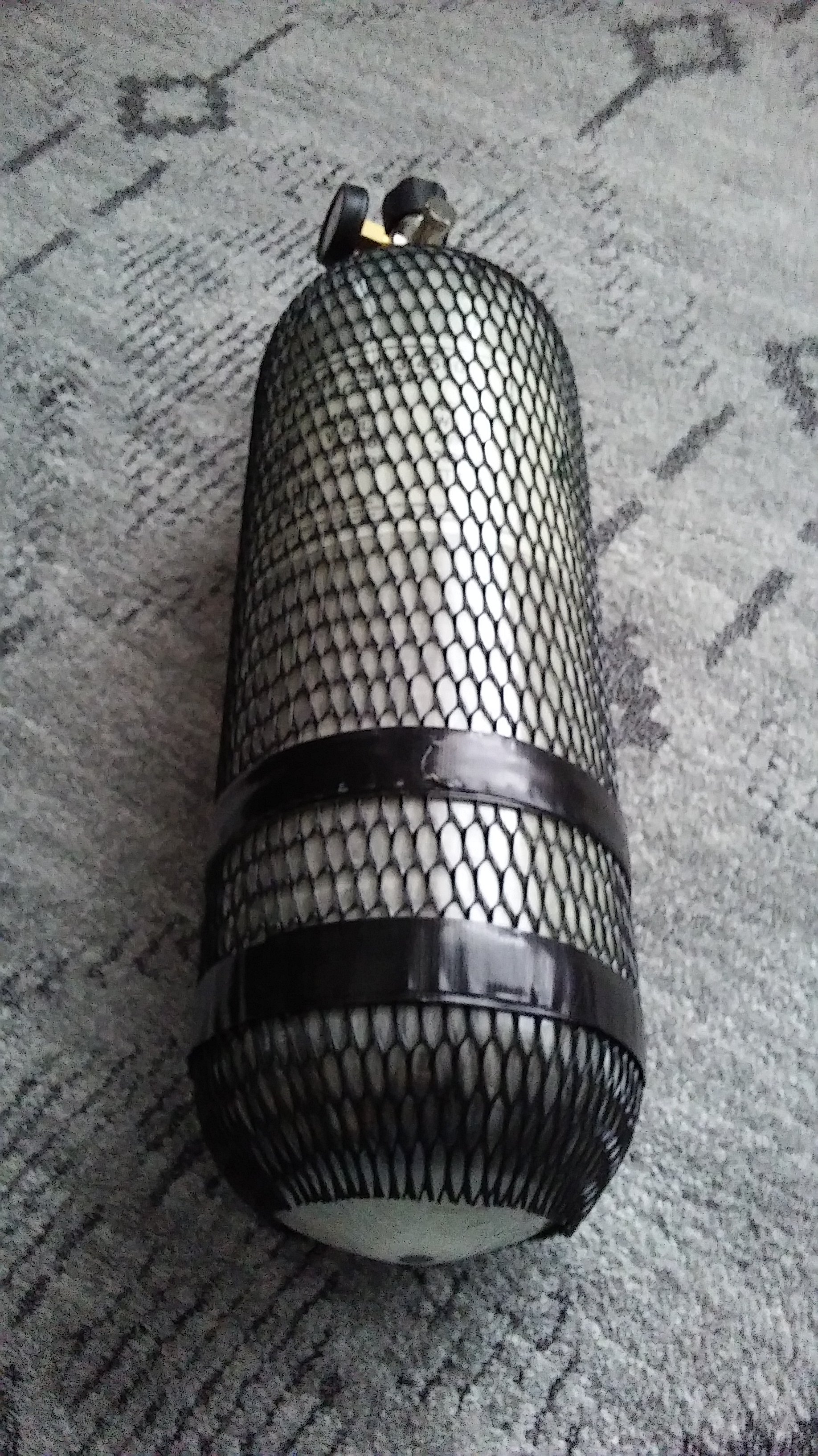

Erdb I got my stuff off of Amazon (cheapish that I could find) also not to much too chose from on the web. You could go to airtanks4sale but will pay thru your nose. Look at GA_LEADHEAD's post above my last post as I do not know how to post links. I got the same mesh, came in black and slides over easy (check my pictures). The tank boot was the Faber but you will need (6.7"-6.9") size. The 5" will be too small and the 7-7.24 will be way to large. As a matter of fact the 6.7-6.9 is a little to large but this is what I did to make a good fit.

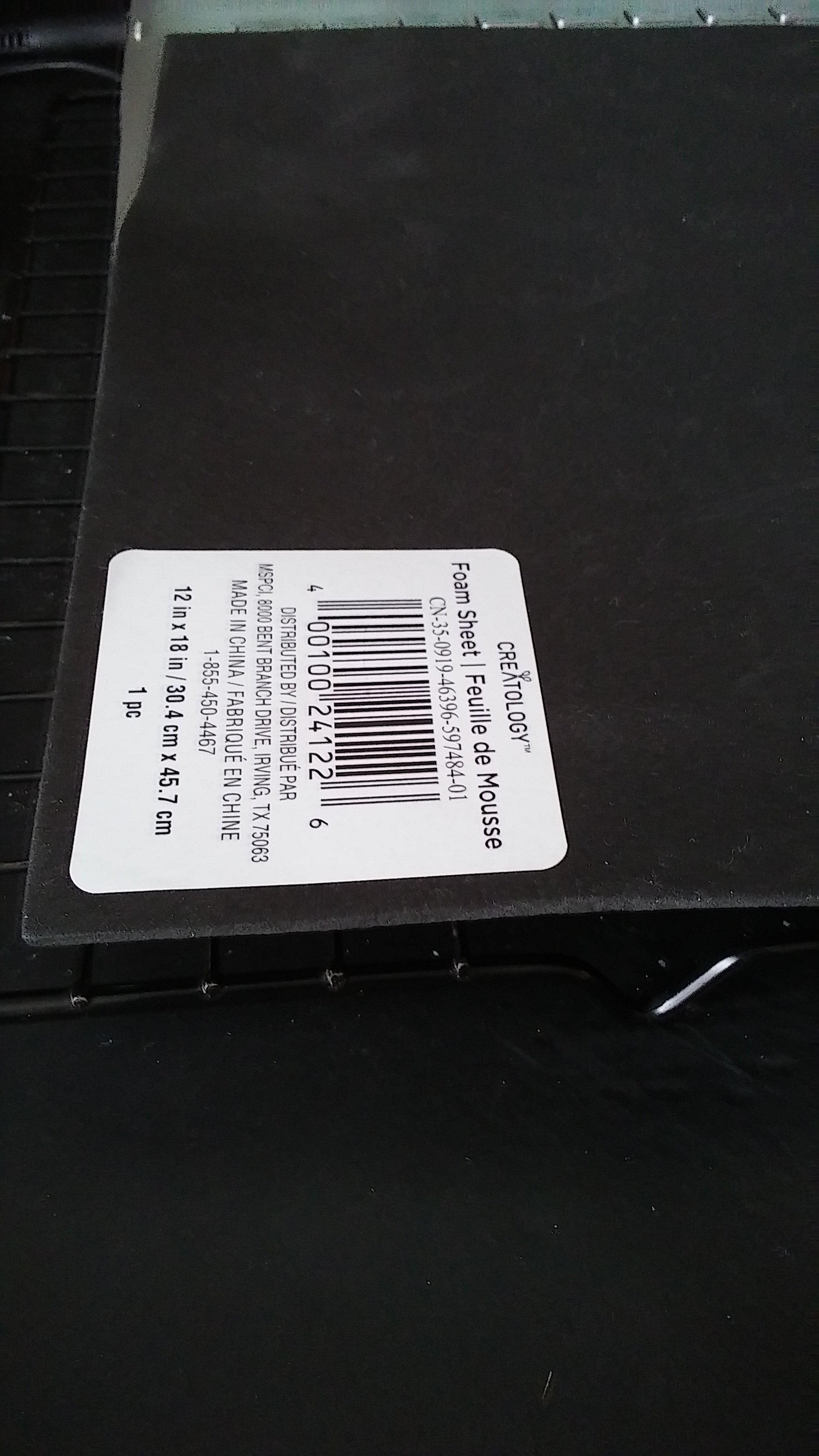

I put 1 wrap of close foam (from hobby lobby) it's about 3/32" thick around the bottle mesh, think I could of went with two
the bottom line of tape is to hold the mesh tight onto the bottle, next one above to make the boot fit tight, it took a few wraps of 1" wide gorilla tape to accomplish it.
then the top mesh at the neck I used a tie wrap too the neck of the bottle

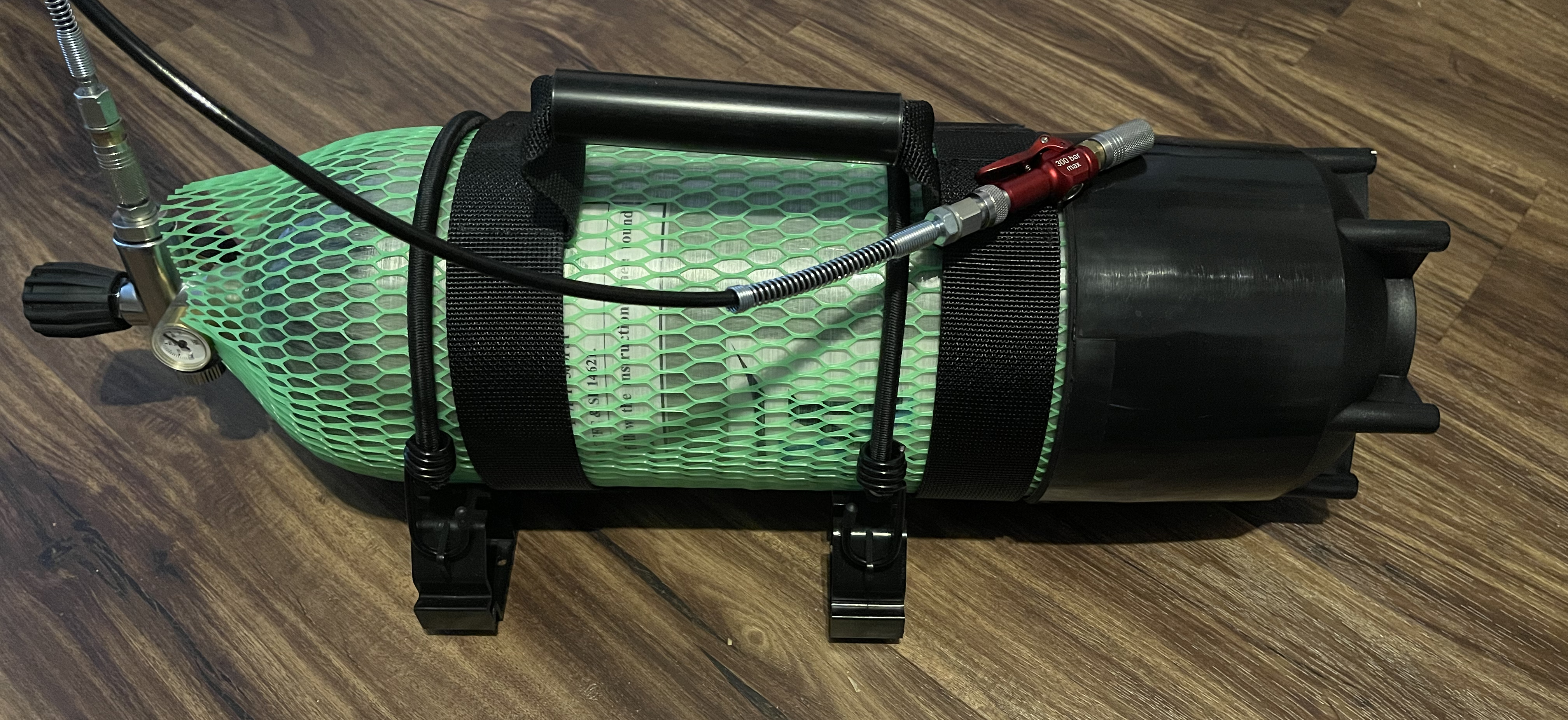

final results of the boot:
Hope this helps, I don't remember what the tank measured, some where around 6 3/8" to 6 5/8" but the 6.7-6.9" will work just fine. Sorry I did not follow up with this post just forgot. Good luck
