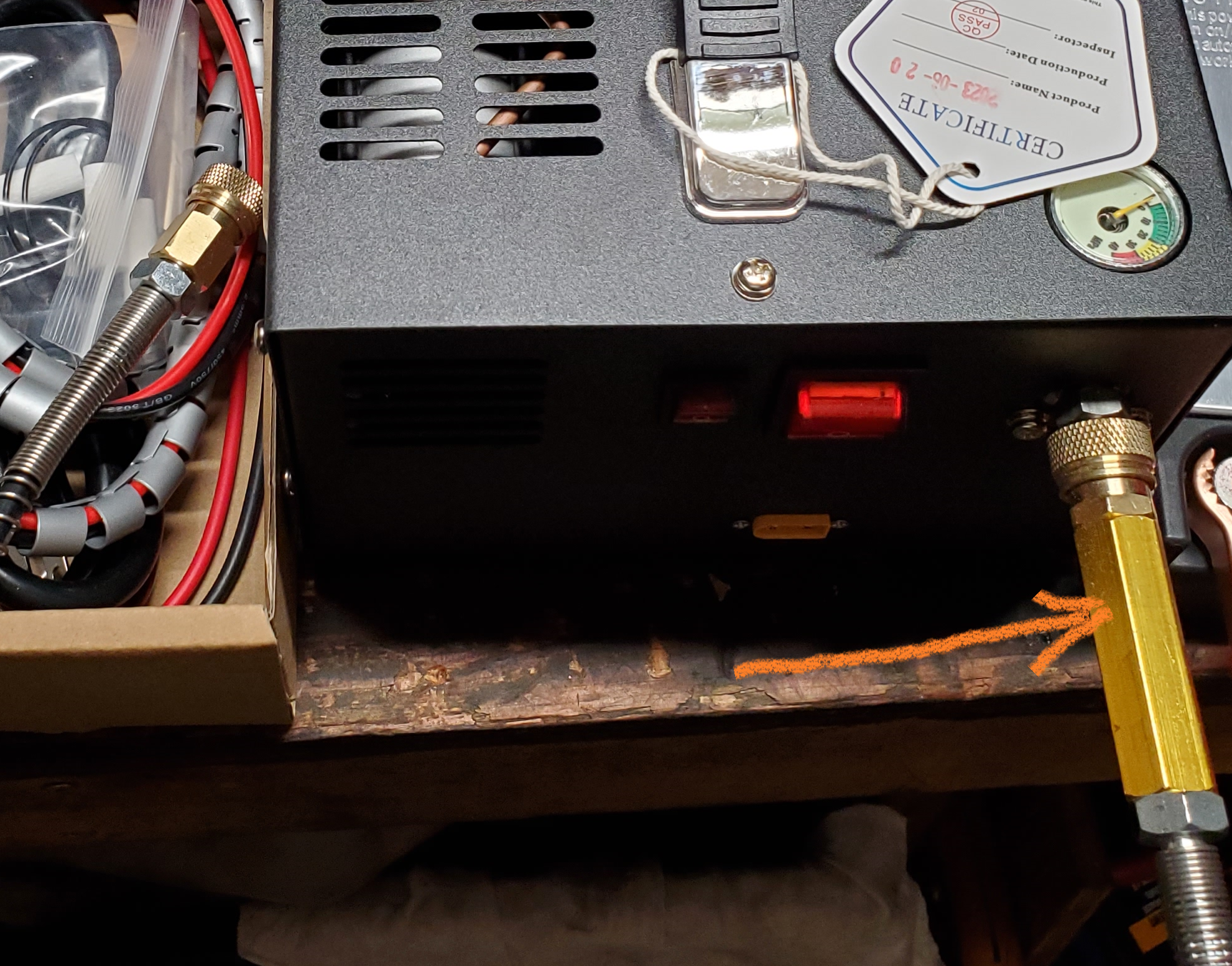

Are you using a real "Shoebox?" I put one of those $20. 00 filters on the out put of my Shoebox for the same reasons. The pistons are lubed and some of that will get into the airstream. I checked the filter element every few weeks and changed it as needed.
That same filter is now on the output fitting of my CS4-i - for the same purpose and still doing a good job.

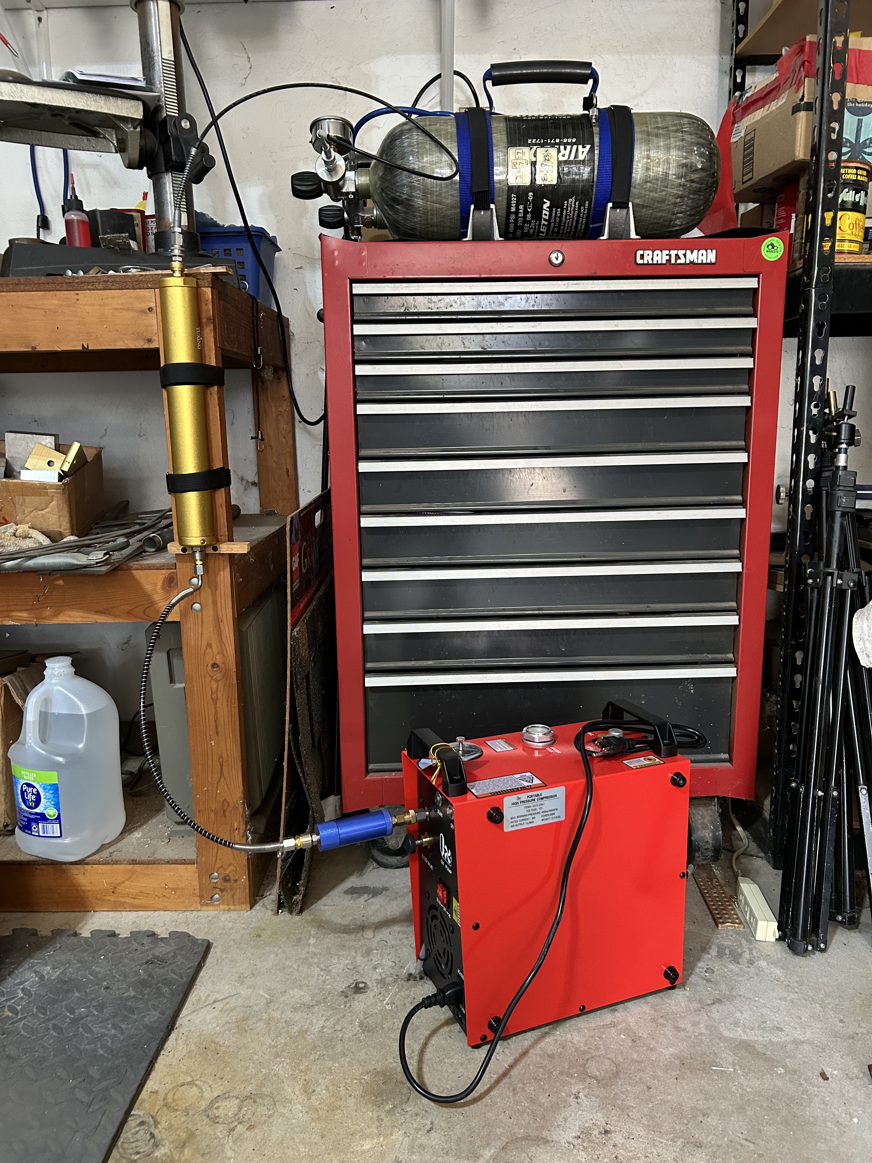

I do that very thing with mine, and I decided to do it with the absolute smallest filter I could find - since all it is doing is stopping the small amount of lube that gets through, I don't need anything bigger.
I bought it probably about 9 years ago, and while I don't see the exact unit anywhere anymore (all seem to have gotten bigger), this one is close - the filter housing is the same, but it comes with a hose attached. If I did not have mine, this is what I would buy, and if the hose is not microbore I'd simply swap it for a foster fitting. It won't waste much air with its very small size.
If you are drying air on the input to the Shoebox, this is all you need size-wise . . . .
Edit: Adding that I just noticed that you will also need to add a male foster fitting to this unit (M10x1), and I took this post as a reminder to check the filter in mine as I only do that rarely anymore now that the Shoebox has the auto oiler - the silicone oil is less of an issue in terms of the amount of bypass than the old white lithium grease was (plus I lube with Krytox instead of plain silicone oil). There was a light amount of lube in the filter after maybe up to 100 hours of use - I did not note when I last changed it - with no discoloration from any wear of the o-rings (most likely showing the great benefit of the Krytox lube - expensive, but awesome stuff in the right application). The filter was not blocked and would still have been good, but taking it out damaged it so it was replaced - for only the third or fourth time in the many years I have used it.

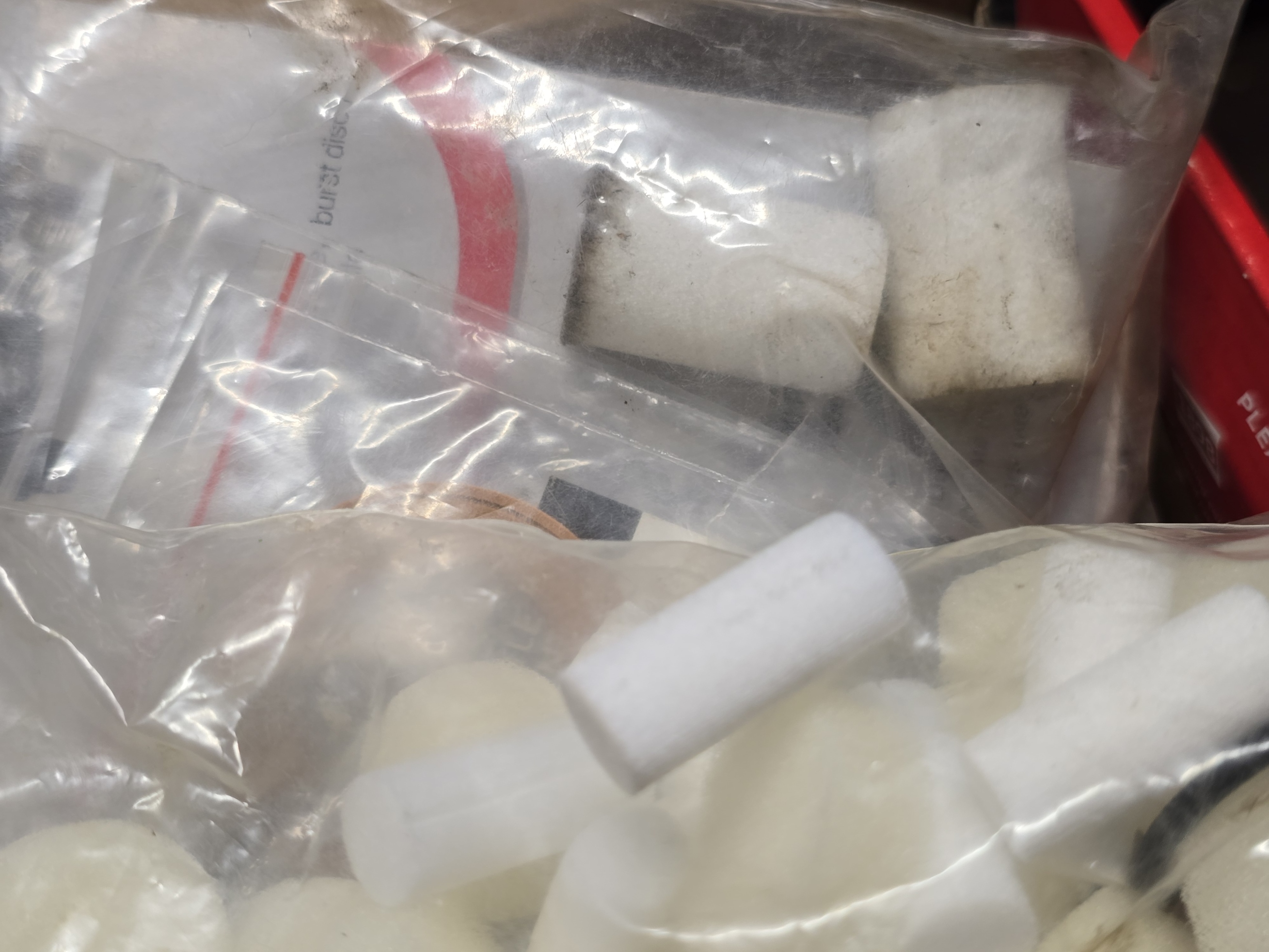

Opened it up after a years use. Trimmed off about .125" of the filter and put it back in. That was the only "contaminated" part of it...

Are you referencing this kind of little filter? Or

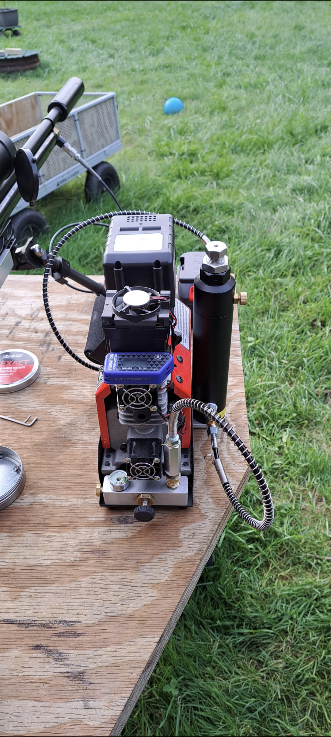

This one is on my Nuoge (GX CS1 clone). They use the little "cigarette filter" 10.5 diameter. Yhe larger one in the background is from my CS3, and shows the kind of dirt that I think BSJ referenced.
These filters stop liquid water quite well. I used larger versions to stop liquid water in the output of my Yong Hengs, including weighing before and after to calculate water.

MY CS4-i does expel grease - not a lot, but enough to justify the small filter installed on the output.
