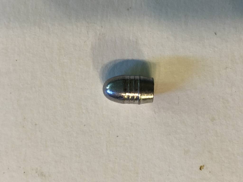

I LOVE my talon P. Put an oil filter on the end and it is nice and quiet. Cast my own 47 grain boat tails (MP mold)Ā and shoot those. A bit heavy but very accurate at all power levels. This was the only .25 mold I could find, turnsĀ out to be excellent.Ā
Accuracy seems as good or better than jsb and perhaps because of the mass or maybe the lack of a skirt, I don't really get flyers with the mp molds slugs.Ā
BC is 1.5 I read somewhere.
The other day I was shooting these even with the gun tuned way down - don't usually do this but trying to avoid buying more pellets. they were only flying in the high 500's/ low 600'sĀ butĀ still hitting dead-on in my 10m garage range.Ā
For some reason I thought that you would need to be shooting a Diablo pallet at slow speeds like this, That a solid bullet without a skirt would not be spinning fast enough to be stable.
I might've already said this here, I forget, But these were specifically designed / testedĀ to work in LW choked barrels so maybe it's not a surprise
