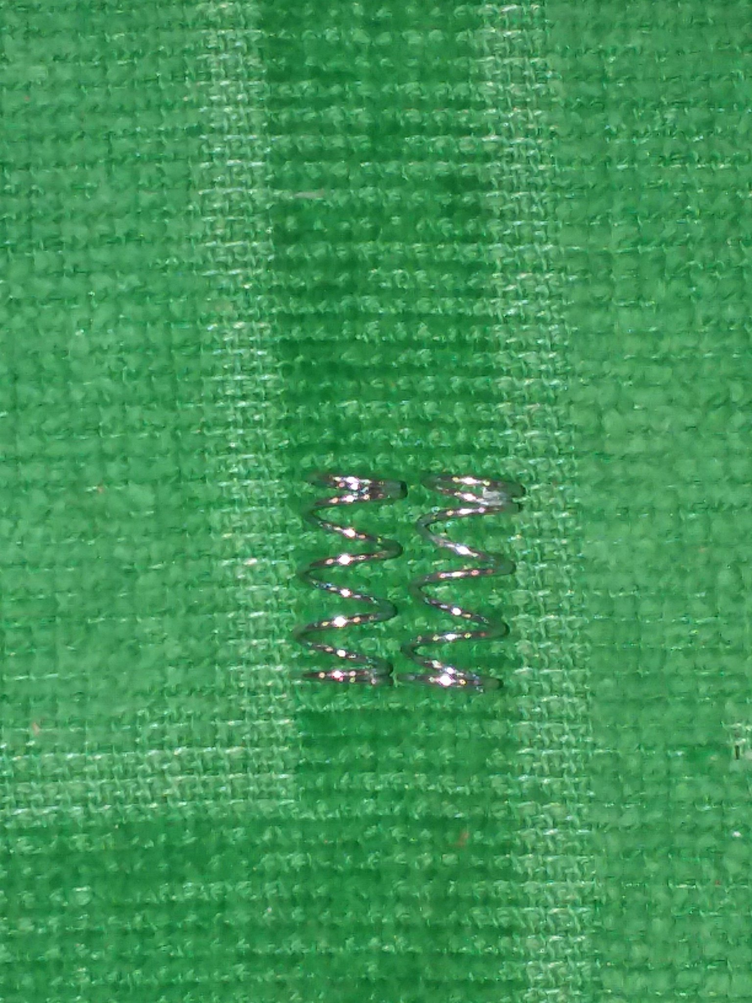

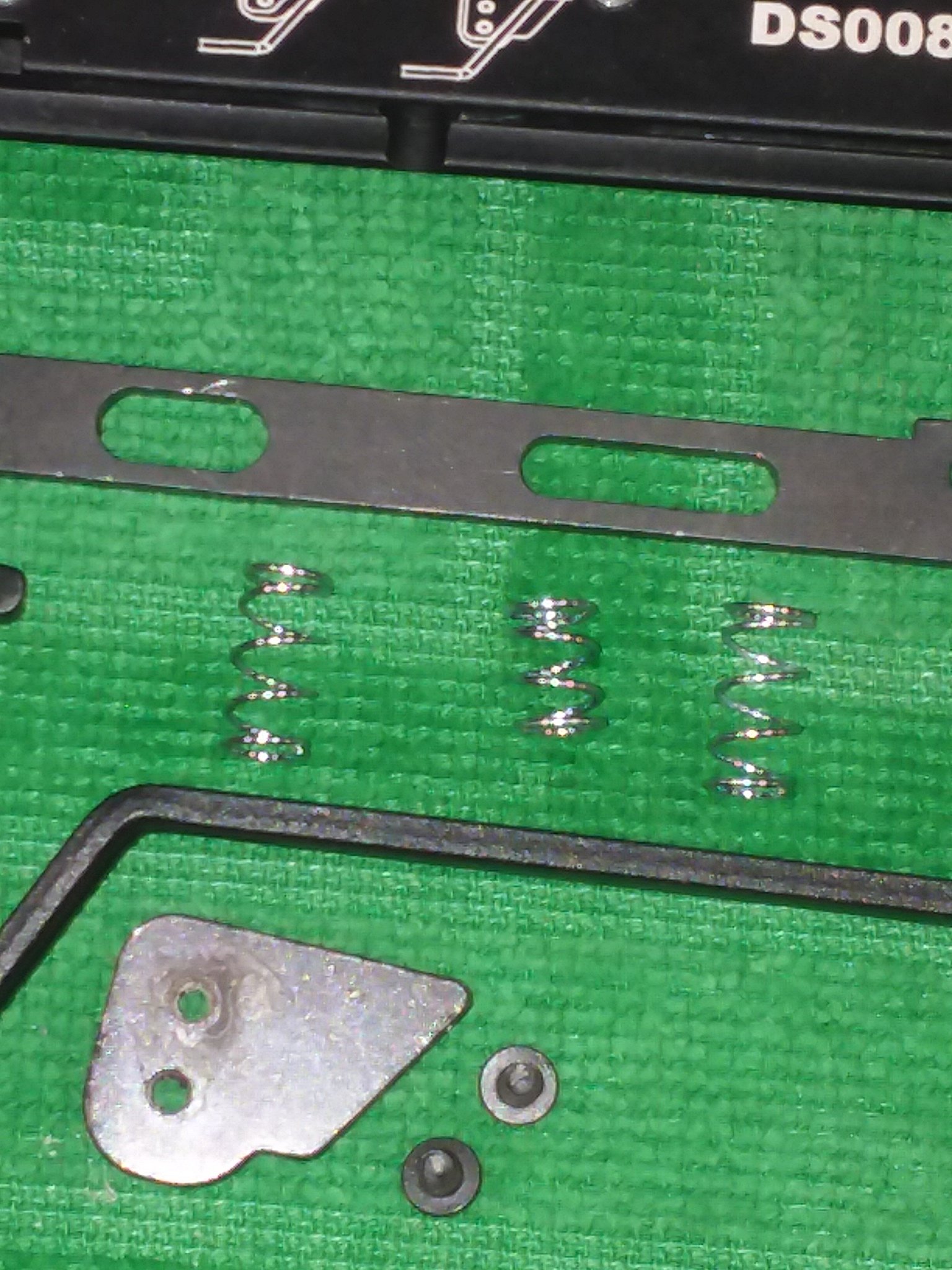

I am not sending this rifle back to Airforce (twice burned....). I ordered a Talon Tunes Trigger Spring and waiting for Rocky Mountain Precision to get a supply of Ball Bearing Triggers. The gun is apart on my work bench, The trigger spring and the other long spring look identical ??? Anyone know about this ?
I ended up getting a Talon Tunes trigger spring and installing it. First test firing of trigger much, much better however the safety started acting up again. Having called Airforce about this in the past I played with the front and rear grip screw tension, all working now but the lifetime warranty is now void. I have learned so much by watching YouTube, Now I can fix alot of things on my own. I will say that everyone I talked to at Airforce was friendly and helpful, It's the repair department that is lacking. I think they installed the wrong spring for the trigger.
