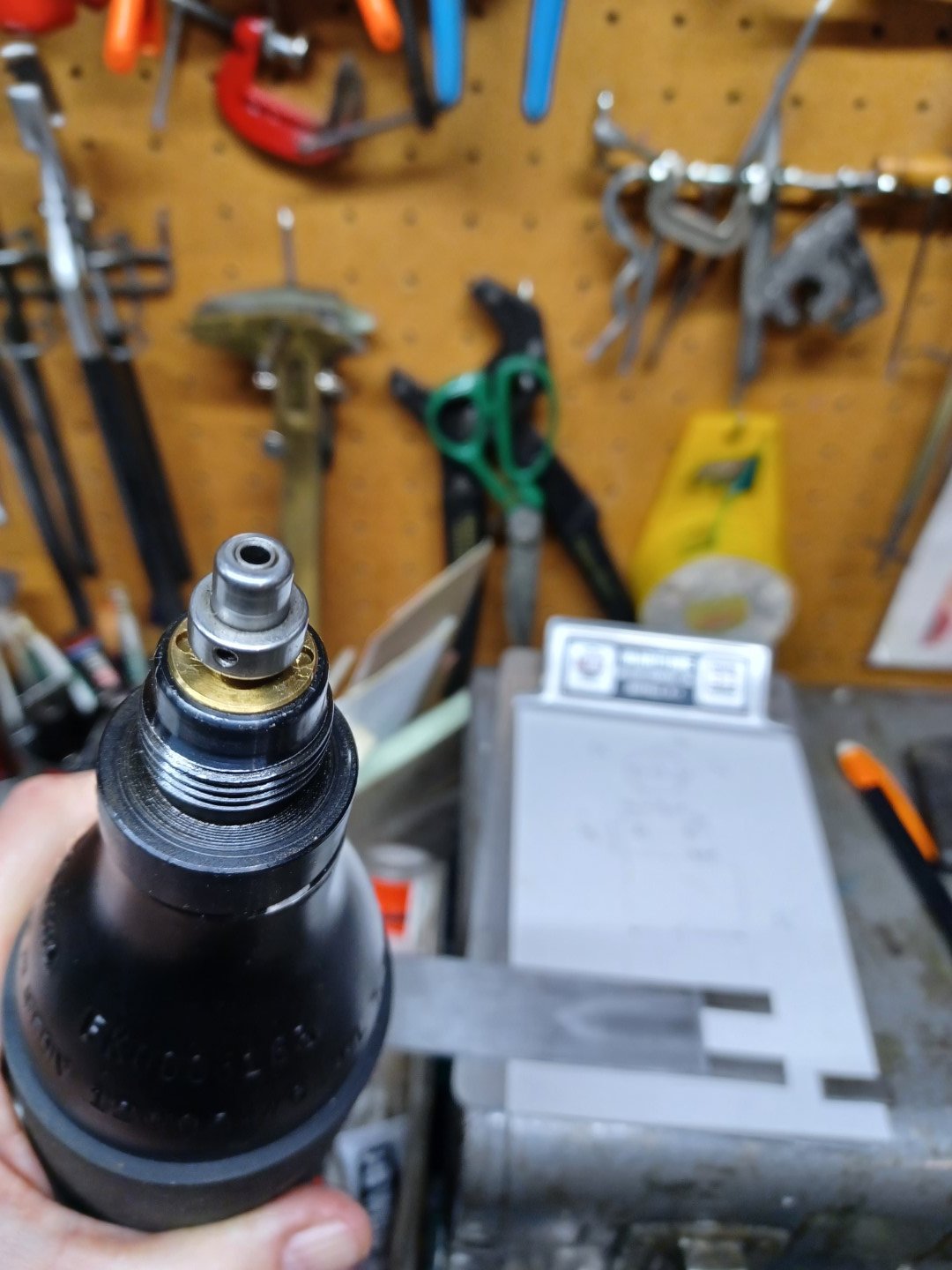

Valve before removal

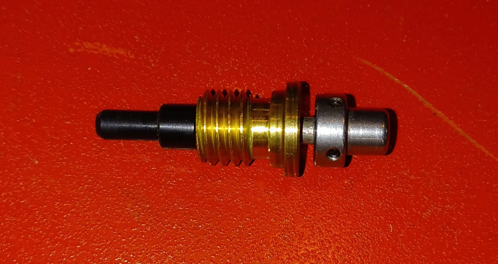

Valve core removed

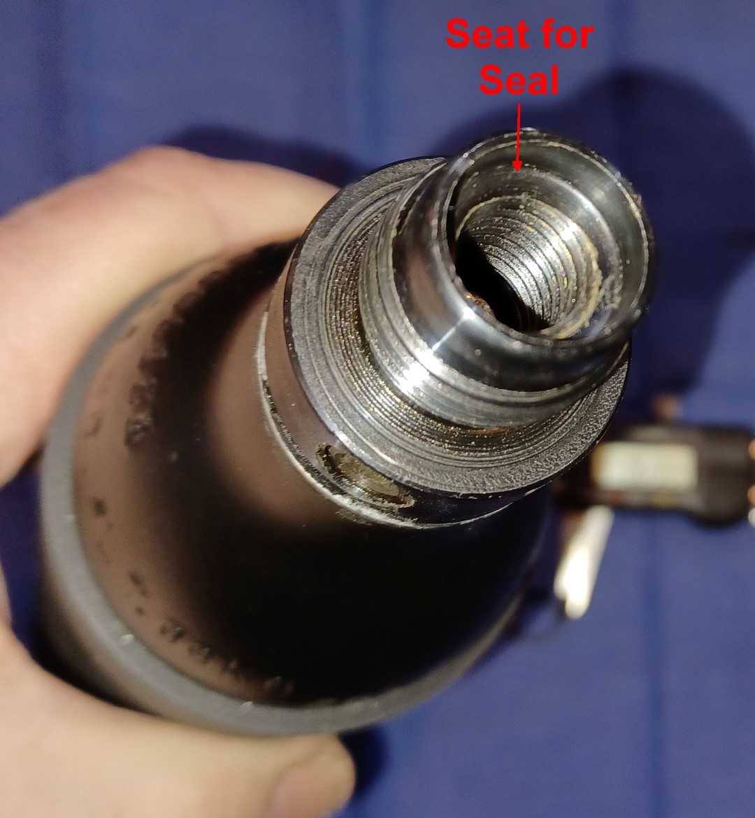

View of the seat where the core sits. I don't see the seal for this part and nobody's been inside the valve and removed anything. This is what it looks like when I opened it to see if I could spot the problem. Technically I could have sent it back to AirForce, but now having opened it they would probably consider that as having voided the warranty although I don't know if seals were covered under that.

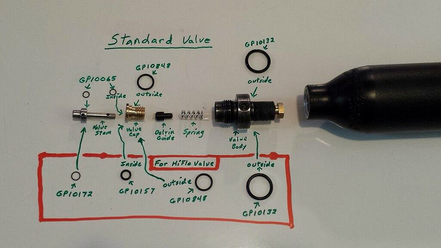

Here's a diagram showing the seals and apparently the official part numbers - I don't know if they're AirForce part numbers or another vendor's.
I just got off the phone with AirForce and ordered two seals. They have updated their SKU numbers and the numbers above were AirForce numbers.
The seal for the brass valve core, formerly GP10848 is now ANC 000848 and is 95 cents
The seal for the valve body to the bottle, formerly GP 10132 is now ANC 000132 and is also 95 cents.
Shipping was $4.00 and will come in an envelope. He wasn't sure of the material for those two seals, but he said that they're not something that normally could be sourced at a local hardware store.

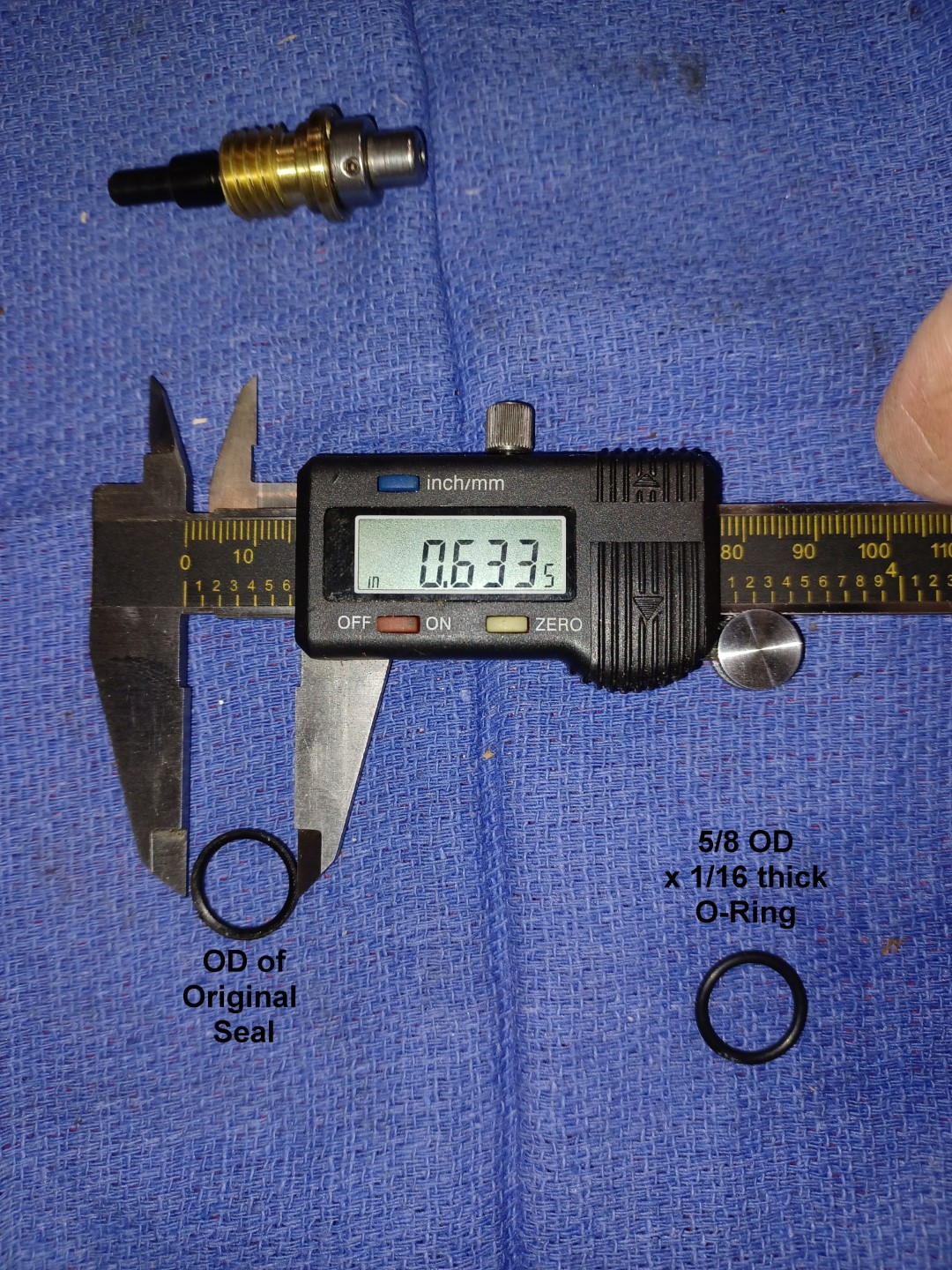

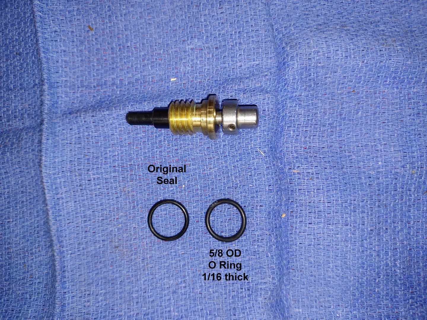

Out of curiosity I went to the hardware store and bought an O ring. It's 5/8" outside diameter and 1/16" thick. 1/2" inside diameter.
I only had enough ambition to pump the 500 ml bottle to 100 bar. I checked it and so far no leaks.
The O ring is not as thick as the original seal nor is it as stiff. The seal is square or squarish in cross section. The nominal dimensions of the original seal are 16mm OD and 2 mm thickness. My gut tells me the O ring won't last as long as a seal, but O rings can be obtained locally for 63 cents. AirForce's price of 95 cents for an OEM seal is pretty comparable and reasonable.
