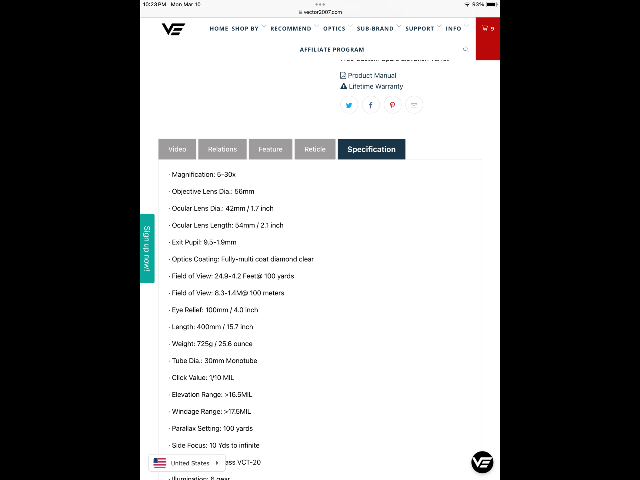

I don't think this issue is terribly unique, unfortunately. I sometimes test at 5 yard intervals from 10 to 35 yards. I want to check on what I get from chairgun. My Arken EPL4 6-24 will not focus at 10 yards nor will my Vector Veyron 6-24. My Athlon scopes will. I think any of them will focus at 13 yards, however. Trusting my memory is iffy but I think they were OK by 12 yards. Not focusing at 13 is pretty far off.
I haven't tried my Arken 4-16x50, but my vector 10x44 sfp focuses down to 10yds and my BSA sweet 17 3-12x42 focuses to 7yds
Jace I’ve got the Arken EPL4 4-16 and it does go down to 10 yards. I would have bought another Arken but the rest in this price range and higher are all more minimum focus.
Reactions: JaceSpace1369
Where did you read " focus down to 10 yards" in that exact scope specification list OR the general Advertisement of that LINE of scope statement ?

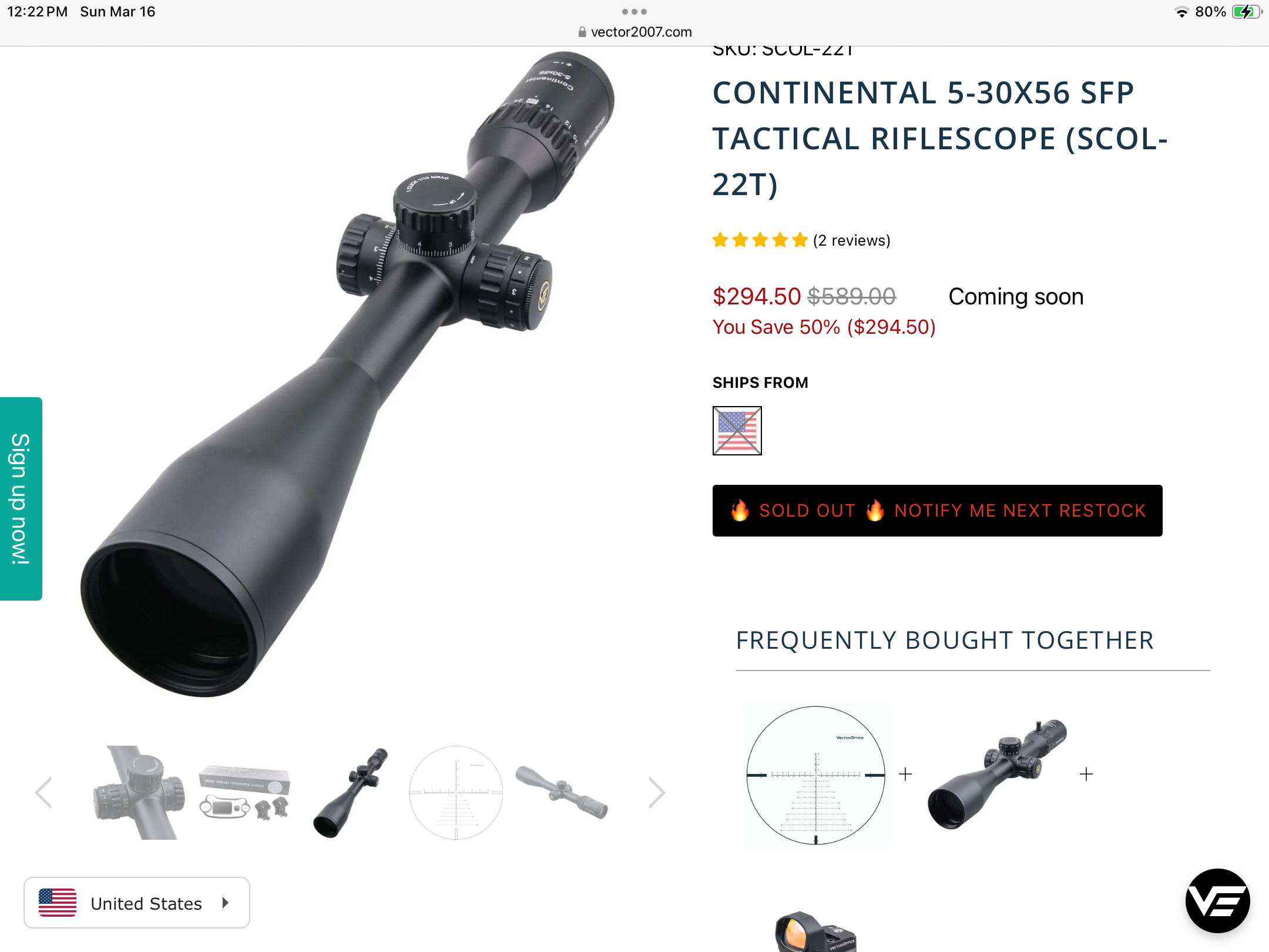

I just had to look at the topic of this… O s-it it was mine and on Vector scopes. Sorry, this must be my longest post and I
cant write it over. Nobody to tell it to so Thanks.
