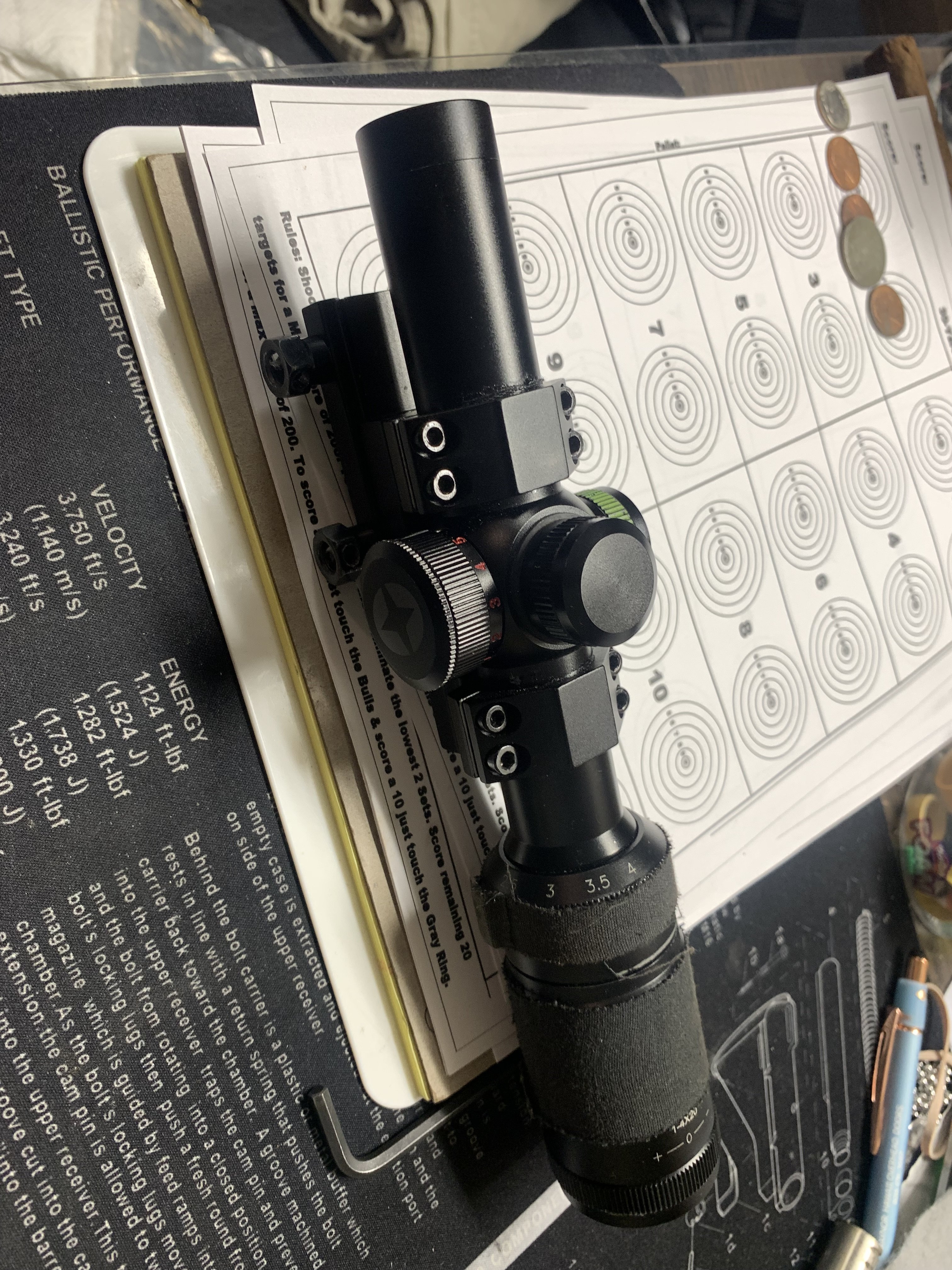

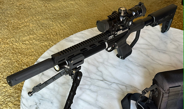

The issue about rings is "how high". I like a low scope but I think you have to be high enough to clear the magazine on a Notos. If you have "free" rings that came with other guns or scopes I would try them to at least get a better idea what height you need. If you do not have any, you might want to order rings in several heights from Amazon and return the ones that do not work. I do not buy expensive rings, the "cheap" ones work fine for me. They are lined with a plastic tape so the minor lack of alignment that is typical for inexpensive rings does not damage the scope because the plastic tape gives.
For a scope the least expensive I have good luck with is a Hawke Vantage. Mine is a 2-7 but for target work I would get at least the 3x9. Hawke is one of a few manufacturers known for good warranty performance if you happen to get a "bad one". Athlon is another as is Arken. I had a Bug Buster and when it broke UTG ran away and hid. They gave me a return number and then totally would not communicate. So no more UTGs for me. Athlon was totally responsive on one of their scope immediately sending me a new one. No questions asked.
