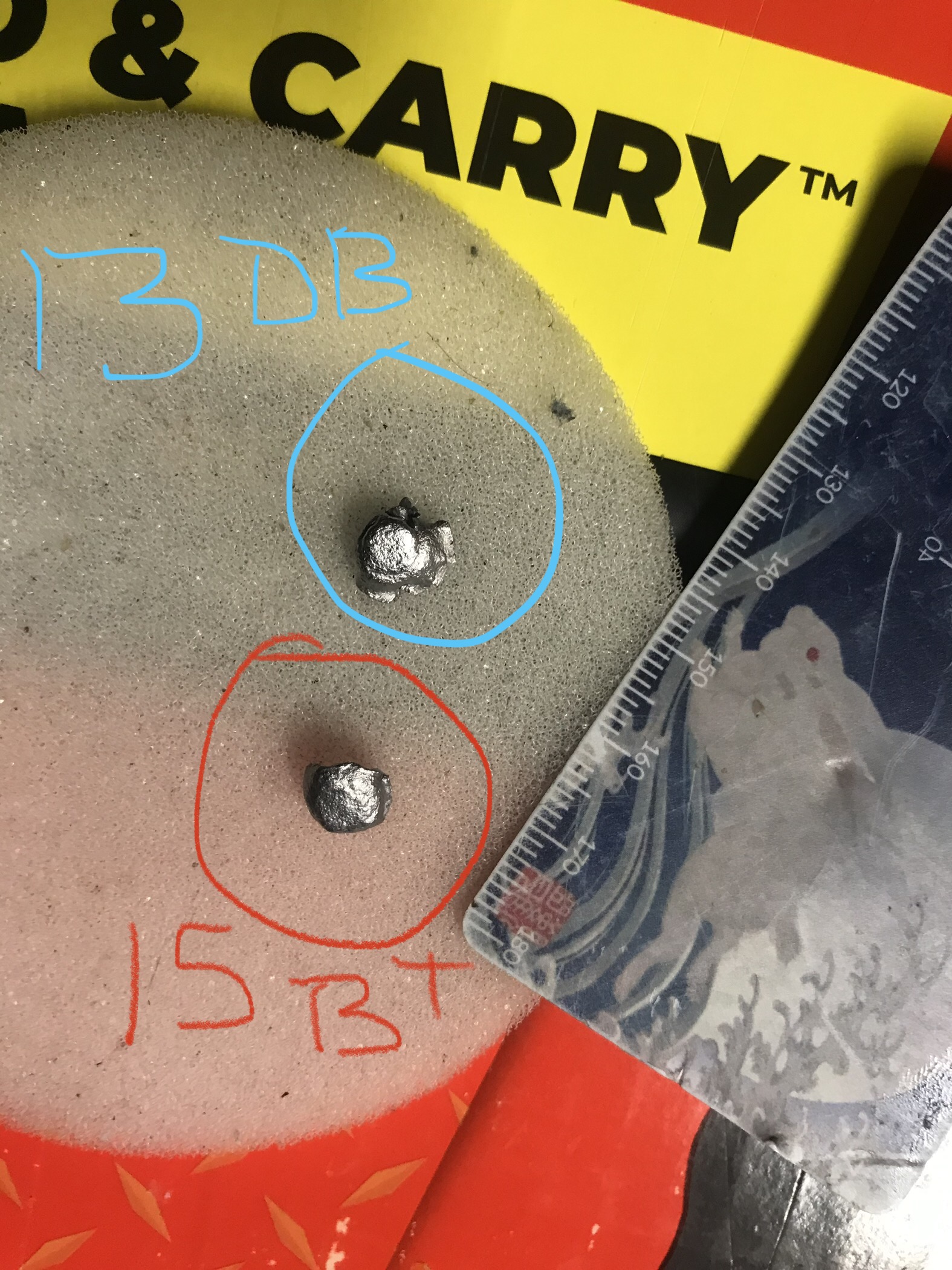

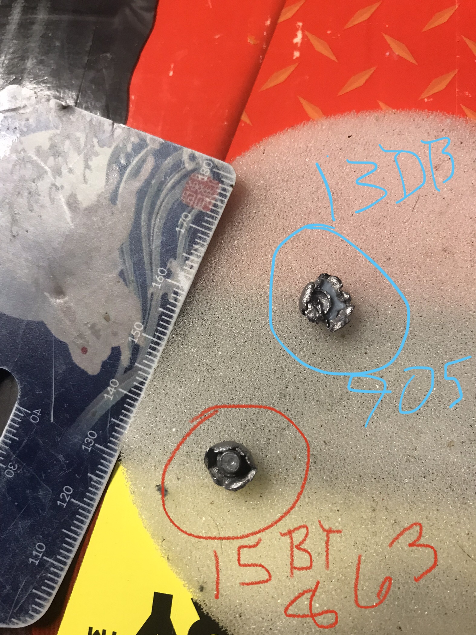

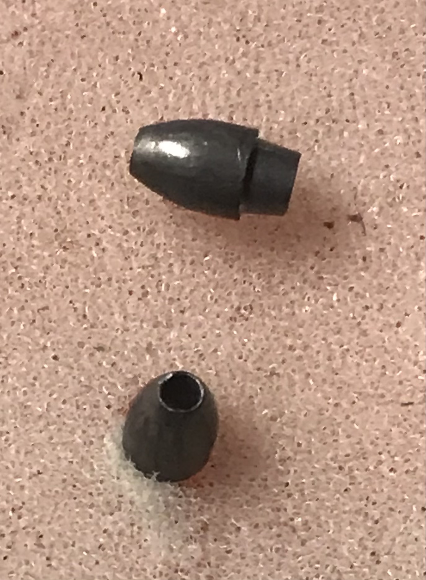

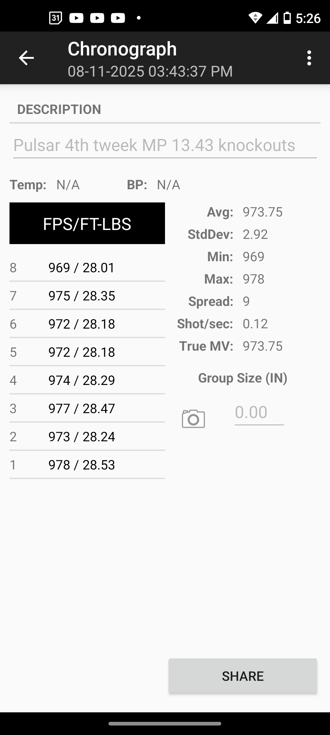

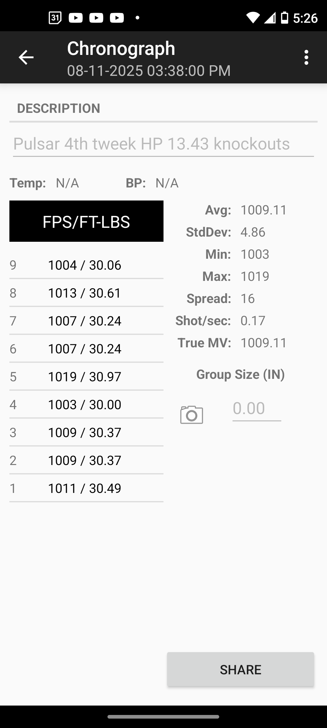

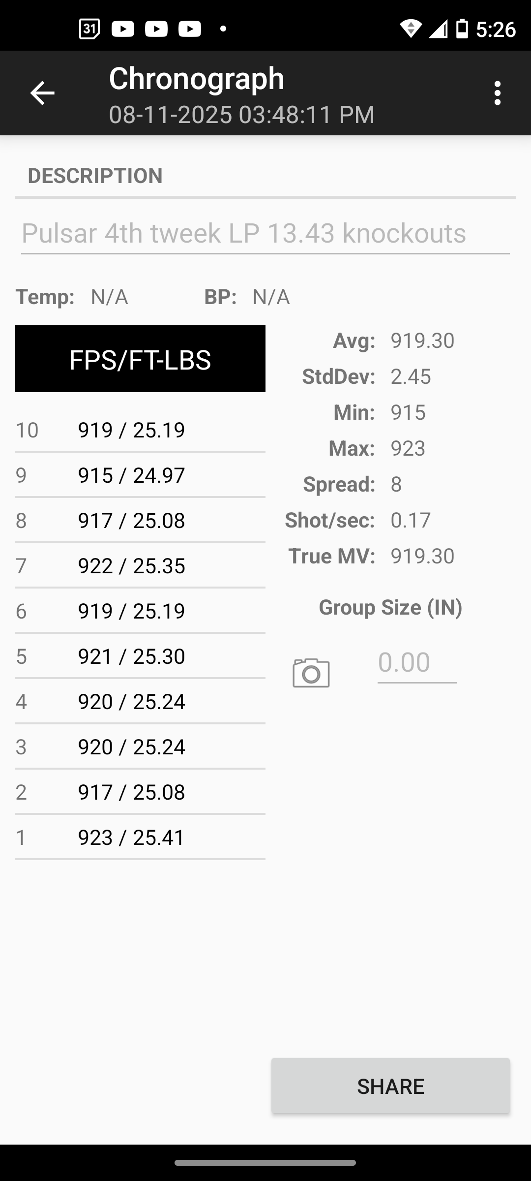

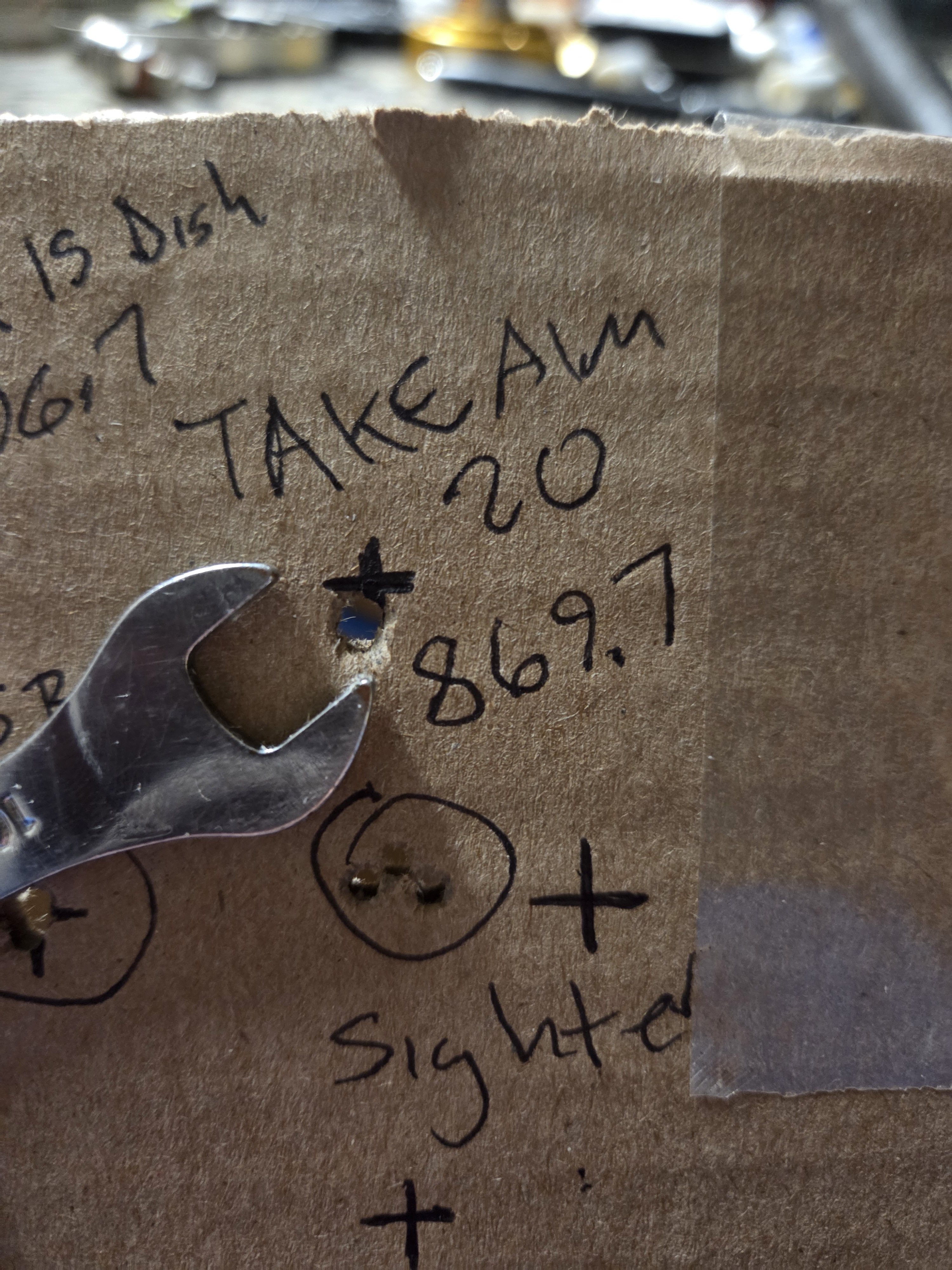

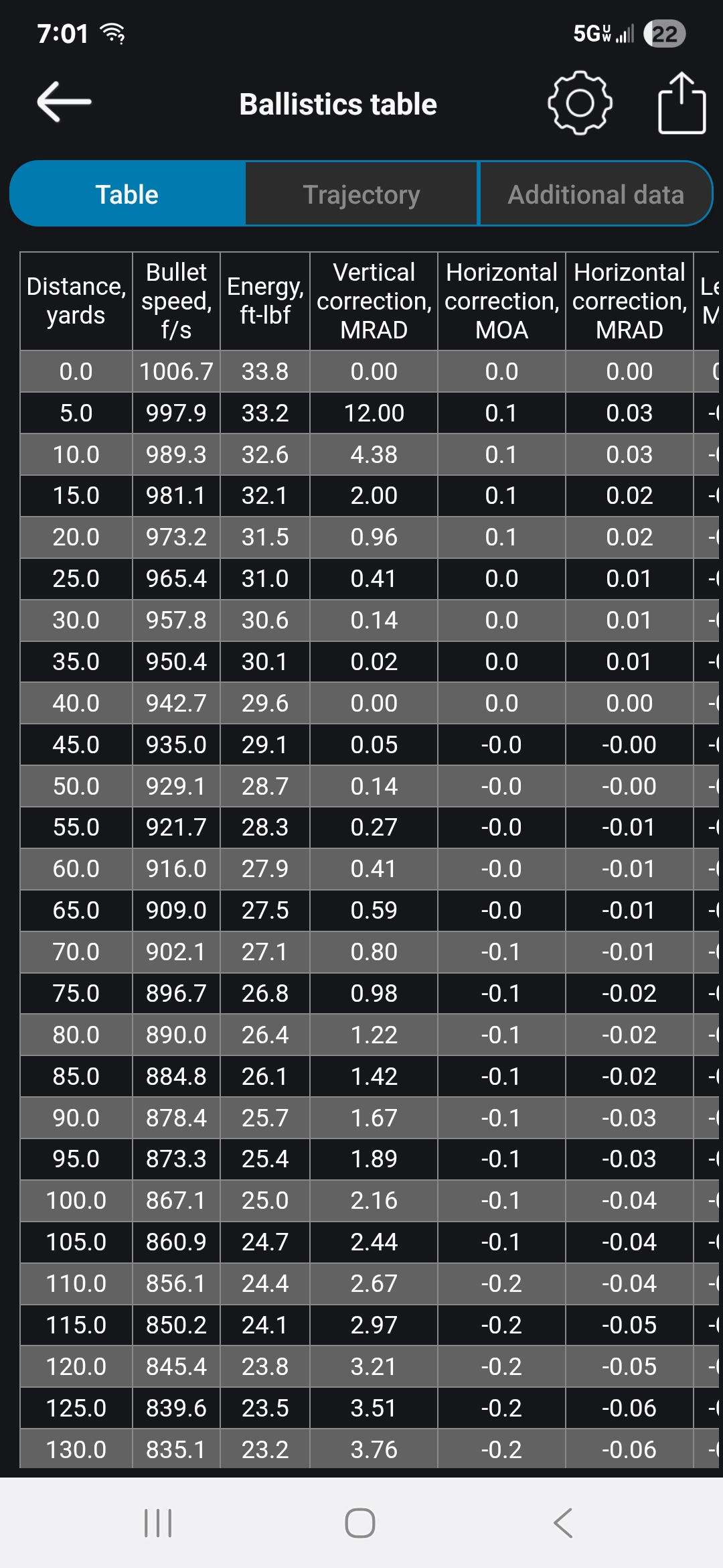

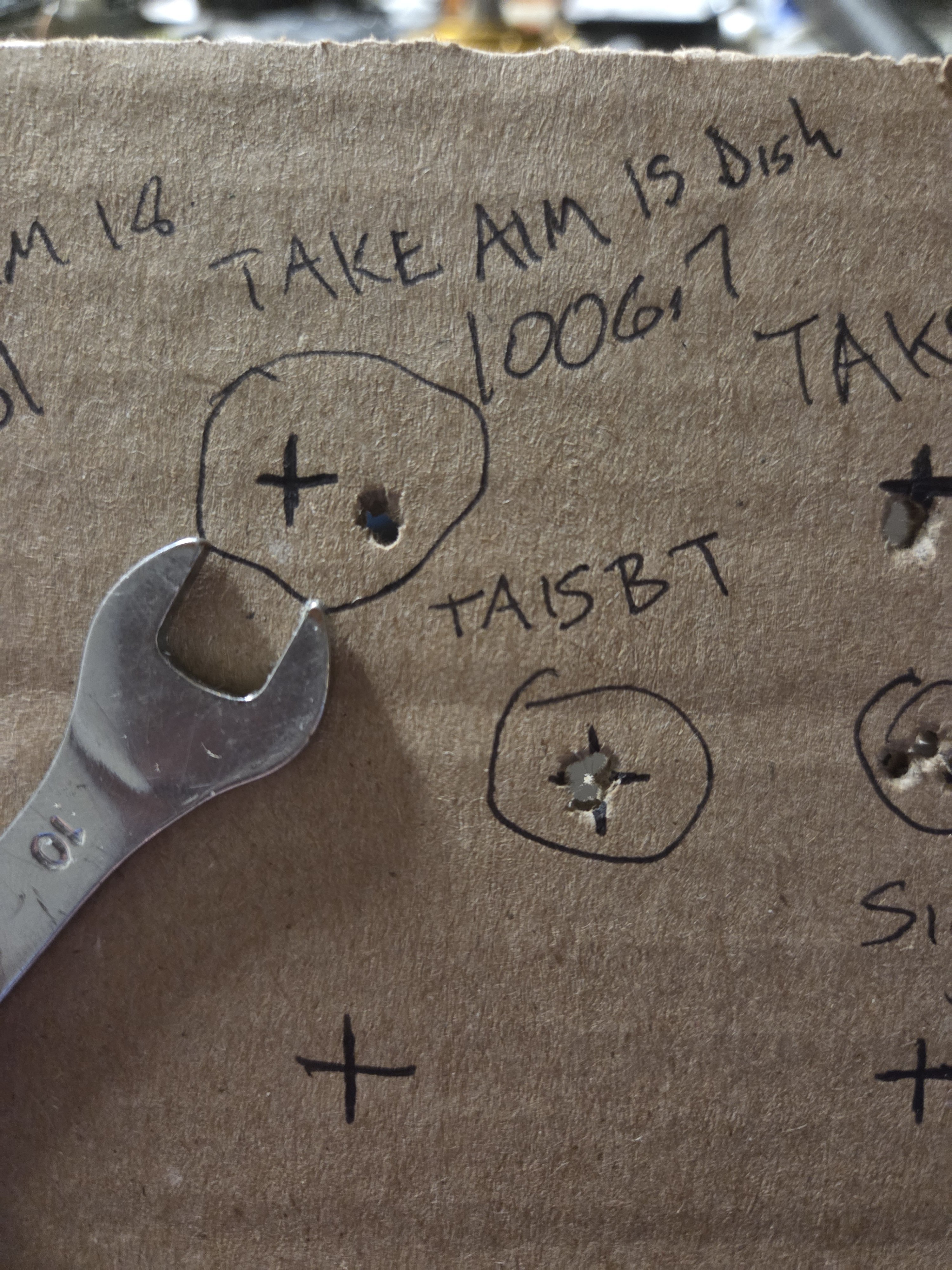

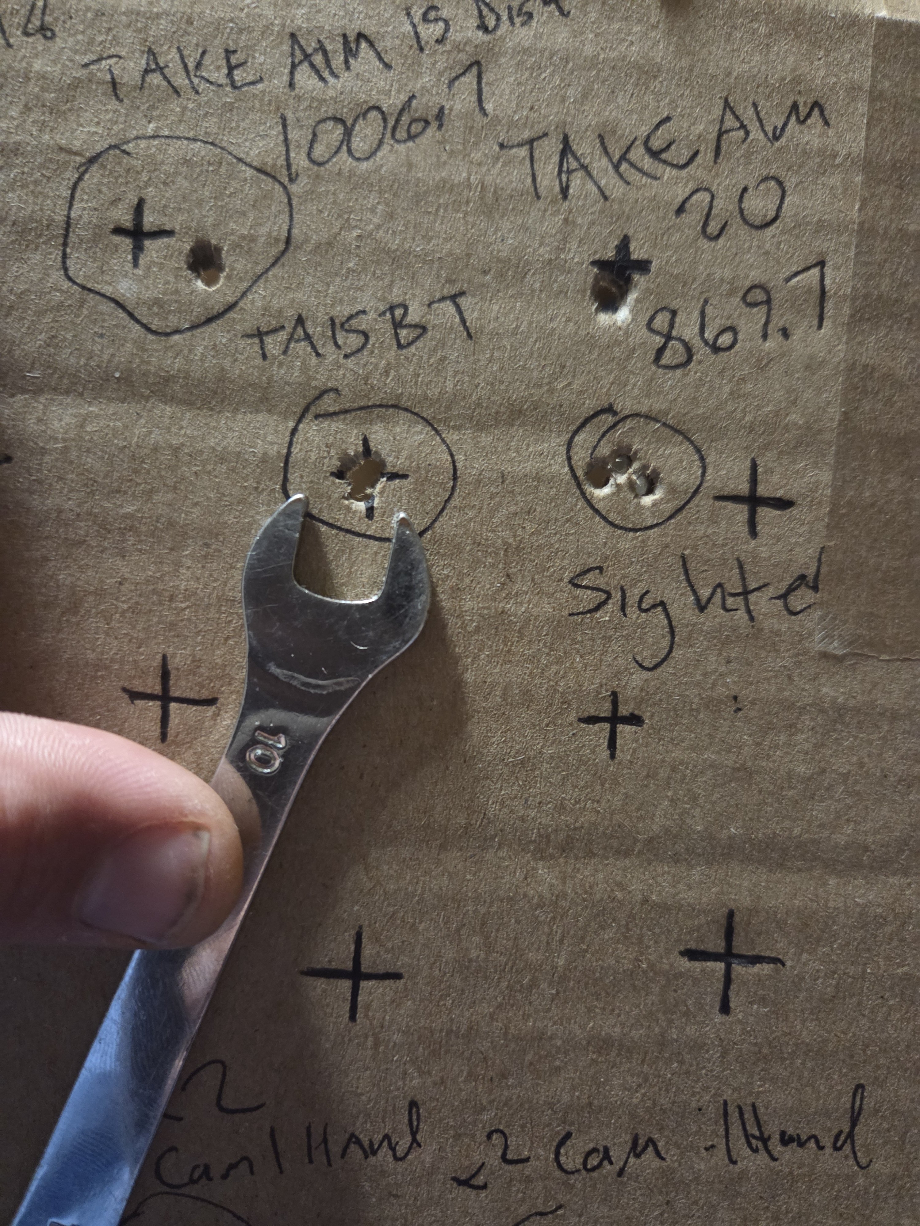

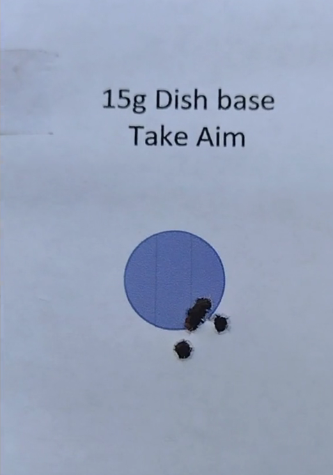

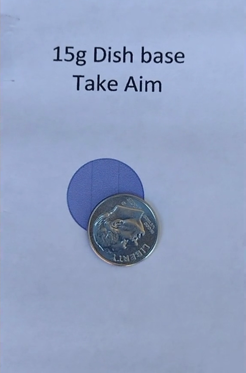

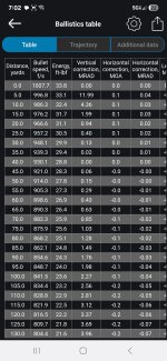

Ordered some 13&14grain .1775 dish base. The 15gr is already the “heavy” projectile of choice for my Katran L. Currently 125b. The 15s peak at 885 at this pressure, but I choose to utilize a little lower on the curve at 865. Getting a 6.7 extreme spread with a .7SD. recently the man behind the slugs contacted me and sent me some 15gr hollow point boat tails to try. The 15dish were reliable 1.1MOA slugs at 100. I’ve only shot these new boat-tails out to 35 since getting these in the mail today, here are my results.
Unless for some unexplained supernatural phenomenon cause these to start wobbling like a knuckling football, these are looking like they’ll be my primary Projectile overall, usurping the throne from the throne 10.03 ko mk3 at 986.
Anyone shooting the 1:17.7 unchoked cz 520 should definitely give these a try. He says they are just as good out of the 1:16Fx liner. The 1:18 heavy and superior. As well. TAKE AIM SLUGS on eBay.
